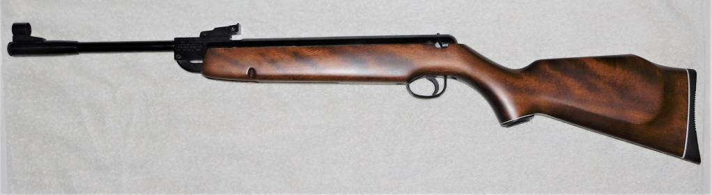

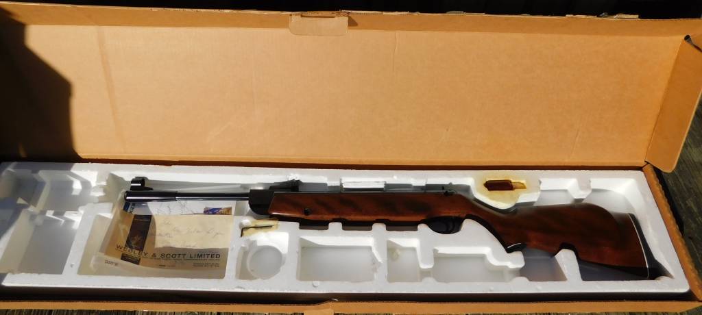

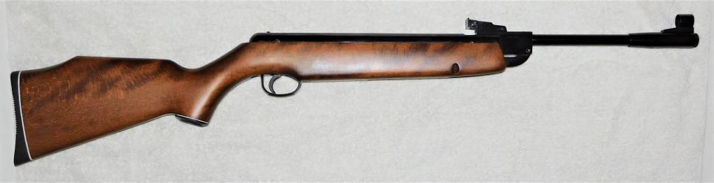

Just received a NOS Webley Vulcan MKIII aka Beeman Bearcub. I had a Bearcub years ago that I got for my son when he was much younger but it was far too difficult for him to cock so I got rid of it. This one came up and I thought I'd replace one of the very few rifles I have even gotten rid of. Really tiny and pretty potent carbine rated @915fps and just 37.8'' which is less than an inch longer than the diminutive R7/HW30 but packing over 200fps more velocity. It came with the original box, allen key & oil as well as a letter from Webley to Beeman stating..."new Vulcan for your inspection". The seller used to work for Beeman years ago so I am guessing this may well be the 1st Vulcan MKIII in the US?! It was also mentioned in the letter that it has a spring in it that might not be used for final issue/production. I ran it over my chrony and found it was cranking out Silver Bear pellets over 960fps! The trigger on the Vulcan/Bearcub's I have owned have both been pretty awful but I decided to try a little polishing on this one and it made a substantial difference. It has a very odd trigger adjustment that sits on top of and to the rear most portion of the compression tube area and has a manual safety. I had a Bugbuster 3-9x on the last one and might put a Leapers 4-16x compact on this one some day (maybe not).

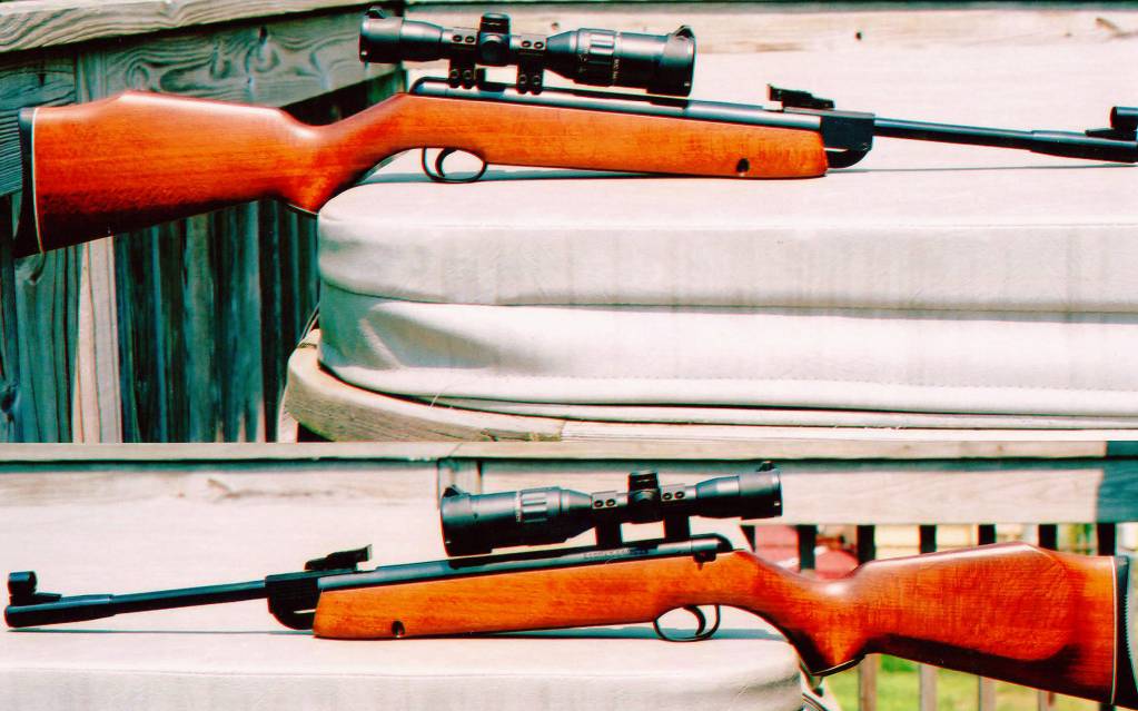

Yeah the Vulcan platform is a good one. Some have been critical of the hinge. The mark 3 also has a hinge in the trigger like a Stingray does. They work ok if you like a fake two stage. British makers did that a lot. Webley, BSA. The trigger adjustment is spring pressure and gets unsafe if reduced too much. Polishing the sear and a little moly helps for sure. I got a mint Beeman Vulcan II .177 last spring from a gentleman and he threw in a very nice Mossberg shotgun! The shotgun is worth more than I paid for the Vulcan (not too much). Has the Webley "spring tamer" guide. They work. Bearcub almost certainly has it. I wish I could find a walnut deluxe stock for it. Webley usually used very nice walnut. My beech stock is rather bland. Not the level of polished blue we see on many British guns. The gun handles fairly well.
Sounds like the Bearcub might benefit from a standard Vulcan spring. Might not be good for it's relevance as a Beeman collectable though. Nice little rifle for your collection.
