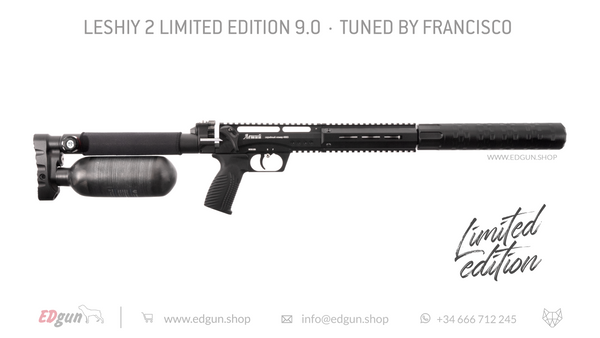

.22x480 AP barrel, 2x08 jets, 94 bar REPR, from a 240 fill to the Reg - 125 shots
Upvote 0
Is this a sub12 tune? What's the FPS?Old post but I have a new tune to the public.
.22x480 AP barrel, 2x08 jets, 94 bar REPR, from a 240 fill to the Reg - 125 shots![]()
It is not a sub tune. And this tune is more about a very efficient air sip and not chasing high speeds or fpe.Is this a sub12 tune? What's the FPS?
How did you install a reg in the rear?I have a leshiy 2 9mm that I set up for 25 cal.The set up is The set up is 350 cz barrel with a Donny fl shogun. .3 and .4 jets,120 bar on Huma reg.its at 880 fps 5 mags at full power with a 470 bottle.The 9 has a larger plenum ,don’t know if that makes a difference.I tried .3-.5&.4.-.5 and didn’t like the performance.with the current setup 1/2 mos at 50 yards so I don’t mind burning extra air for those results
The Wolfiek Group Limited Edition Leshiy 2 9mms have a custom plenum with a 1st generation Externally Adjustable Regulator (REPR).How did you install a reg in the rear?
Is it possible to buy just the plenum?The Wolfiek Group Limited Edition Leshiy 2 9mms have a custom plenum with a 1st generation Externally Adjustable Regulator (REPR).
