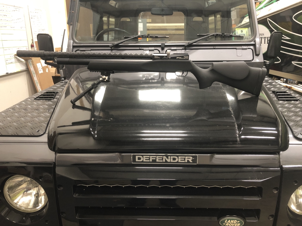

While I simply love my marauder, the kral platform is easier to work on.
While I can at this point, tear the marauder down with my eyes closed, lol.. there are a lot of pieces to assemble, and to get to the valve you have to take everything out.
Kral you just remove air cylinder from receiver and the valve is right there. They break down extremely easy, and there are plenty of diy very simple modifications that can be made with basic hand tools.
I would choose the kral over the marauder just based upon platform. 215cc cylinder in the mrod vs 330cc in the kral equals more shots out of the gate.
Threaded barrel so that you can just simply add moderator of choice which I have found to tighten up my kral's groups, though it could just be psychological with me, 😃

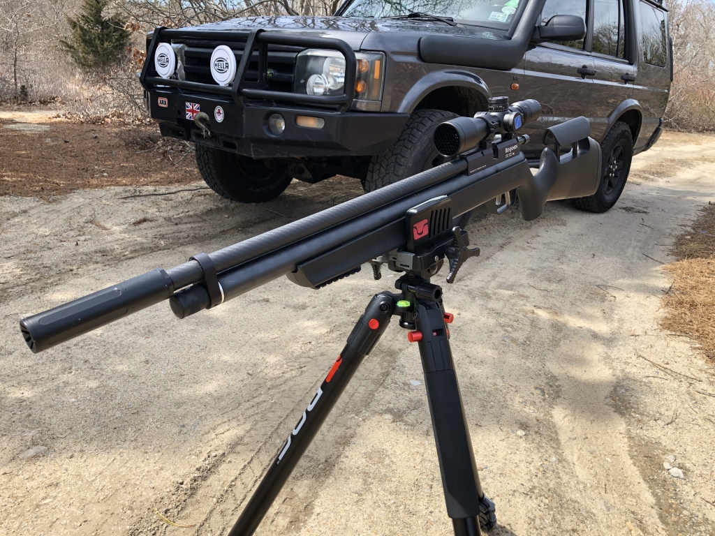

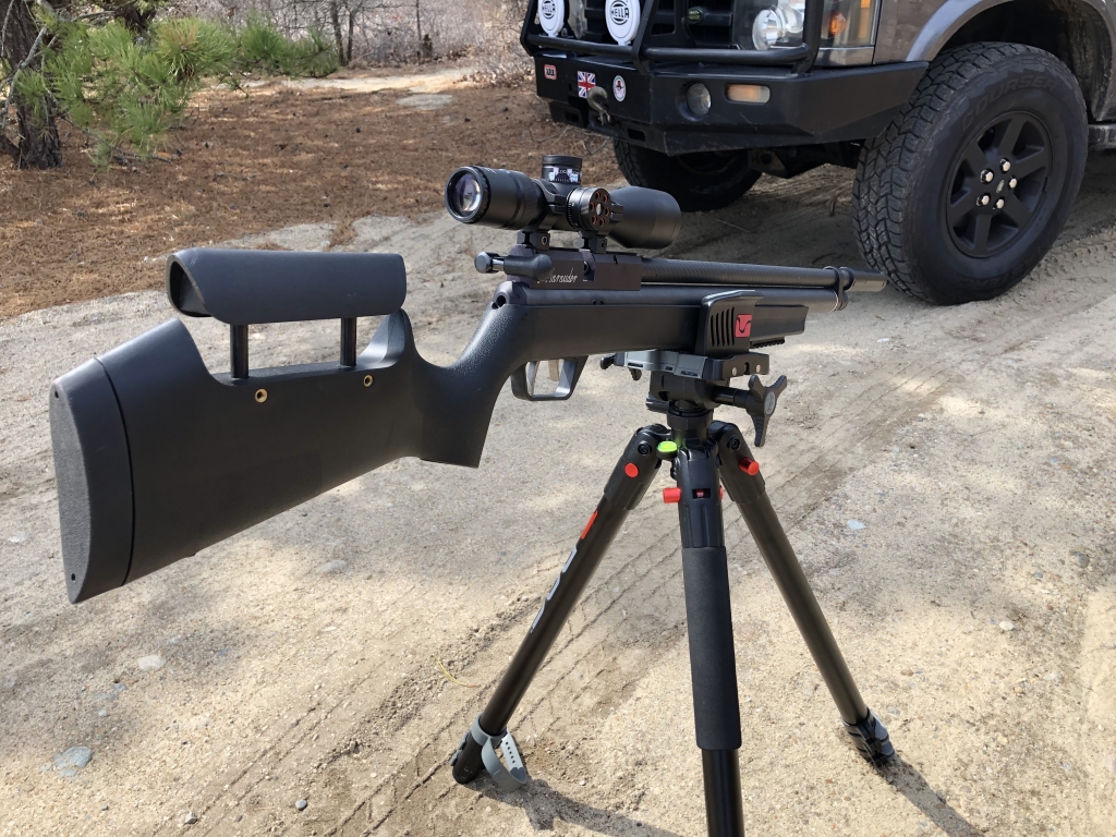

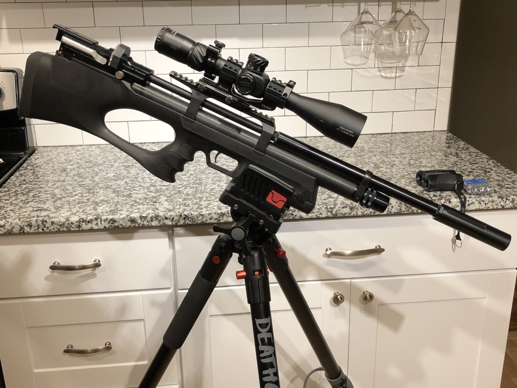

I have a hopped up Marauder and Kral PB both in .22. The Kral is hands down a better hunter at 60+FPE and tiny tiny groups with slugs. The Marauder is a sweet full size rifle that will shoot good with slugs and has a KILLER trigger, much better than Kral and especially Kral bullpup's .
Everyone looking for their first PCP just wants a gun that is great out of the box, then inevitably 30 days later everyone of those guys just wants to tweak one thing. 3 months later they've replaced every part on the gun and wish they bought something a little nicer to start with.
That being said the Puncher Breaker was the first PCP I bought, I've since bought (5) more and I would sell everyone of them before the Kral for whatever that's worth, I friggin love that gun...
