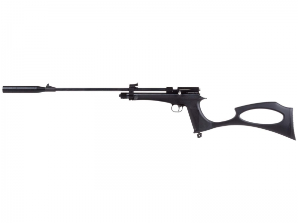

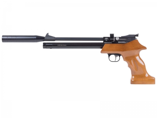

I have been looking for an EXTREMELY lightweight PCP rifle and still haven't found what I've been looking for. Came across the Diana line and noticed that they have the Chaser (rifle kit). It's VERY light, but is CO2. Also noted that they have the Bandit, a PCP pistol. In looking at both very closely, I'm kind of wondering if there could potentially be a hybrid there of removing both stocks of the Chaser and the Bandit and putting all the mechanics of the Bandit onto the Chaser's stock. Then I would replace the barrel of the bandit with the Chaser's rifle barrel.
I realize the Bandit's air tube is only 50cc's, but that's enough for when I need to do some immediate "pest control". Both CO2 and PCP air tubes look to be about the same, but if they're not, I'm thinking I could modify the stock somewhat to make it fit.
I'm pretty new to the airgun world, so I wanted to get some of ya'lls input on what issues I could potentially run into, before laying down the cash. I know there has been a lot of CO2 mod's that can achieve the higher FPS's, but it can get expensive in doing so. I figure, if I can make this happen, both guns would only run somewhere between $250-$300, and I could possibly end up with a very (relatively low cost) light weight product that can deliver a decent impact.

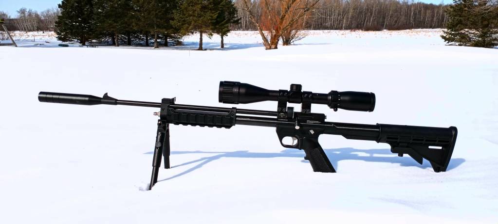

Yes you can put the bandit in a chaser stock but you will still have a gun that has a shot string that looks like a tire going flat. The Bandit owner needs to have some hammer springs on hand and do some tuning. I have seen the shot strings from these guns and it is ugly, but I believe fixable if you are willing to sacrifice some FPS. In your case, being new to PCP's, buy a P-rod. There is a base tune on YouTube and every air gun website that puts you right in the mid 600fps range for at least 3 mags or 24 shots. I have a P-rod and I have 3 Artemis (Diana) guns. No comparison. You can call Crosman and have parts delivered to your house in a week. Good luck with that with the Chinese Diana. They market the Bandit as an entry level PCP but until they lower the velocity and flatten out the shot string, it will frustrate the owner when he is shooting past 20yrds. I also have a Leshiy. Great gun but you can have 2 decked out P-rods, a compressor and a hand pump for the same price. My P-rod will match my Leshiys accuracy but not velocity. My P-rod has a SS valve so it closed the gap on speed but there is a reason the Leshiy is $1,400.

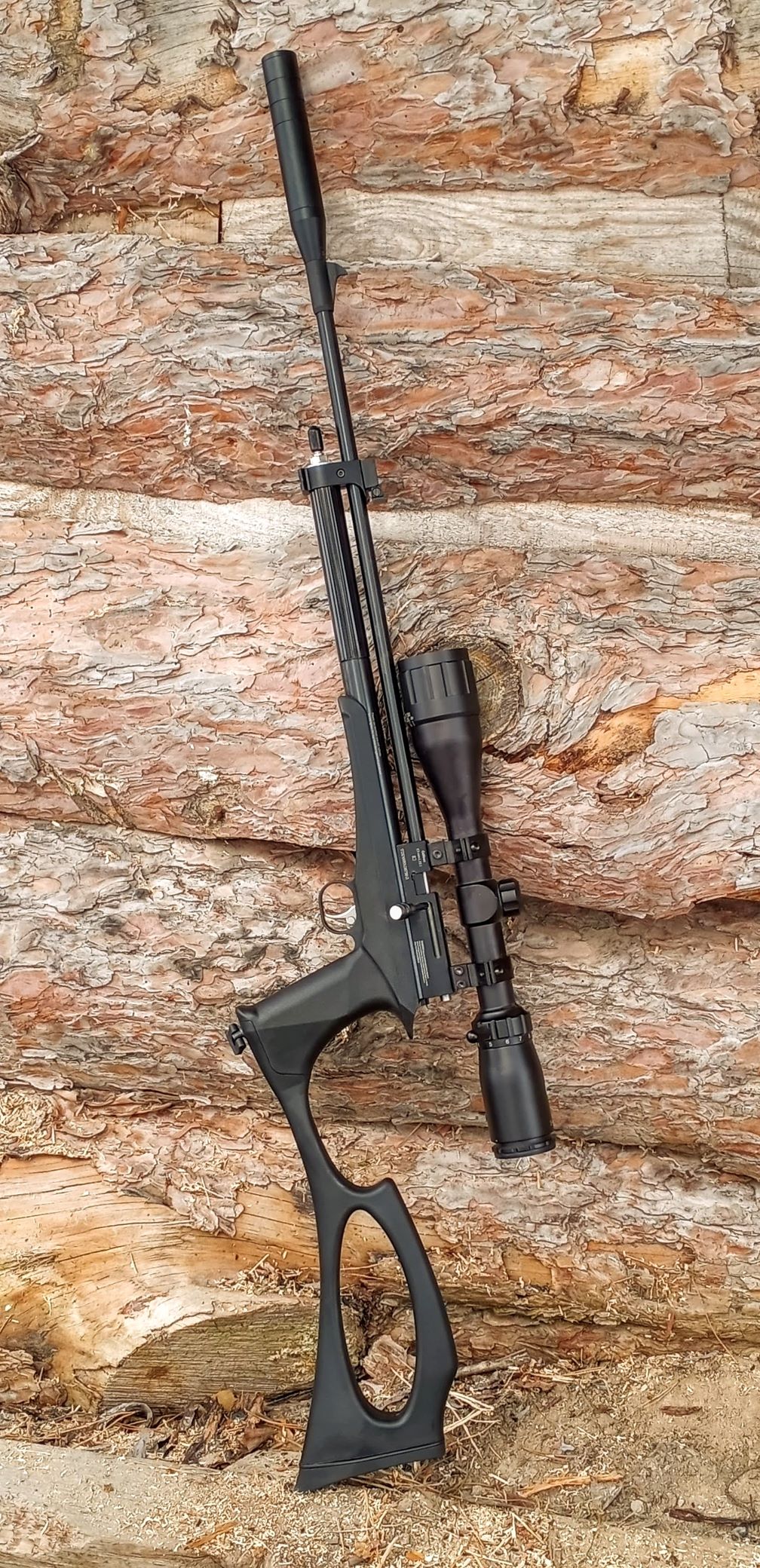

YES! Get a SafPack and make the Chaser a PCP!
