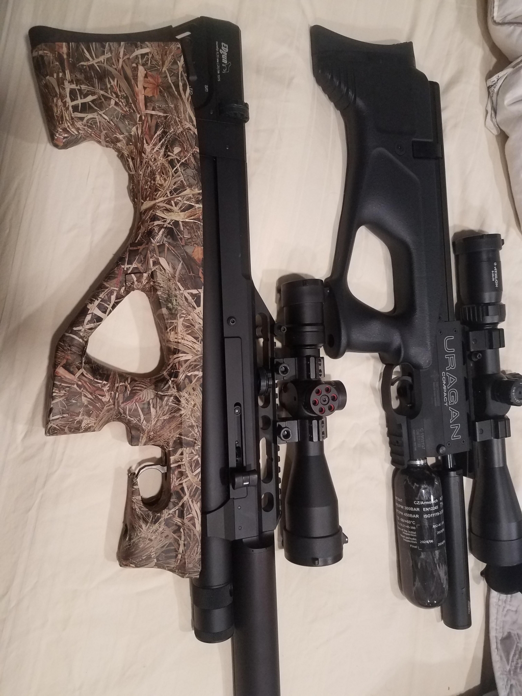

for pigeons, starlings and squirrels. The .22 Uragan will do it all well past 150 yards with H&N 21 grain slugs at 840 FPS . Mine shoots sub moa out to 190. I’m just starting to test Nielsen’s and they shoot well too.
Mine shoots slugs better than pellets at all distances.
Im testing the Vulcan in 25 and it is getting similar results. It likes the 27grain NSA and the 29.5.
the cz barrels shoot slugs extremely well at relatively low speeds and high speeds. There are numerous myths here that slugs have to be shot at high speeds.... it’s simply untrue with the cz barrels. I’m shooting them at 780- 840 with stunning results.

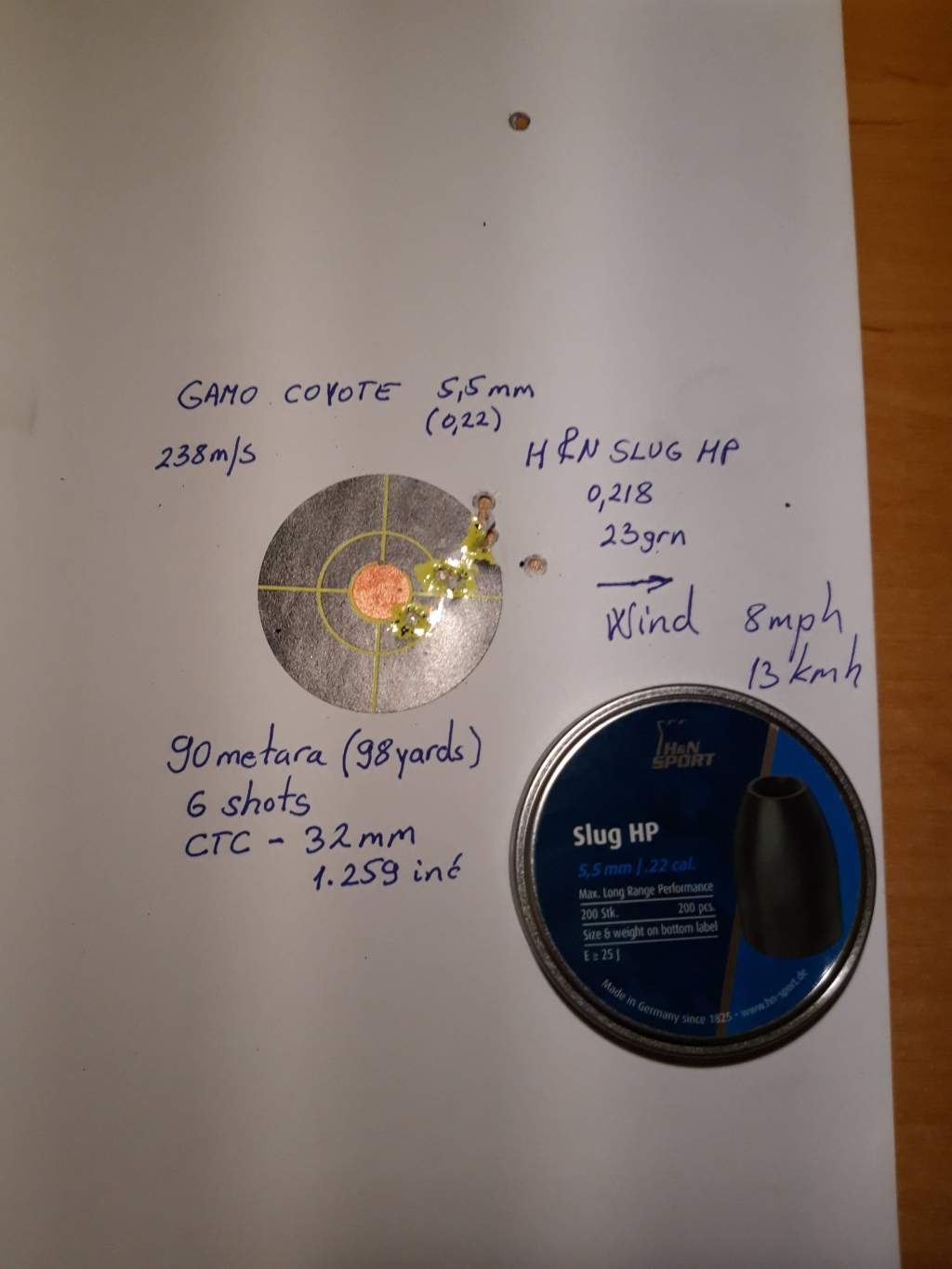

Woah sick post some sub moa 190d groups please!
