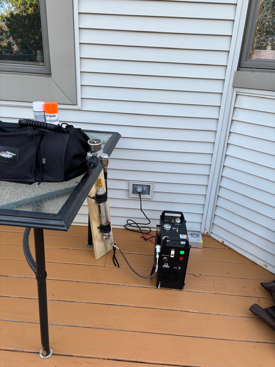

I broke down and purchased Joe B's air filter. Very happy with how much water it catches. I have it mounted on a piece of plywood. Makes it easy to transport. This is at my friend's house on his deck.

I don't know which compressor that is, but is it meant to fill scuba tanks or rifles directly? If it's for scuba tanks using a filter that large would make sense, but for slower compressors meant for filling rifles directly it might be a little counter productive, as filling the filter might take just as long as filling the small rifle bottle.
this is the exact set up i have . no tanks just guns works great ! And what little time extra is nothing compared to H2o in the guns .
