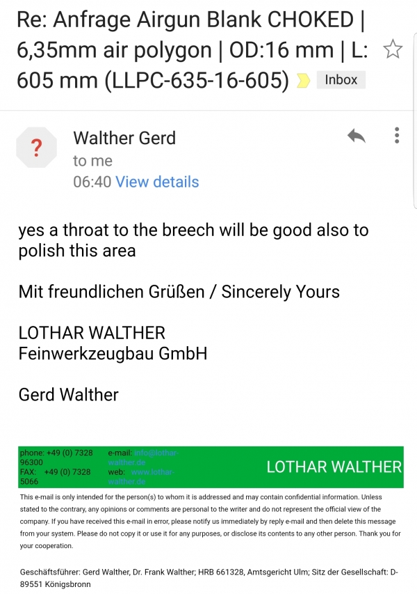

I've spoken to a gunsmith in the interim, and he has suggested that the breech needs a throat.

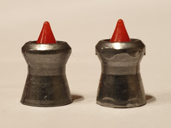

Before and after going through the polygonal rifling.
The barrel was given a throat in the breech this evening (thanks to my mate, Richard), and now loads as smoothly as you'd want it to. Despite the difficulties of using an NV scope indoors, it was starting to group quite nicely at 25 yards. I need to put some more lead down the barrel. The scope is a Yukon Photon XT with the extreme conversion, and it's got the common problem of running out of adjustment to zero it. I bought a set of Sportsmatch fully adjustable mounts, and practically have it optically centered with them alone. I love a happy ending. 😁
