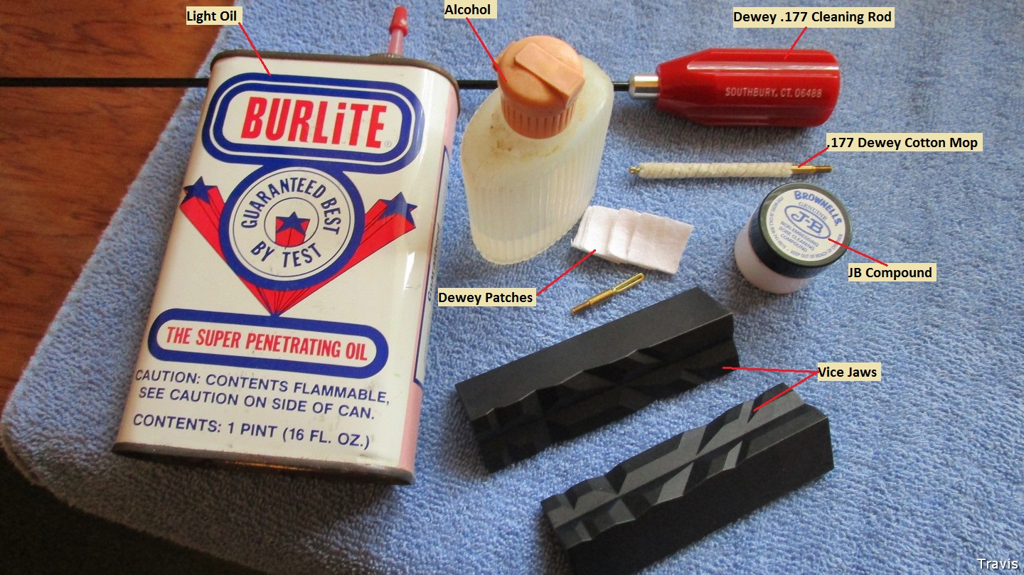

Thomas, what equipment and compounds did you use?
-Marty
Hello Marty,
Here is a photo showing all of the supplies. You cannot find any Burlite but CPL is what you will buy. I used 5 of the Cotton Mops, 3 to do the polishing, 1 as a pre-cleaner, and 1 as a final cleaner. I used a BUNCH of the patches before the polishing to make sure the barrel was completely clean. I ran 1 down the barrel after each of the first and second polishing to clean out residue and then a BUNCH after the polish to do a final clean. This is really very easy to do but takes a bit of time. I did 20 strokes for each of the 8-inch sections and I simply put blue tape on the Dewey Cleaning Rod at 8 inches, then 16 inches and finally at 24 inches. At 24 inches the tip of the Mop DID NOT come out of the muzzle end of the barrel.

Hello Marty,
Hope this will help,
ThomasT
Thanks Thomas, sure is helpful!
-Marty
