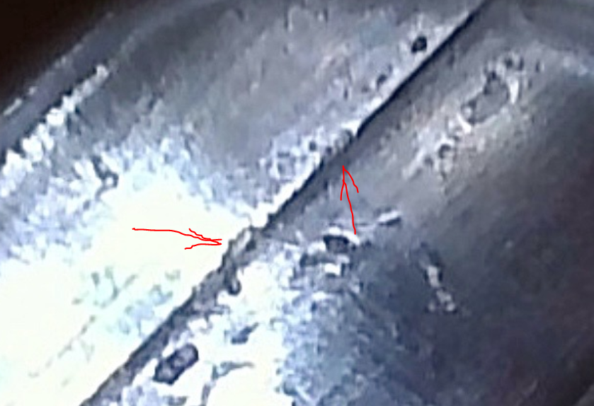

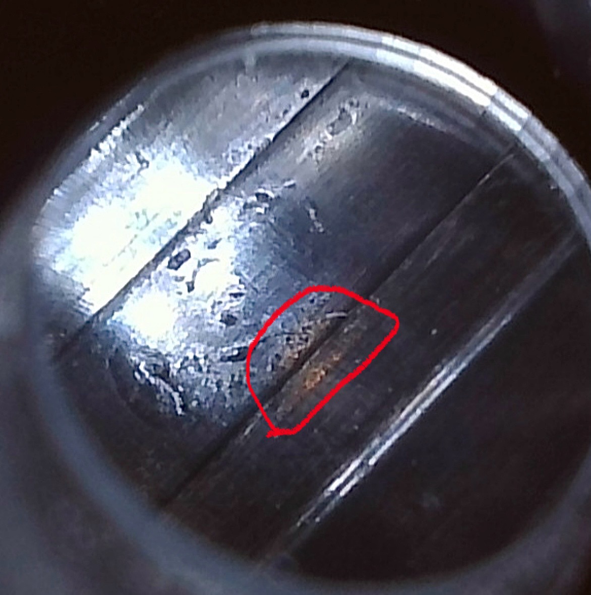

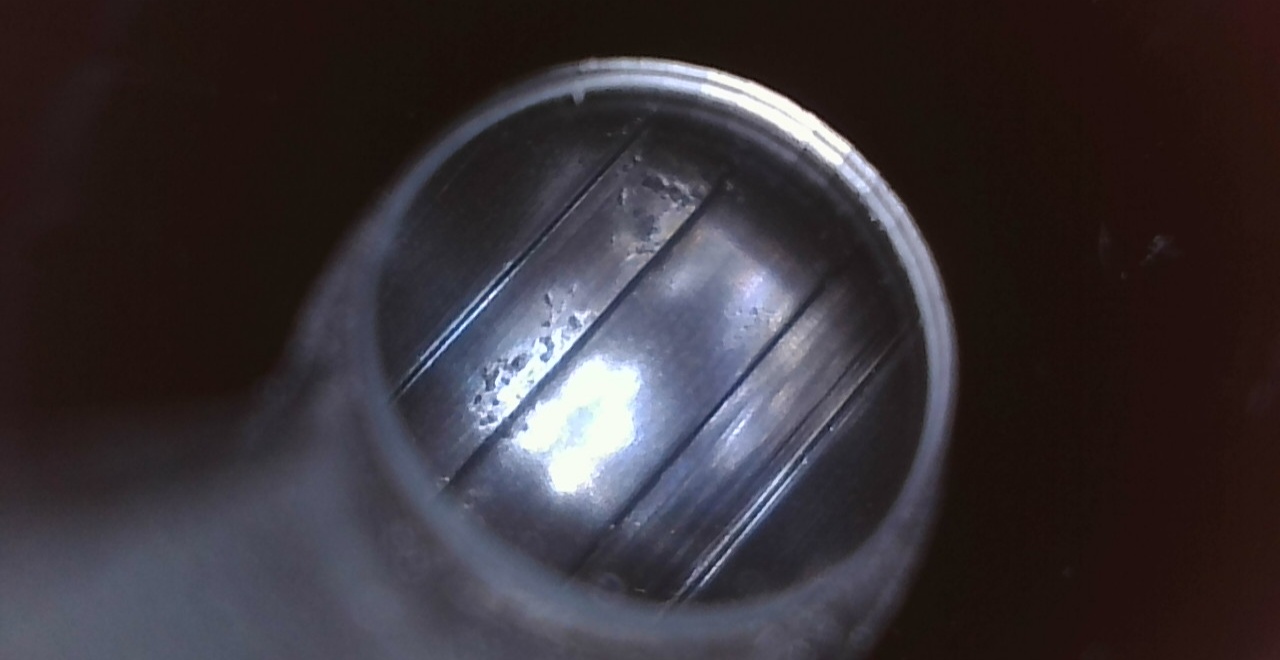

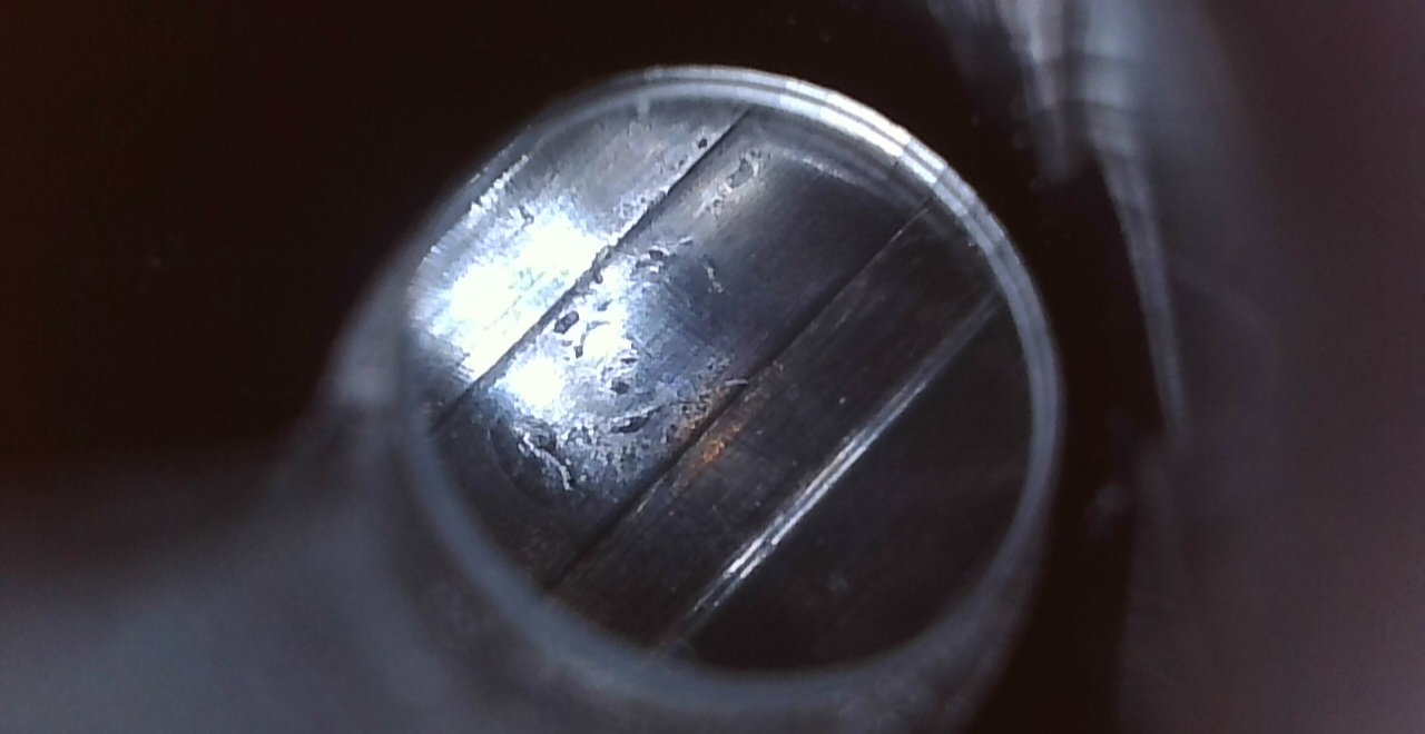

I gave the muzzle end a thorough cleaning (because it was easiest) first with Gunzilla and then with BoreTech Eliminator (a firearms solvent), both applied liberally with cotton swabs and scrubbed with a nylon brush. Here are pictures from after (compare to first pic above). I see no difference and didn't see any material on the dry cotton swabs used to clean the solvents. I'm open to other theories but I would have expected any lead to be removed.
Absolutely bad pitting. Was the gun used when you bought it?
I still see brown rust. Switch to the brass brush to be remove it. And use a bigger grit polish.
Dont fear the brass brush.
Little science for you. Brass is MUCH softer than steel.
And for the ones worried about using a brass / bronze brush, take the brush to a spot on the outside of the barrel and scrub like hell. Clean and inspect with a loupe or some other means. Unless it's made out of cheese, you won't see any damage, it may give it a slight polish. Just stay away from the cheap brushes with steel cores.

Frankly, it shoots better in my limited testing after I polished it. I'm going to shoot it some more, and at distance, and if accuracy has improved despite the pitting, I'm just going to keep it. It sucks, but I'm not competing with this rifle, and if it's MOA at 100 (it was about this already) I don't have much to gain. I would just be proving a point. And I'd rather have my coyote hammer at the ready :)
