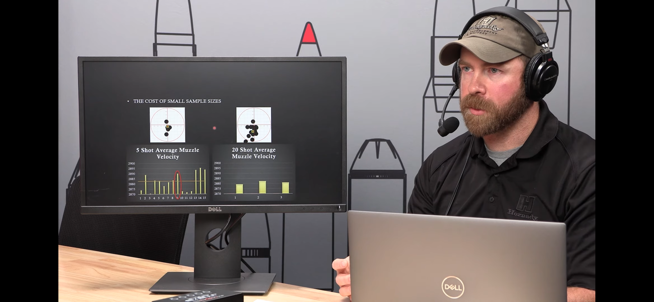

Here’s a great demonstration from their podcast. This was real test from a real powderburner. They started with 5 shots. Note the point of impact. Then they kept going to 20 rounds. Look how far the average point of impact “moved” from the 5 round average.
I started shooting 20 rounds to zero my rifle and my “point of impact shifts” disappeared. That’s not to say your rifle doesn’t shift its point of impact. There are mechanical reasons some guns/sights can shift zero.
I can make my HW77 put 5 into a 1moa hole by just tossing cards until I get one. But realistically, it’s a 3-4moa gun if I shoot enough pellets out of the tin.
If I feel like my zero has shifted, I’ll put down 20 rounds and usually find that, no. It hadn’t shifted at all. Either the wind was pushing my rounds off or pure luck put 5 shots on one side of the target.
Just food for thought.
