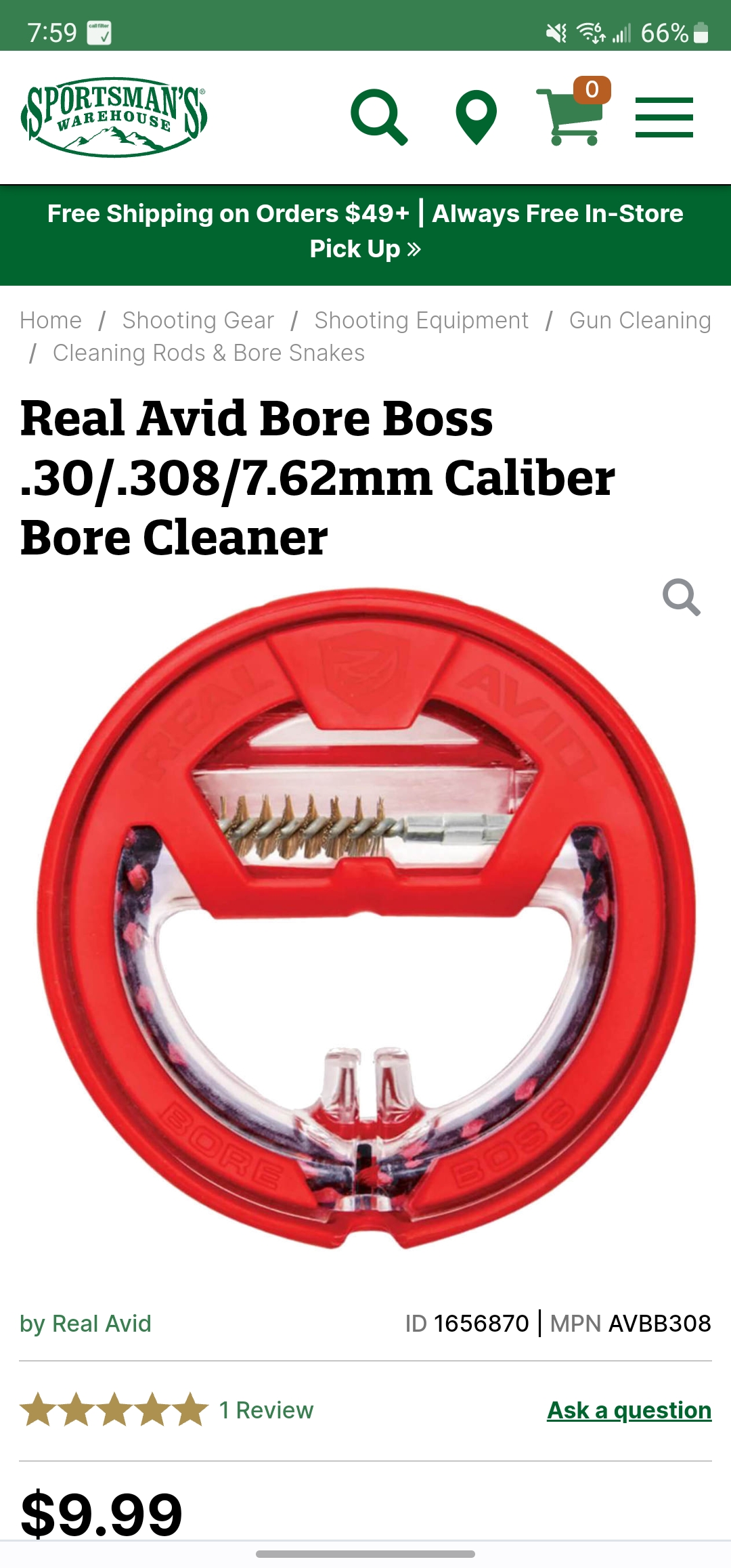

Will one of these work ok? I can't find any barrel crowns
Cleaning is a subject that seems to stress people out; especially cleaning from the muzzle. Yes, the crown is important, maybe the most important to barrel performance but it's not made of glass.
Reasonable care is required but that's it. The barrel steel used is 4140 alloy that is heat treated and stress relieved to a hardness of Rockwell C 22-28. Not only do you have a high relative hardness, the hammer forging process will add additional surface hardness. A bronze brush run from either direction will have zero effect on the metallurgy.
If you don't have a crown protector, just use care not to bang the transition between the brush and rod into the crown. Align carefully and go slow during entry and you will be fine. Rod and bronze brush with lead solvent is the most effective.
