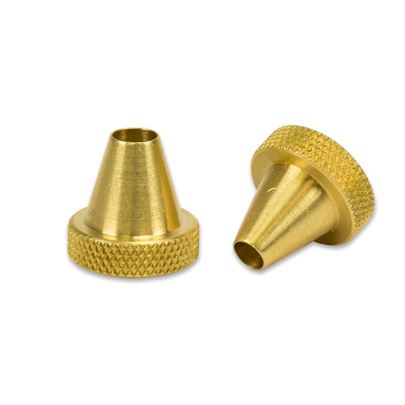

A.K.A. "muzzle guard" - centers the cleaning rod & protects the barrel crown (y)
