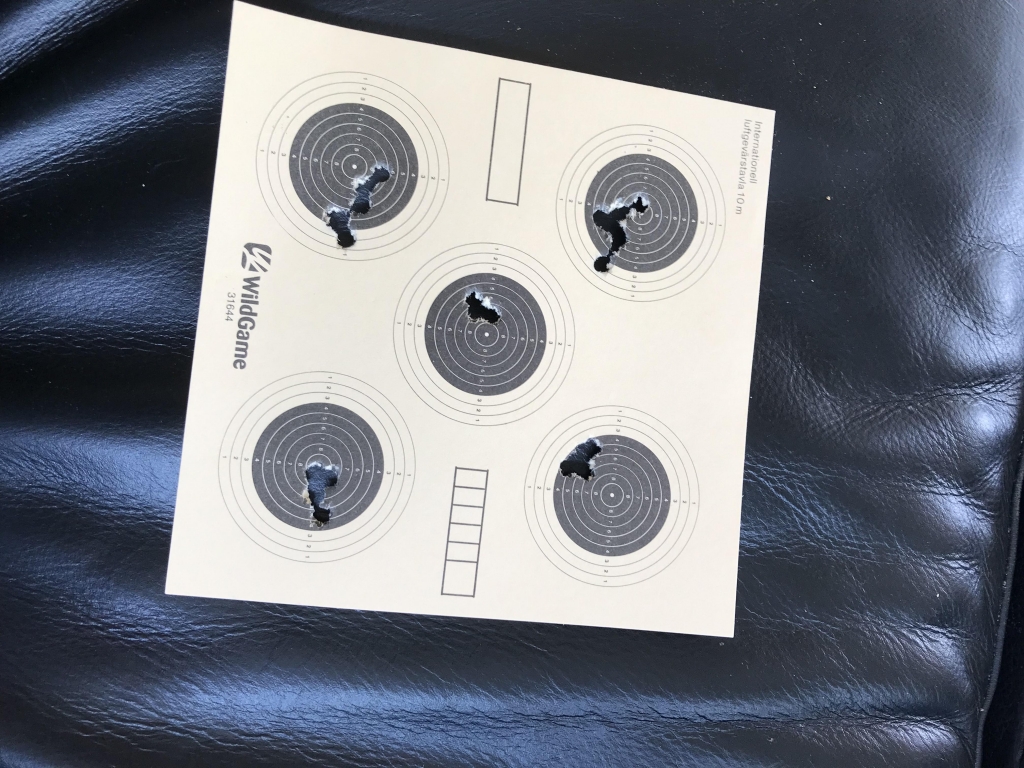

Okay so Got some kind of a resault today. It Can absolutly not shot the jsb 18.1g pellets not with the pellet liner or my slug liner,, but it shots slugs and jsb monsters pretty good. this is out of mig 600mm slug liner.
So is it the liner or the pellets that is the problem? Remember that i have shot over 3000 shots and different batches
1566661392_12139492305d615b10ed4d06.63892590_B4E739C5-0132-43D8-878F-762A90A46750.jpeg
So tryed some jsb hades but had trouble getting em down under 900fps so i shot them at 930fps with pretty good results, tryed the jsb heavy diablo just to be sure that it was the same, and they still did not work.
so for some reson it will not shot the jsb 18.1g pellets
i will try to order a new batch of jsb 18.1g and if it is the same, then it has to be the liner..
