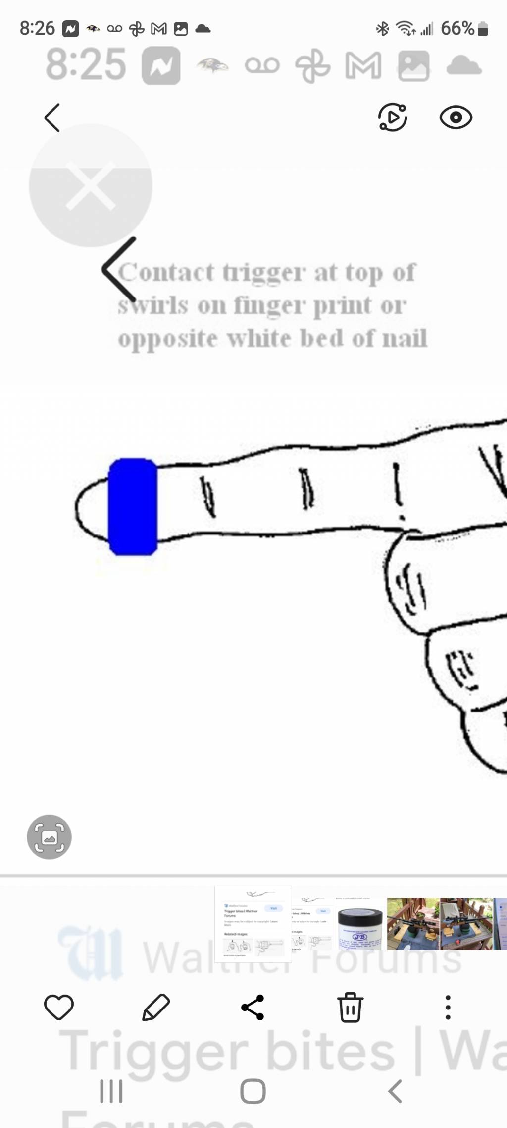

For me when I’m not shooting good or the groups are all over the place it’s my finger placement on the trigger, my pull and follow through.
