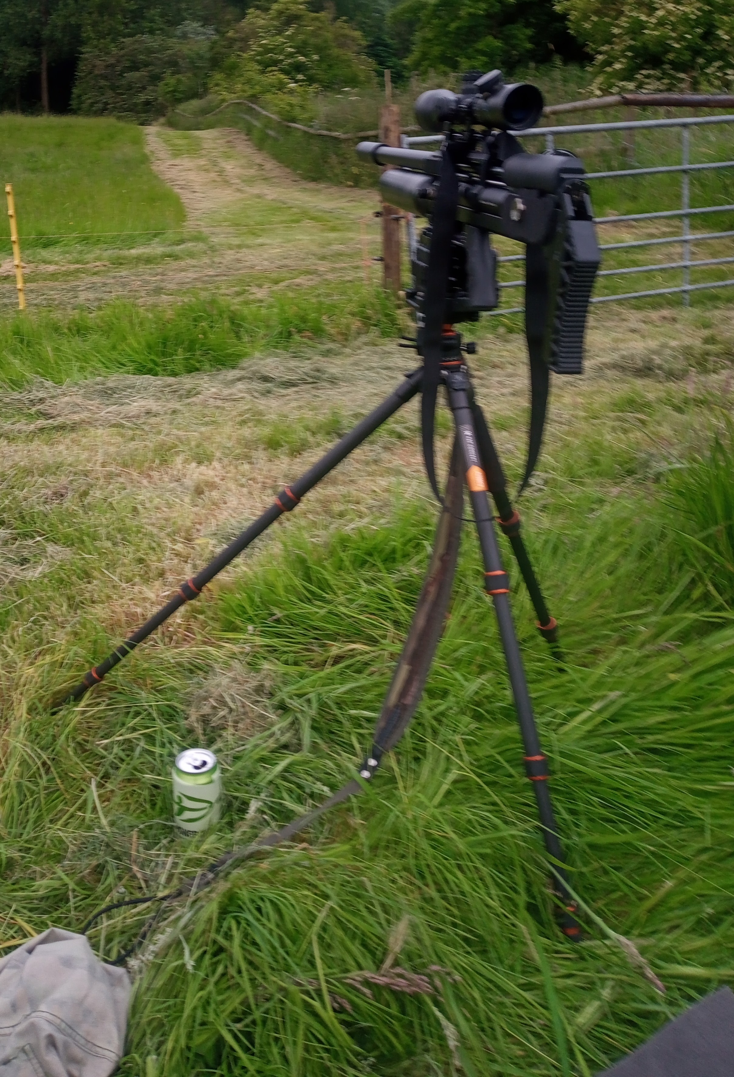

i test in isolated environment
i use rest and rifle is level and bubble is in center
tank pressure range from 230 ~ 170 bar
woogie_man (yes and plenum and rest of rifle are completely aligned )
from 230 to 210 in 12o clock
210 to 200 in 3 o clock
200 to 190 in 6 o clock
190 to 170 in 9 o clock
and below them goes to 12

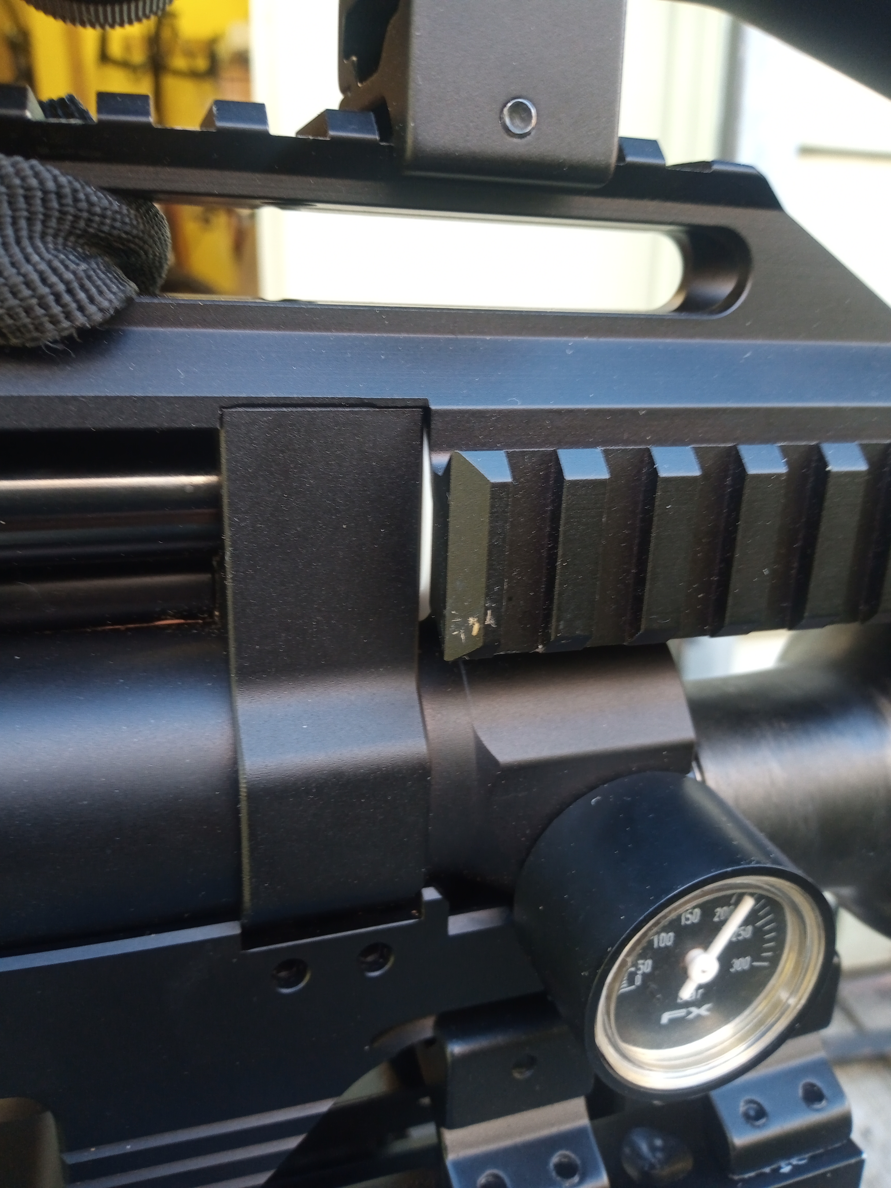

Hi Guys
I have a problem with FX impact M3
I found that my poi followed a repeatable pattern through the course of a fill
there isn't any contact between the barrel and air tube
barrel cleaned and scope parallax is ok ,scope rail and mount is tight enough and liner is indexed
ES is only 5fps in shoot steering(more than 50 shoots) and 5 shoots group is very tight(8~10 mm in 50m)
but group shift have clockwise pattern start from 12 to 3 then 6 and 9 and last 12 after zero in each of them
any one have a suggestion?
Check the liner. Make sure it is not moving or rotating inside the housing if you have changed your liner, make sure you hand tight the jam nut then give it quarter turn with wrench Don't forget to apply some loctite blue
