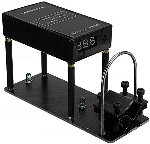

With airguns, a chronograph is essential if you want to tune your airgun. However, you don't have to have an expensive chronograph. This is what I use. It is cheap, works consistently and accurately.
https://www.amazon.com/VIKKA-Precision-Chronograph-Velocimetry-Chargeable/dp/B08DRJ3JW7/ref=sr_1_89?crid=1XER1OF6Y5ZGQ&keywords=air+gun+muzzle+velocity+meter&qid=1645827125&sprefix=airgun+muzzle+velocity+meter%2Caps%2C104&sr=8-89
Mine was sold under a different name, but this one is still the same.
It works well, even in total darkness without an external light source. I highly recommend it!
I just wish there was something like it MADE IN THE USA at an affordable price... (heavy sigh)

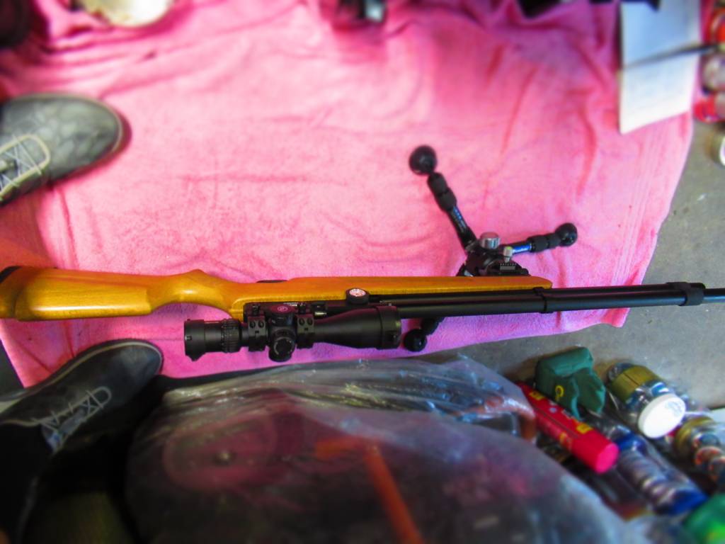

Timothy8507, on my Avenger, I discovered that my Picatinny rail on the Avenger stock was affecting my POI. I later removed the mount from the wooden stock and JB welded it to the stock and wiped off the excess before it cured. I had an arcu-swiss plate mounted and secured to my tripod. It was causing too much flexing of the tube and shroud clamp, affecting my POI. I later put a barrel clamp on the long air tube and shroud.
 Now I mostly use my death grip platform or bag.
