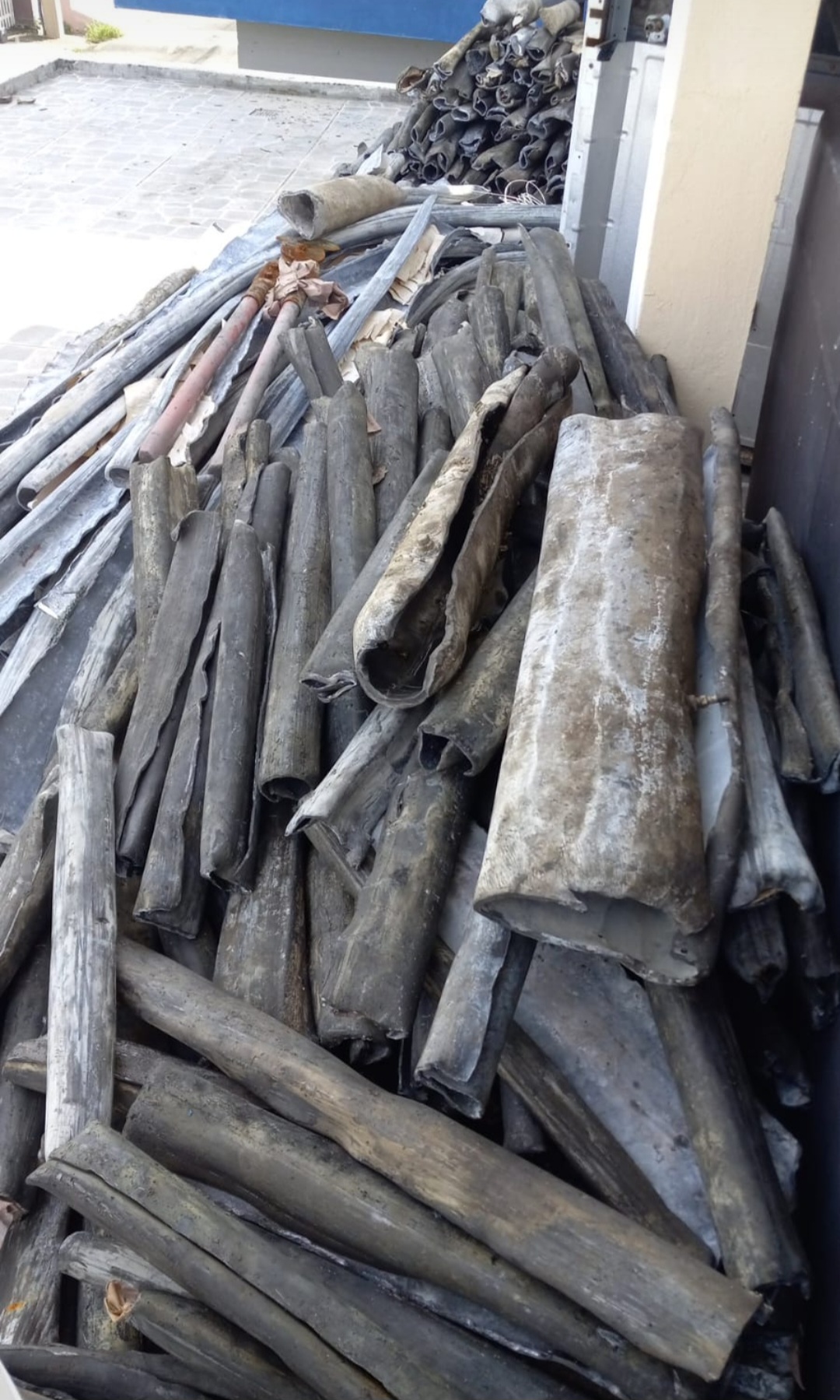

Plumbing lead
The answer is "that depends". Plumbing lead has different configurations depending on who made it and where it was made. Some has more alloy than others and some is pure lead. A not so accurate hardness test is to take a pure lead pellet and cut off a piece, about the same size, of the lead you are considering. Squeeze both with a pair of pliers or vice grips and if they both squeeze with the same amount of pressure, then use it. If the lead source is more difficult to squeeze, it is probably too hard to shoot accurately out of a PCP or break barrel. Not scientifically accurate but will get you close enough.

Thank you let see what price i get..for the hole lot 3,500 pounds.

@aroundlocks How can he ensure that the lead is completely dry considering the bulk of it is pipe lead? Is there something that one should do to prepare the pipes before smelting it? Also what is an adequate type of face shield to wear that can withstand hot lead splashing on it without melting or burning through it? Where can one purchase the necessary type of face shield?
That is a very nice stash of lead.
It is NOT plumbers lead, it is cable sheathing. It has antimony and likely other metals as well.
Right now it will seem soft (thumbnail test) but after melting and cleaning it will become harder, and
over the next couple of weeks, it will continue to get harder. The simple proof would be to melt a bit with
a torch into a couple of small puddles, or better yet, a couple long, thin ingots. Smash or bend one as soon
as it cools. Save one or two more samples and try the same test in a couple of weeks, if it has hardened somewhat, you
know it is not pure lead.
Accurate melt temperature is reliable, but more difficult to achieve.
There is going to be a LOT of smoke when this stuff melts, keep that in mind if you have neighbors. This MUST be done outdoors,
there is a high risk of the smoke igniting, sometimes with force.
The safest way to melt lead is to load the cold pot with lead, then melt it.
Any time you put something into a molten pot of lead you are asking for trouble and very likely to get it.
The easiest way to deal with the sheathing for melting and cleaning is to chop it up with an axe to get sizes that
your pot will handle.
Pine sawdust is an excellent flux. It also smokes, is best put in the pot before the melt begins, again, the smoke is flammable.
One of the benefits of sawdust is the charcoal it forms absorbs a lot of crud from the dross, well stirred, it also helps clean the
leadpot. Many commercial fluxes attract moisture and corrosion is a problem.
Cable sheath should make very good powder burner bullets with only a small amount of tin added, but I think it will be a bit
hard for airgun use if dead soft lead is what you need.
Imadman's post #14 is solid advise.

Thank you .. is Christmas the owner is out I have not paid yet .. I asked for a sample first to melt n test .. Question..? It will be used to cast. 224 - 257 - 308 . Will Not be used for low power guns ... this lead being a bit harder .. would it work ? .. in my firsts castings sessions molds driving bands didn't fill up correctly .. som airguners suggest 2% tin for a better fill up..
There may be several reasons your early casting sessions were not turning out perfect bullets. Bullet casting is a hobby all in itself.
Frankly I have never cast for airguns, but have a bit of experience casting for powder burners.
If you add tin to the cable sheath lead, you will have a very good alloy for handgun cartridges, but maybe way too hard for airguns.
Antimony is used in lead alloy for extrusions. When this alloy is worked, it softens it, and somehow makes a better extrusion than pure lead.
Lead that seems soft in its cable sheath form, will change when it is melted, allowing the antimony to reform and harden the lead again. Adding tin
to it will make it even harder when it combines with the antimony. The interesting part is it will continue to harden over the next month or so.
The other thing to be aware of is the size of the pellet or slug.
Lyman bullet molds, for example. were designed to cast a specific size bullet with a particular alloy, rifle and pistol molds sized with a Lyman #2 alloy,
muzzleloader balls and bullets size correctly with pure lead.
Lead/tin/antimony alloys shrink less than a pure lead pour.
If you have a mold that is designed to drop a bullet measuring (for example) .308, using a lead tin antimony alloy, if you used pure lead, that mold may drop a bullet of (for example) .305
It works both ways, if your airgun mold is designed to size correctly with pure lead, using an alloy will make a hard bullet that is oversize.
That is a shadetree explanation as best as I recall, anyone that can correct it is welcome.

Thanks..the guy will bring me 2 pounds next week to test n cast .. hope it works.. lead in bulk is difficult to come by .. the casting I tried first was will pure lead of wish i find 2,800 pounds .. so if I manage to get the temp right is supposed to do great bullets with only pure lead..?
