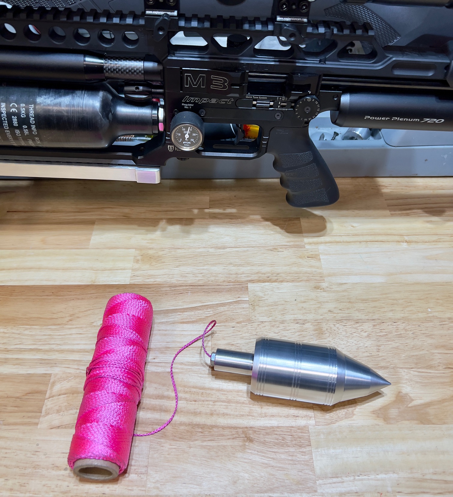

Lots of different methods posted here on how to level a scope....I've tried several but the one I have always used works the best for me, nothing wrong with any of them as I'm sure they all will work. About the plumb bob... I do know that the same thing can be achieved by just tying some kind of a weight on the end of a string, but I chose to machine the plumb bob just because I can...I actually machined two of them, the one posted here is heading to a good home where it will be used as intended and here is a pic of the second one I made.....:)
Nice. I made one as well out of hex stock, but rarely use it. Instead I just draw a plumb line on paper with a sharpie and a level.
