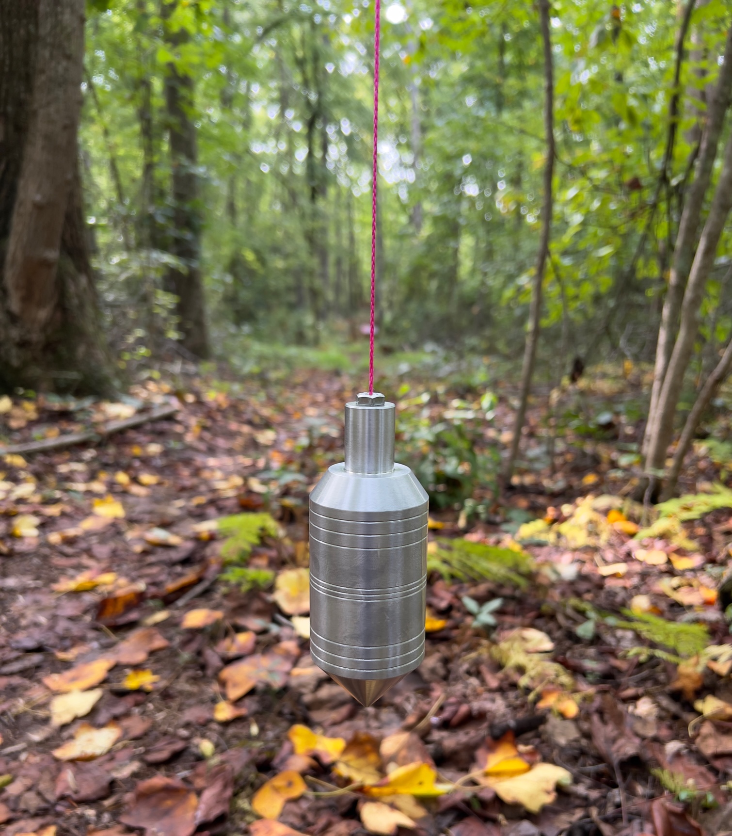

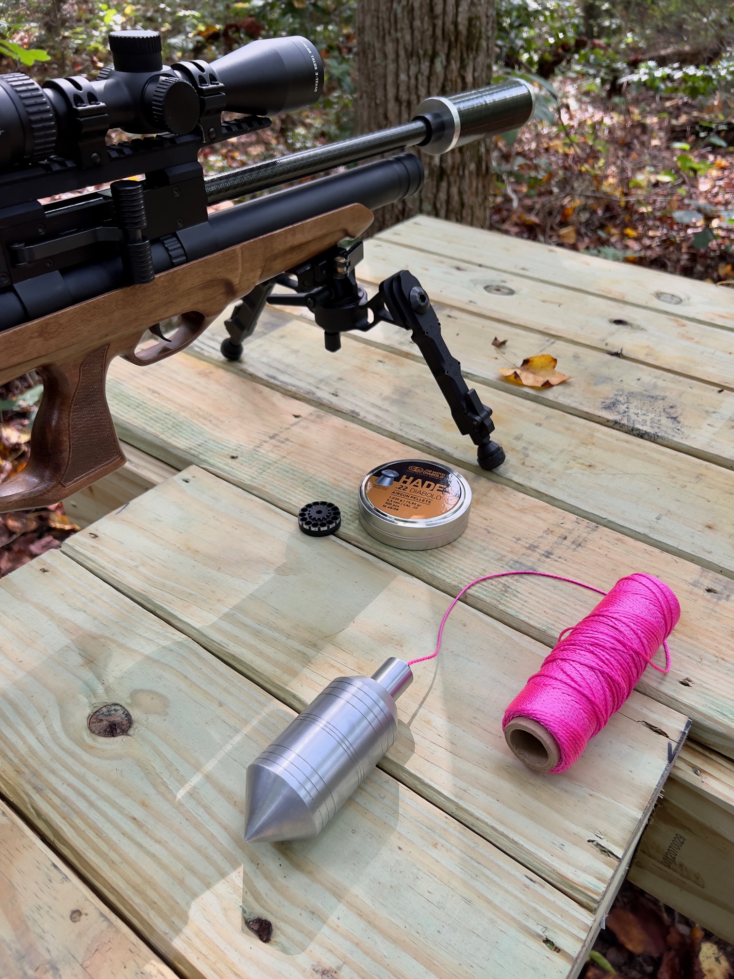

I got tired of fooling around with small plumb bob's always moving with the slightest breeze while trying to align my scopes. I machined a large plumb bob out of 2" diameter solid aluminum round bar and that took care of the problem....got all my scopes aligned today and it does make a difference, especially when going from 50 yards to 100 yards and further...:)

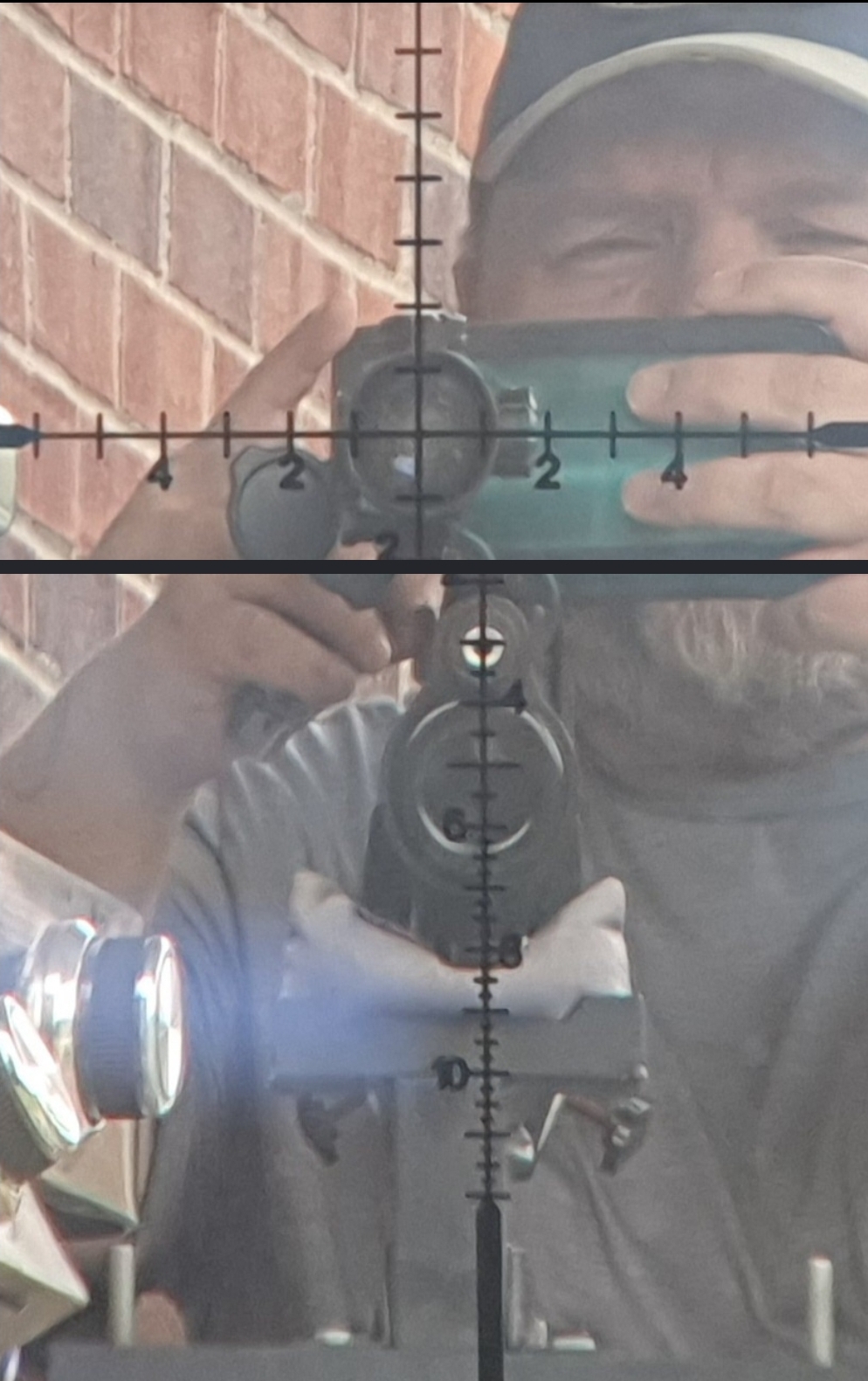

Step one: align reticle (vertical line) with barrel bore using the mirror as shown in the photo.
Step two: which is using the plumb bob only matters if you will be using a shooting level, attached to scope or pic rail/ dove tail. If not installing a level on the scope preferably then there is no use for the plumb bob.
Step one removes scope cant and once set stays set.
Step two by using a scope mounted level set to the reticle, allows the shooter a visual reference (the bubble) to be able to hold the gun true at each shot.

OP: very nice plumb bob.
I have only recently begun using the mirror and plumb bob method and tied a piece of string to 2" wide strip of lead sheet rolled up into a 2 1/2" coil. It works AND its's real pretty... well it works!

loosen the scope ring screws and rotate the scope till the vertical crosshair intersects the center of the bore when the crosshairs are centered on the scope objective.
"bam" your crosshairs are now aligned with the bore

It seems to me that the best way to do this would be by using the mirror and two plumb bobs. Hang one plumb bob in front of the mirror and hang a second from the muzzle of the rifle in line with the bore then line the two up through the scope and you'll have the crosshairs and the bore in perfect alignment.
You could probably just use the one hanging from the muzzle, but a second won't hurt.

Well the reticle center point is always aligned to the center of the bore no matter where it is. But is the vertical centerline of the retical aligned to these two points? Using the mirror method will get you there. Using the plumb bob will not always give you that because assumptions are made.

Remember this picture with the scope moved over to the left of the bore? The scope retical vertical is not lined up with the center of the bore, yet using the plumb bob the scope sees the plumb bob correctly. if that distance is the only distanced you will ever shoot, you are good. but if not cant will be a issue.
if you use the mirror method even though the scope is to the side you will see that you are off and will have to rotate the scope in the rings so everything will line up. At that point your retical finally correct.
