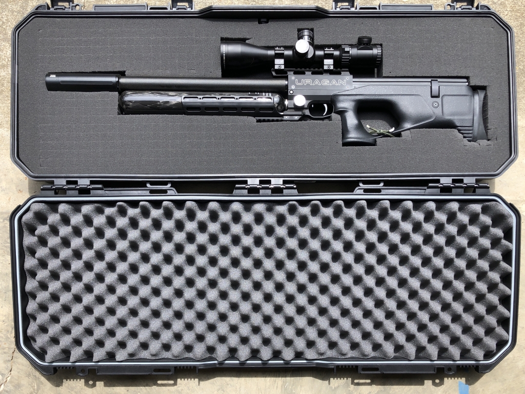

Just did my Uragan in the Plano. A bit tedious since I didn’t want to overly enlarge the hole. I went one little square of foam smaller all the way around initially, then could see where I needed to pluck the final pieces out. Mine is still a bit tight in some places but am going to leave it that way for a few uses and decide if the few remaining tight spots actually need to be removed or not.
