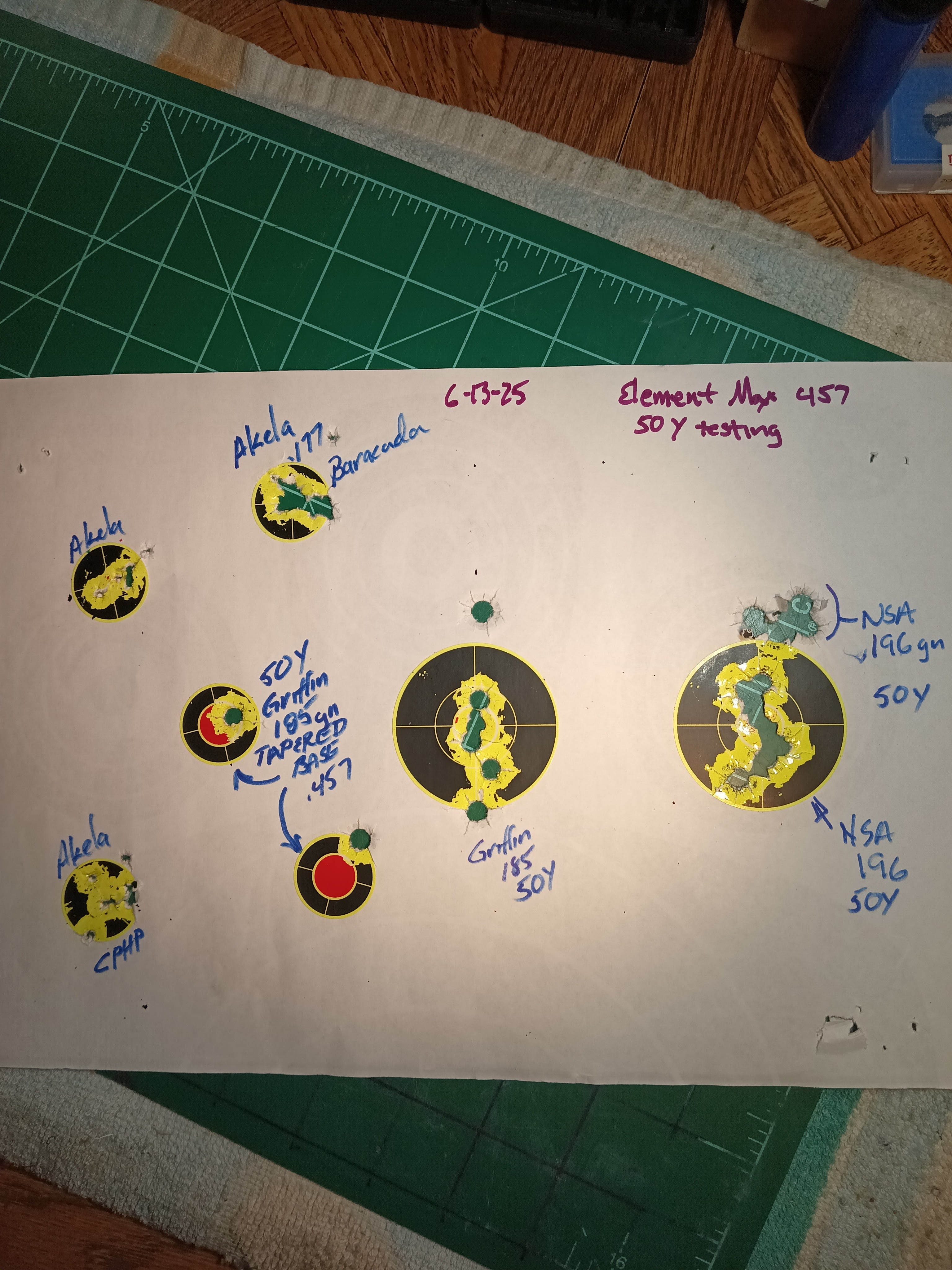

Took my recently acquired Element max to the range today. I wanted to check out low starting pressures. I really like the gun and it's a blast to shoot, but if filling to 300 bar or so seems like a waste. Not to mention crazy Shot strings. So;
I ended up filling to 180 bar, .457 griffin 185gn. tapered base & 600cc air tank.

Target Shot at 50 yards off a bench and a front bag. 1 and 2" targets.
