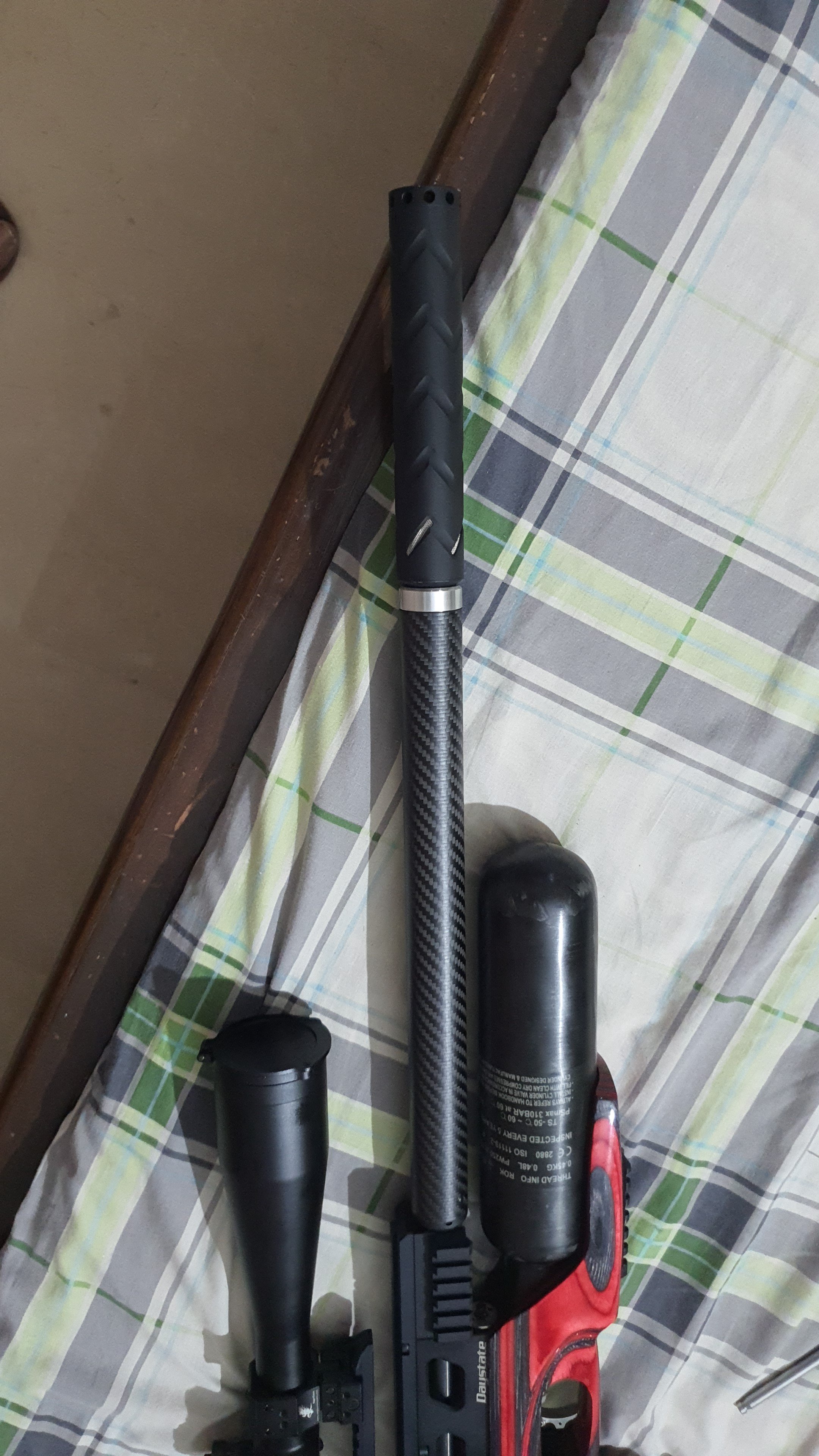

I have made a proper muzzle brake to send the air pressure Backward in the shroud.
