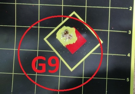

I get 910 fps at 141 bar on an EDgunn EDMU valve travel adjuster on line 4, power wheel max and no slack in the hammer spring. Shoots under 1/2" for 5 shots at 55yds.
