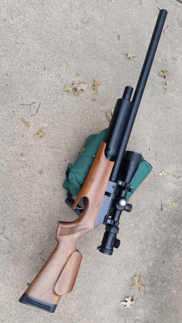

Oh...like this old Theoben Rapid MK2 .177, .20, & .22 cal rifle redone by AZ?...
The Old...
The new...
And a quick clip of AZ's accurate "Dial of Death" @ work...

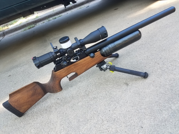

Mine matches those specs-even though it was setup as a .25 cal polygon setup (60 fpe in .25 cal). When I put my .30 cal barrel and probe on the gun I get 40-ish shots in the 875 fps range at higher summer temps (97F), with the HS tension on the lowest setting, shooting JSB lites. I can bump up the power to about 83 fpe with just a HS tension adjustment (shooting .30 cal heavies) or down to the lower 70's. This is with a 230 bar fill...
Look through my BC threads for specific information on power numbers in .30 cal if you want concrete numbers (with temperatures). I've posted a lot of data for actual numbers, in various cals, at various temps (and have more data that I haven't posted also).
Click on my username, and then look for 'threads started' - you'll see a bunch of threads on BC's for a variety of different things. If you have questions, feel free to ask.

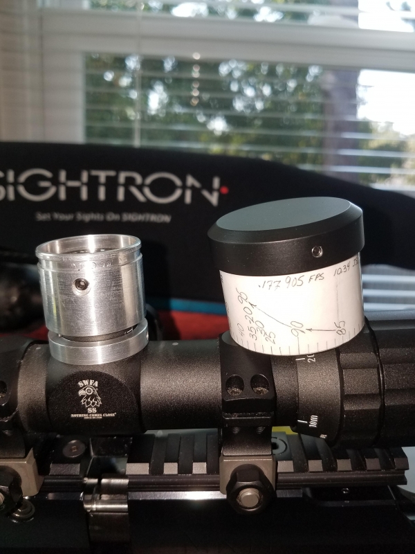

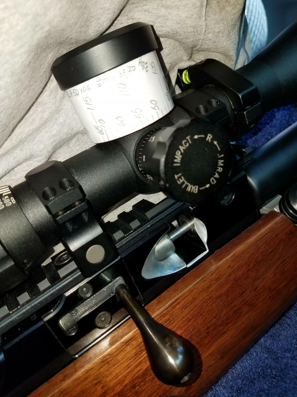

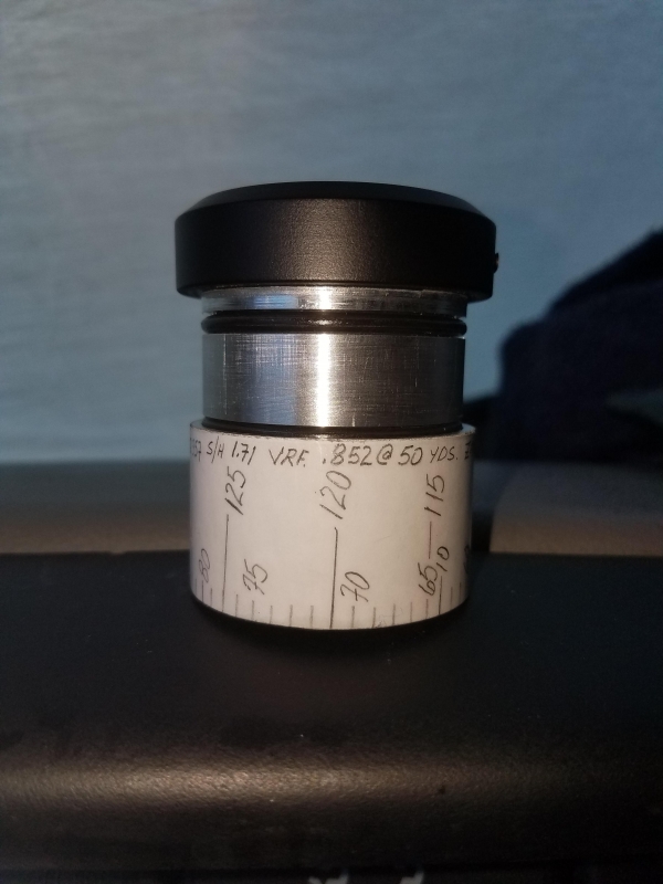

I apologize I've never done a full shot string w/ this multi caliber Rapid. I probably never will. I'd rather shoot things w/ pellets. I just fill her up to 250 bar and shoot her down to 150 bar...
From what AZ told me...
The Rapid in .177 cal shooting jsb 10.3g @ 905 fps @ 18 fpe, she gets well over a 100 shots...
In .20 cal, she shooting jsb 13.5g pellets @ 865 fps @ 22 fpe, she gets really close to 100 shots...
In .22 cal, she shooting jsb 15.9g pellets @ 830 fps @ 24 fpe, she gets 80 - 90 shots...
The other note, my AZ tuned .25 Raw HM 1000x is shooting jsb 34g pellets @ 890 fps @ 60 fpe. She's giving me about 40 shoots per 250 bar fill.
