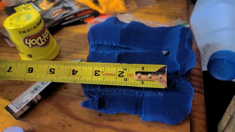

Looking at YouTube pellet testing in ballistic gel, I found a short video where the guy compared the expansion and penetration of pellets in BG and Play Doh ... it was amazing, the terminal ballistics were practically identical for penetration and expansion in both mediums.
Being the practical guy I am, I ran straight to Walmart and bought 14, 3oz tubs of play doh ( $0.59 each, so $5). Molded it into one big lump and started shooting some RWS Super H Points.

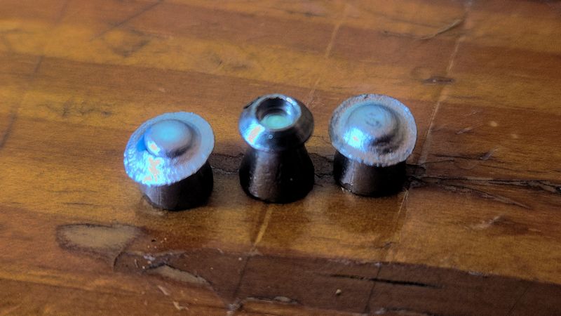

Firing them into modeling clay produced extreme expansion and hollow point separation, with the skirts penetrating a few inches more than the shed hollow point ring - about 2.25" for the hollow point and 3+" for the skirt consistantly.
So I fired 2 into the play doh block, 8 pumps in the Benji @ 30 feet. Cutting the block open revealed identical penetration (3.25") and complete expansion WITHOUT pellet head separation.

Anyway, here's a picture of the ballistic Play Doh test.
