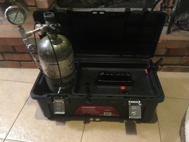

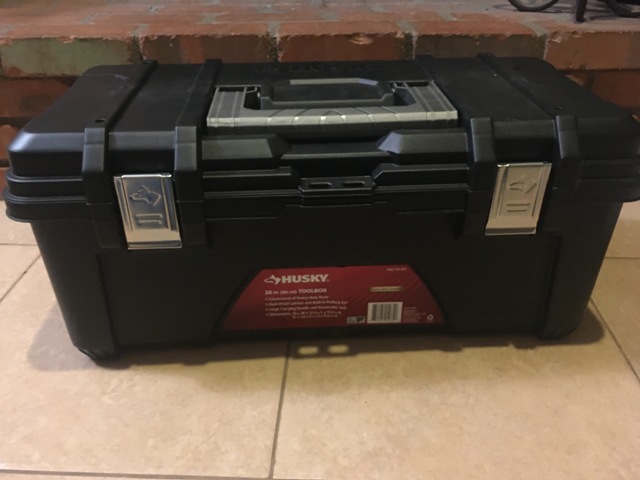

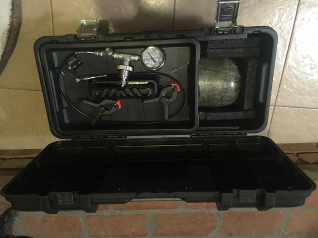

I have been researching the forums about cases for SCBA bottles and have seen some pretty nice packs and crafty DIY set ups. I ended up going the easy route and picked up a 26 inch Husky plastic tool box at Home Depot for $19.99 that seems to work for me. I like that I can lock it when grandchildren come visiting and that I can throw it in the back of the SUV and not worry about the bottle rolling around and can place other stuff on top of it. I use a couple of clamps to secure the inner tray to help hold the tank upright when filling my gun. I also put a pellet foam square with the round cut out under the tank when it is vertical. I place some other pellet foam squares on the side of the tank and under the tank when horizontal. I haven't glued those in yet, but I will when I get around to it, or maybe not , don't judge me lol!
I looked at a few other 26 inch boxes including a Craftsman at Lowes and a Keter at Walmart, but the Husky was less expensive and a bit taller that allowed the inner tray to rest above the tank. For reference the Drager 45 tank I have is about 21.5 inches long and 6.75 inches in diameter.

Great, happy my post was useful! Just got my tank in operation last week after getting it hydro tested and getting the new fill station in the mail, sure is a nice contrast from using a hand pump. I just barely crack the valve on the Drager and it is very controllable to get my gun up to pressure and shut it off. On the negative side I will need to find a new upper body exercise to replace that last 500 lbs of hand pumping🤔.
