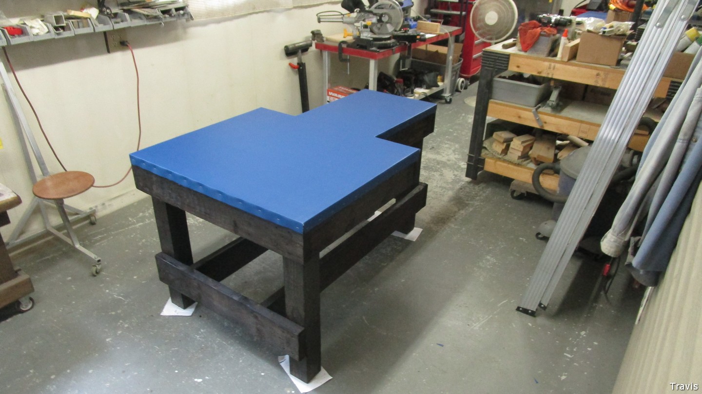

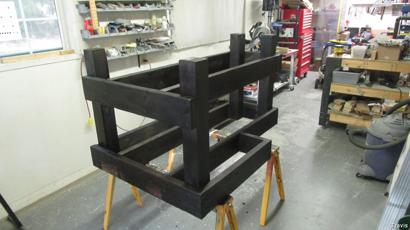

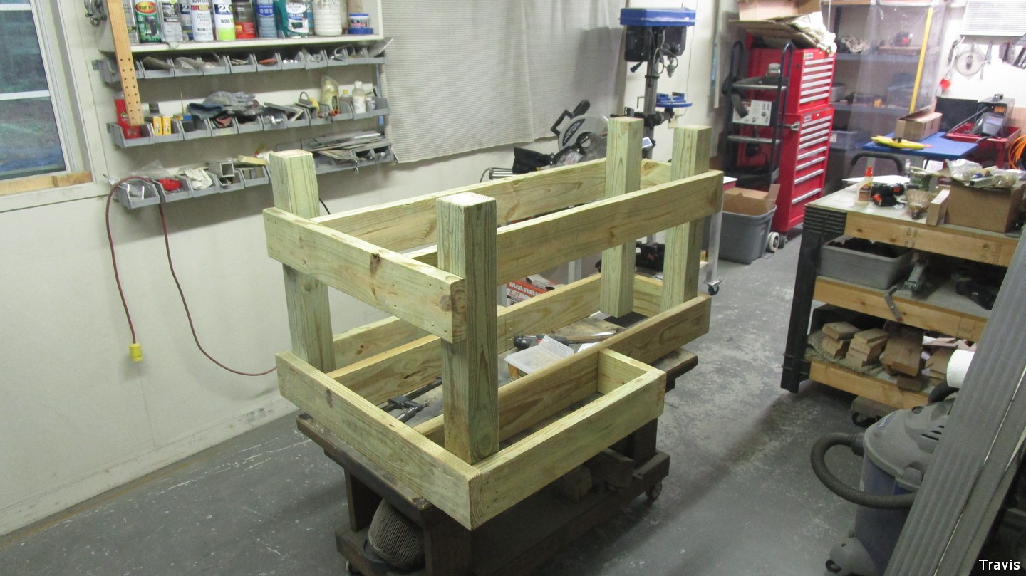

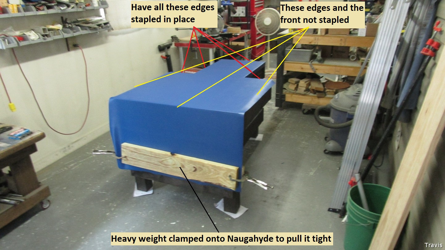

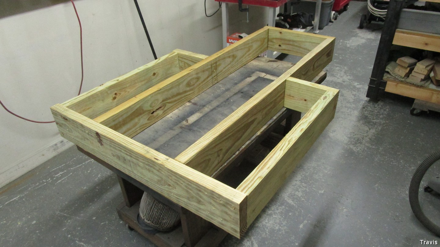

Hello everyone,
At the request of @EPG I am sharing my drawings for a Shooting Table / Benchrest that I designed several years ago. Please note this is not a “Set of all inclusive plans”, but instead they are the plans that I drew for me to use to construct my Bench. A few changes are noted and a basic bill of material is included, but screws, bolts, top material, etc. are not denoted. I believe most questions can be answered from my own construction photos attached, if not please let me know.
ThomasT
View attachment 344968View attachment 344969View attachment 344970View attachment 344971View attachment 344972View attachment 344973View attachment 344974View attachment 344975

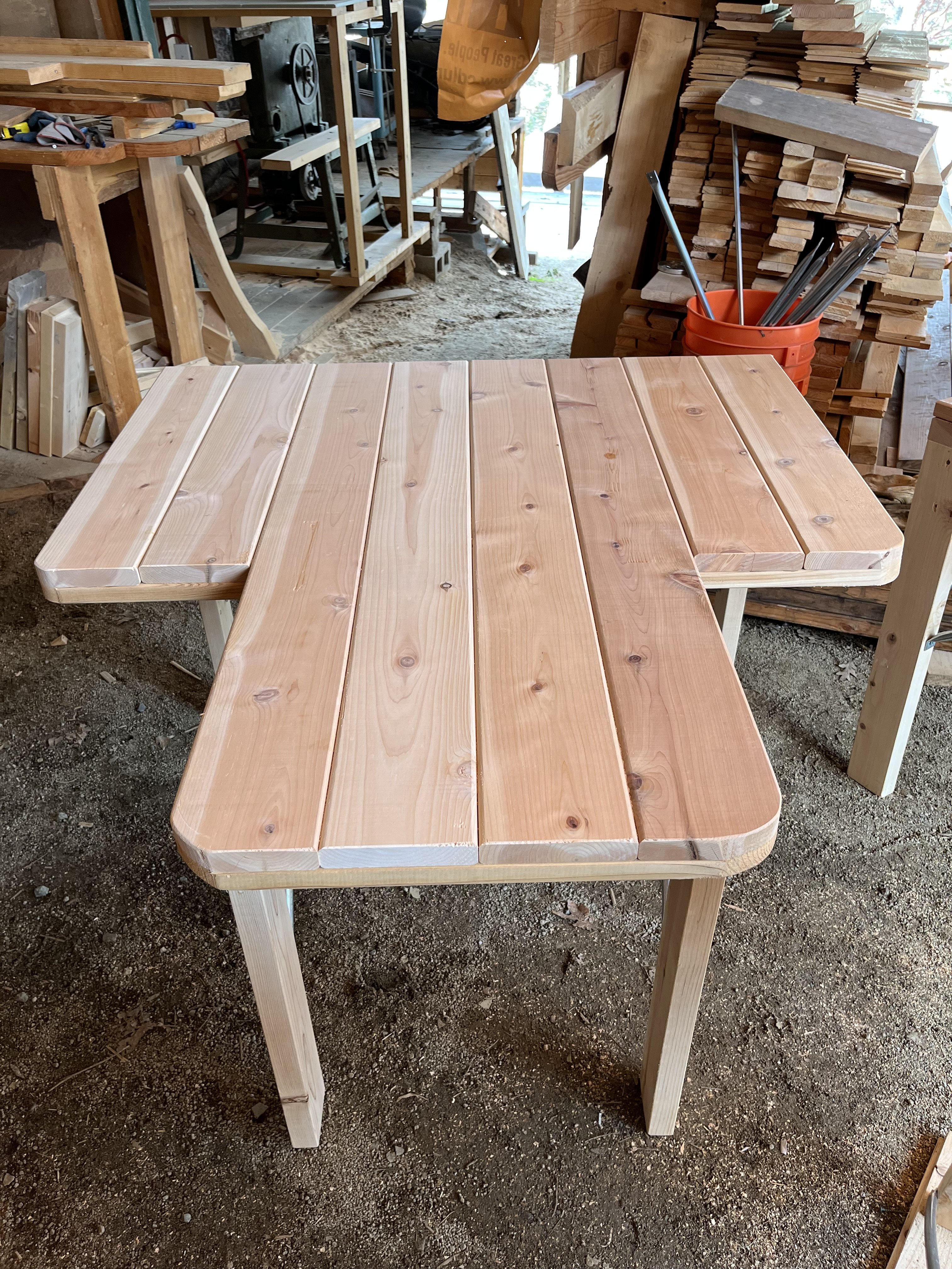

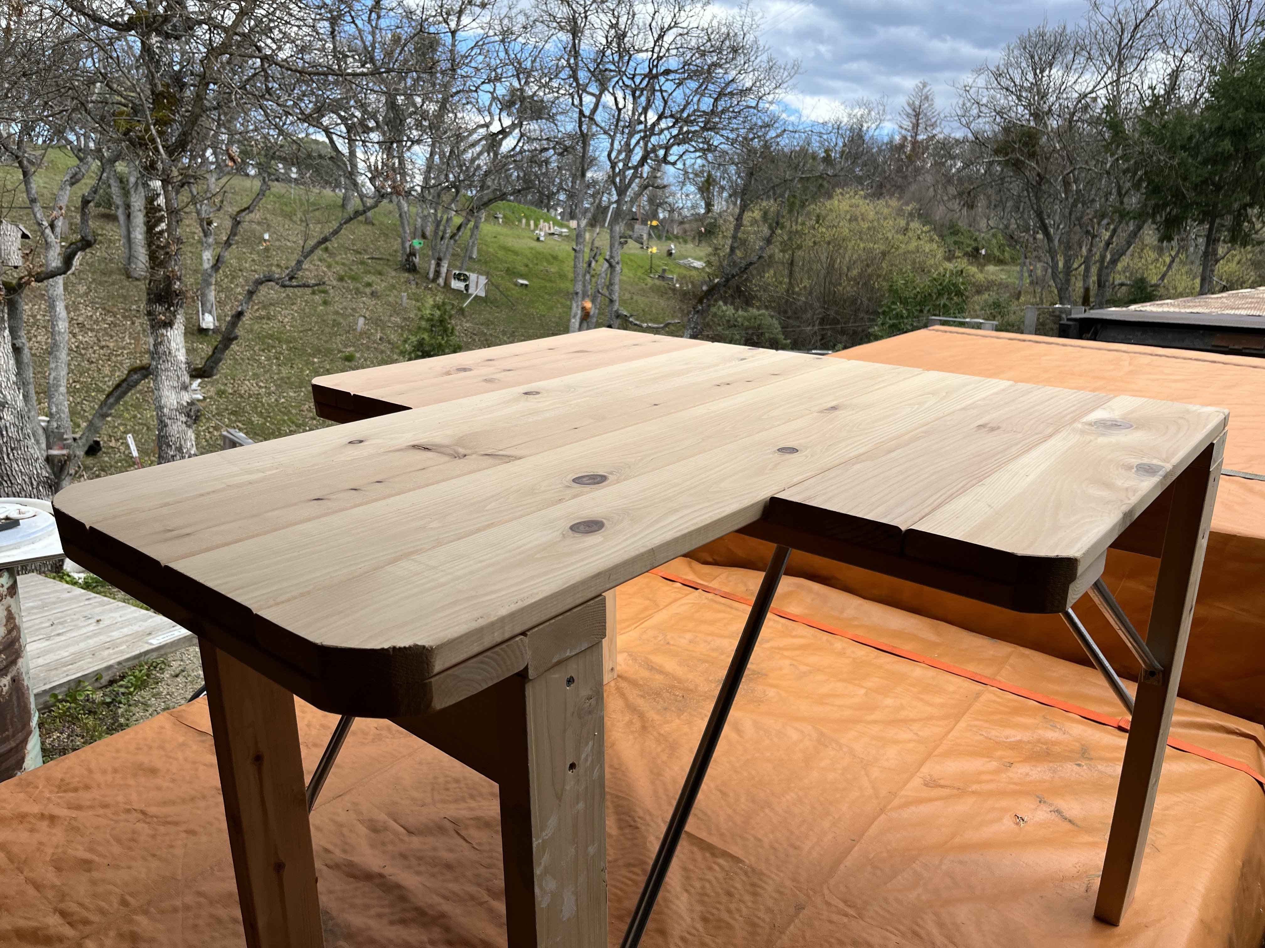

Here is a design I came up with for the additional benches I'm making for the upcoming AOA & AirGun Oregon Extreme Challenge on the 27th-30th of this month. They are very solid and your knees fit under it any place you want to sit at it.

Hello @Airgunoregon
Those are beautiful. What kind of wood ?
ThomasT

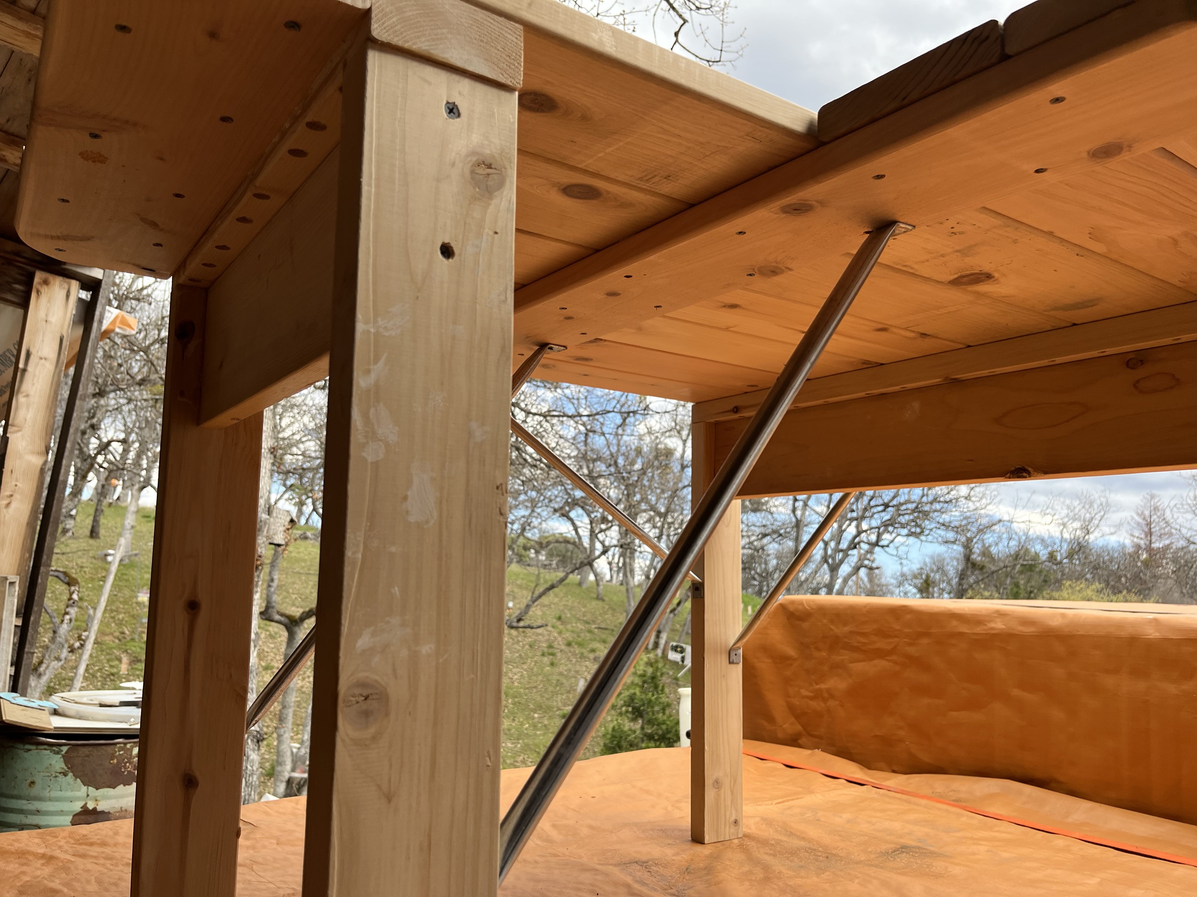

That's kiln dried Incense Cedar 5/4" decking on top and kiln dried 2x4 Incense cedar for the frame work. The bracing is 1/2" electrical conduit with the ends smashed flat and holes drilled for screws.
