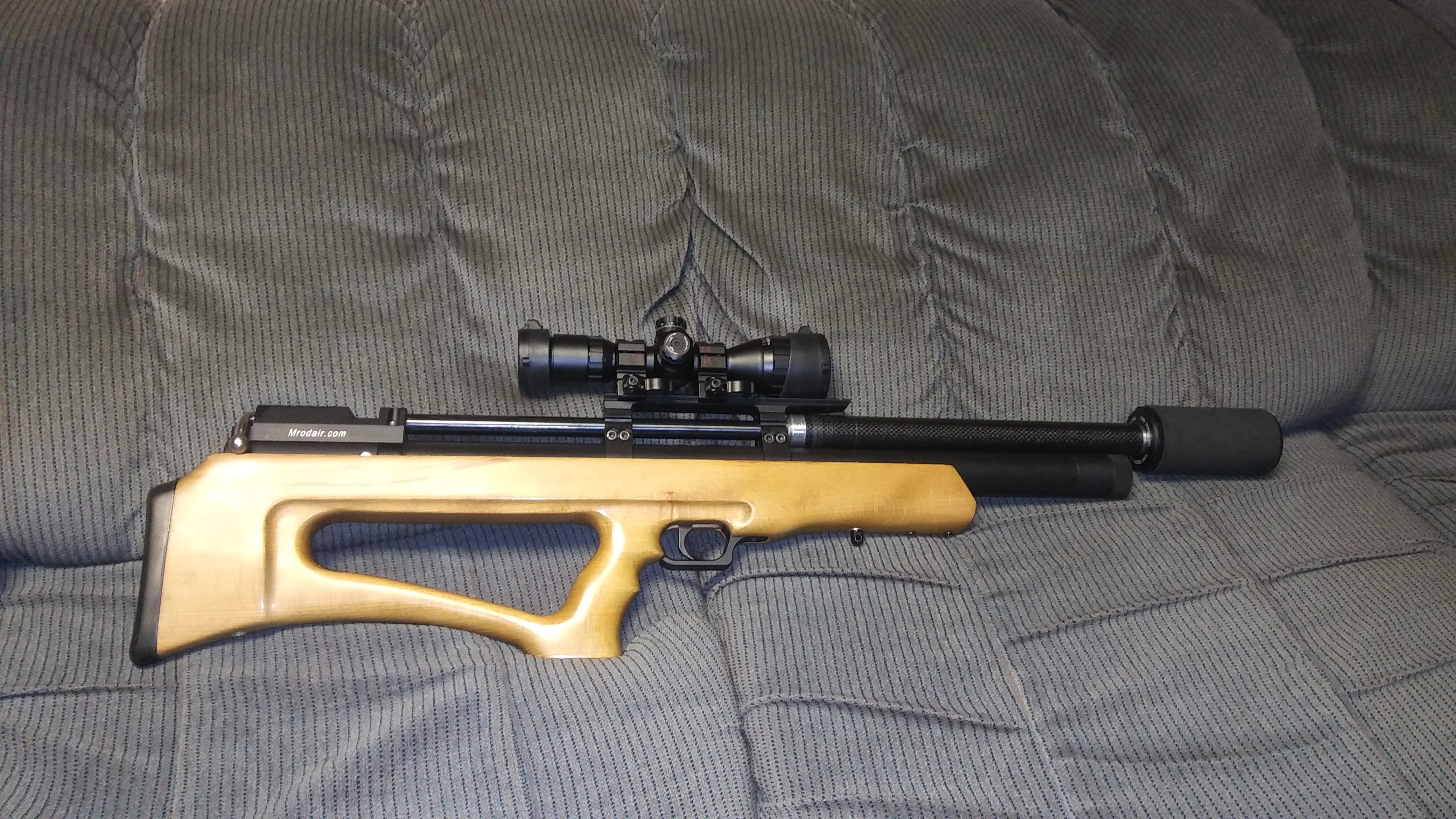

This has to be the most boring stock ever. I checked into hydro but that costs more that the gun is worth. Sand it down and stain it, still boring with the arrow straight grain, paint, bed liner? what do you guys think.

I usually like an oil finish best. The grain on this thing is boring. Forgot to put the pic in there....oopss
I usually like an oil finish best. The grain on this thing is boring. Forgot to put the pic in there....oopssView attachment 360792
That looks like a plain canvas and ready for
Fake tiger stripe wood grain?
I would practice on a piece of scrap before attempting

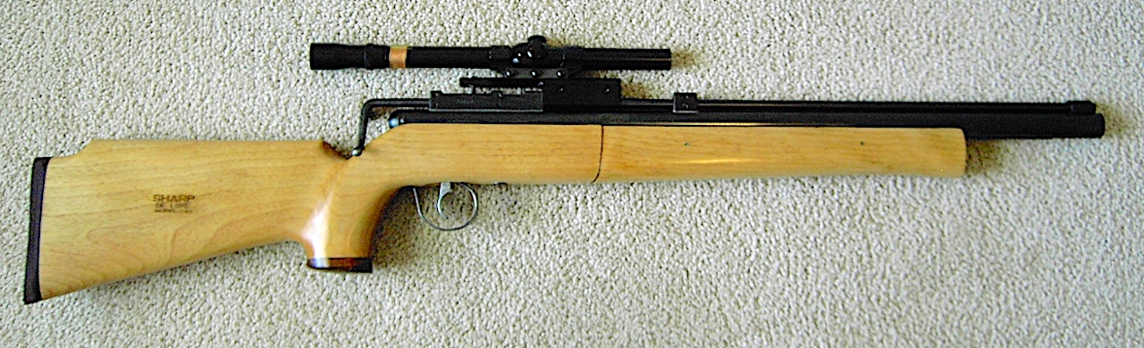

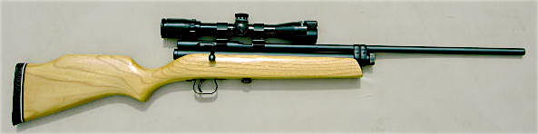

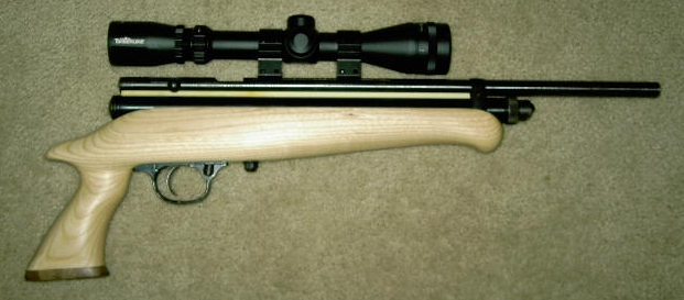

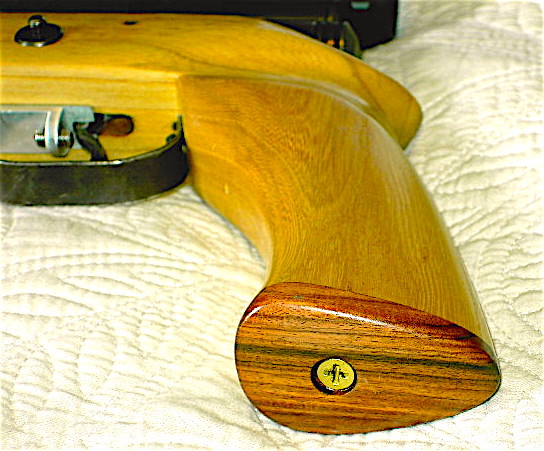

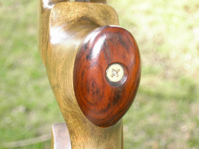

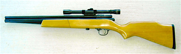

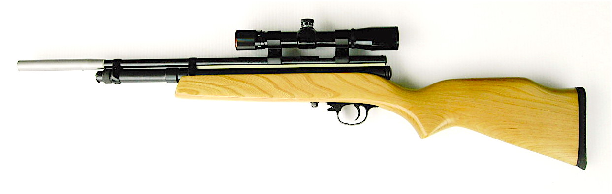

Without seeing it, hard to even say if the mystery gun is even worth considering any upgrade; much less all this worrying. However, assuming it's a white-wood stock, sometimes there is some level of grain personality hiding beneath walnut-'stain' PAINT. I've often stripped such stocks and elected to forego attempting to re-stain them before applying a SUPERIOR clear finish.
One way to dress up a plain stock is to add a grip cap, and/or rubber butt-pad, walnut or snake-skin adornments, and or reshape the stock to a more aesthetic shape. Some of my efforts to improve the aesthetics of walnut-'stain' PAINTED white-wood stocks-

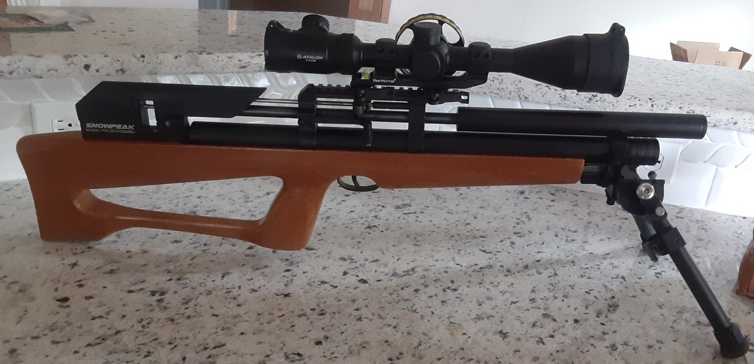

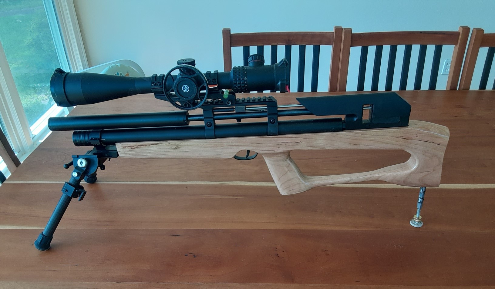

My P35s came with plastic stocks (talk about boring) and I recently completed the third wood replacement. I made the first of softwood scraps and ended up painting it black. I made stocks largely to get them to fit my long arms and big hands better. I needed about 1.25 more length of pull and the grip pushed back 3/8ths of an inch or so. But wood is also nicer and lighter in this case. I'll add the mahogany and cherry ones picture. The mahogany is plain grain but nicely dark. The cherry will get darker with age and has a bit more character. But the wood is not figured like you sometimes see in maple, cherry, and walnut (really it happens in all types of wood but is more common in some). The cherry will probably get darker than the mahogany but it takes at least months for that to happen. The top of the table the cherry stocked gun is on is cherry.
