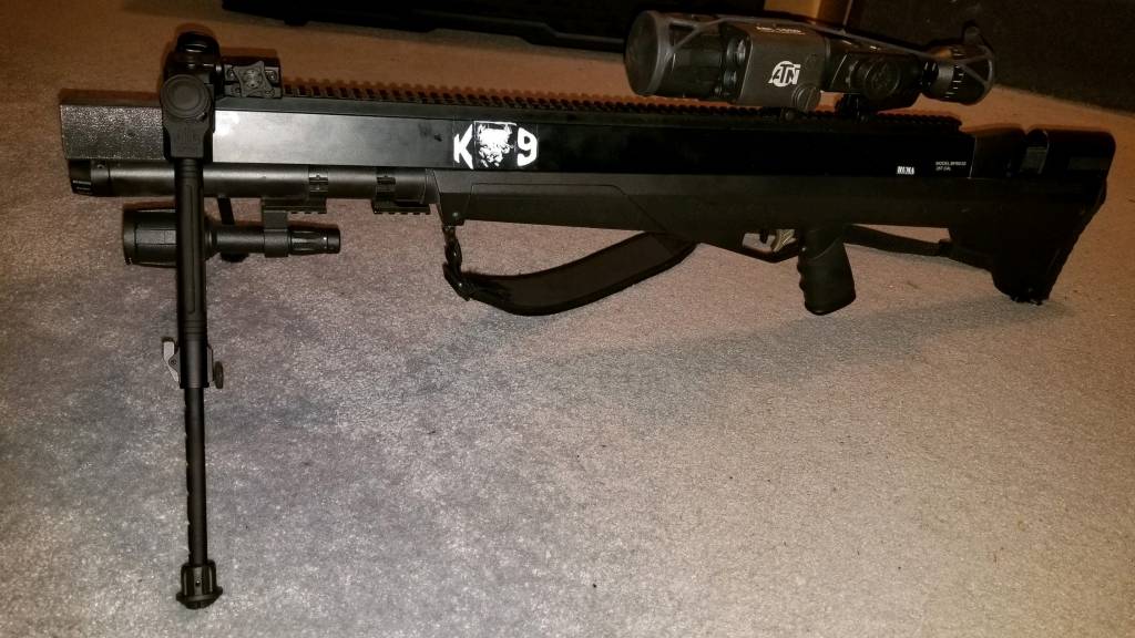

You guys are doing a great job. Numbers are looking great. I find it almost just as much fun experimenting with the gun and tweaking as much as shooting it at random targets. How long are your air tubes if you don't mind me asking? Mine is flush with my PITBULL moderator as you can see.
