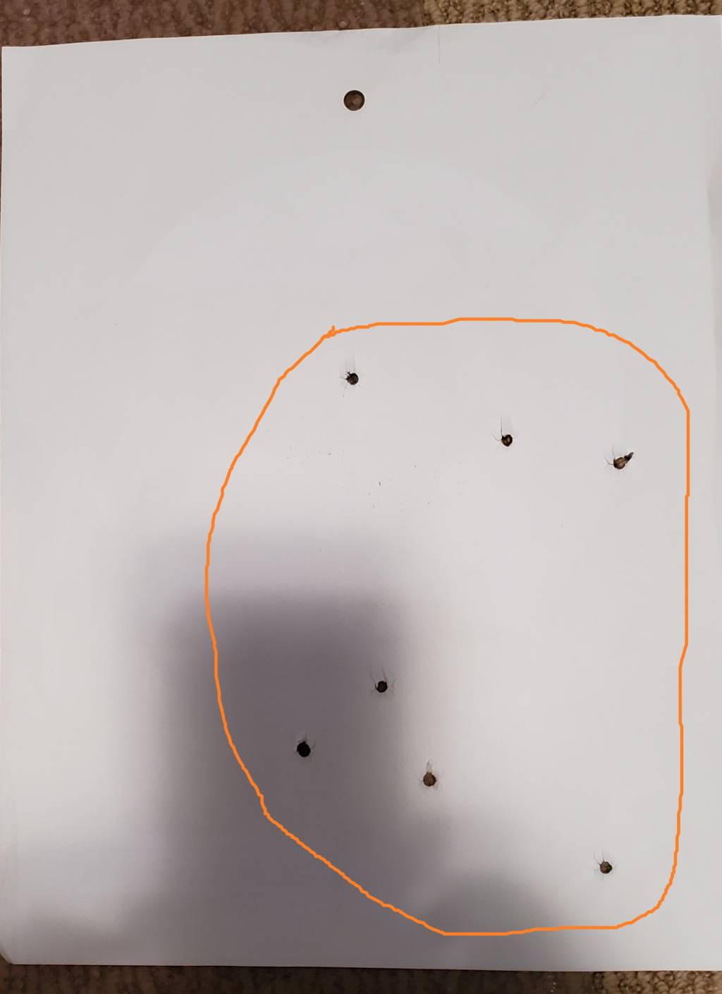

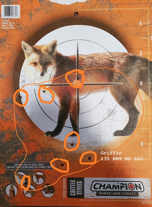

At 100 yards with full charges I am getting:
Griffin 135 Grain BT HP LDC, 8 turns back on hammer spring cap 909, 912, 921, 932, 919 fps (average of about 250 ft. lbs) and a couple of unregistered chronograph shots, 8 shots, 8" center to center at 100 yards.
Another shot string of using Benjamin eXTREME by Nossler I got about the same spread, from a bench, using a bipod.

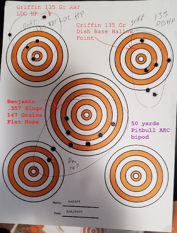

At 50 yards I was getting:
Switching to Griffin 135 boat tail hollow point low density core 5 shots 2.25" @ 50 yards
Switching to Griffin 135 Dish Base Hollow points I got 2.75" spread over 6 shots at 50 yards.
Using the new flat tip Benjamin (new to me anyway) 147 grain I got 3.75" at 50 yards. Two shots were not picked up by the FX chronograph, but those that were were: 919, 912, 916, 902, 900, 898 for about 260 ft. lbs of energy. On this one however I started shooting some light ammo as well, and the shots are all mixed up on the target, so no photo.
I cannot say I am impressed. My results are not out of line with this pitbull video (https://www.youtube.com/watch?v=wKXEekVtbVE) but it is worse than I was hoping for, and I do not think these sorts of results are conducive to taking coyote, or deer (which is only legal in some states but not mine as far as I can tell, so it is a moot point) beyond 50 yards.
I don't think I'll take a shot at 100 yards at a coyote, certainly wouldn't take a shot at a deer, at least not until I figure out some magical combination of hammer spring and ammo.

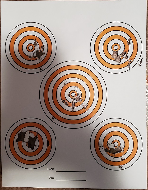

In comparison, this is an FX crown MKII in .25 off a folded up winter jacket used as a support for my hand (no bipod):
While not great, not bad for 16 shot strings, and I was fairly happy with the 25.39 grain pellets, though the bottle placement on the crown is starting to annoy me a bit. (The JSB Knockout slugs in .251 33.49 grains I tried today were all over the place, I am not sure what is up with those, I think I need to get a slug barrel or something, even though the slugs were less than the 34 grains others told me I could use on this barrel.

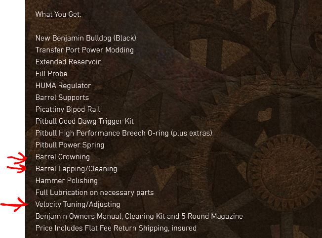

I got a pitbull Texas edition, which I am told is just the pitbull AKC with accessories. They have since taken down the page for the long range texas edition
Well, according to this, the pitbull AKC includes: https://www.pitbullairguns.com/product-page/pitbull-akc-357 (archived here: https://archive.ph/yIv6f)
The barrel is supposed to be crowned. But while cleaning tonight, I looked down the adapter hole and barrel with a flashlight, I don't see what looks like a crown. I am not an expert though so maybe it is there across the whole barrel lip, or more subtle than I was expecting. I was expecting to see a chamfer, but I see on youtube some people do the whole front face of the barrel. Also the bolt's air passage cutout at the end may be giving me an optical illusion that the barrel is not perfectly straight, but since I cannot look right down the center since I am also shining a flashlight I assume it is just an optical illusion.
