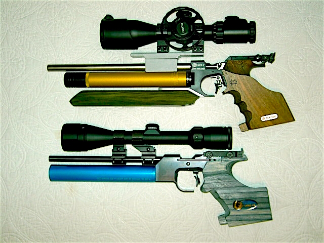

Benelli Kite ten-meter pistol with barrel-mounted Leupold Gilmore red-dot scope. Red-dot sights work fine for taco hold or arms-length.

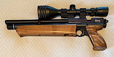

My 1701P with 6X Burris Mini rifle scope. Taco hold only-

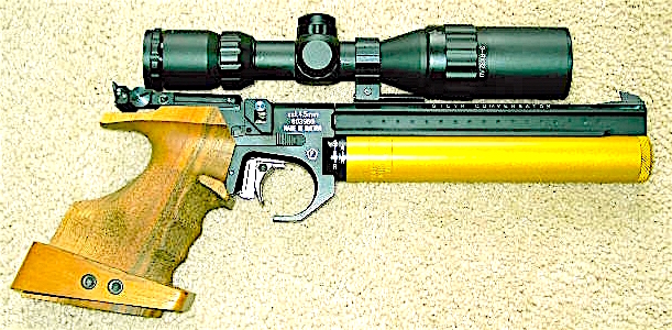

Steyr LP5 with 3-9X Bug Buster rifle scope-

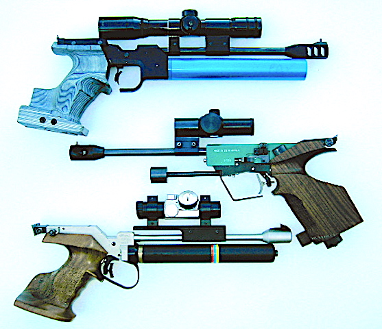

Rifle-scoped Zasadny-modified Steyr LP-1 and Tau MK 08-

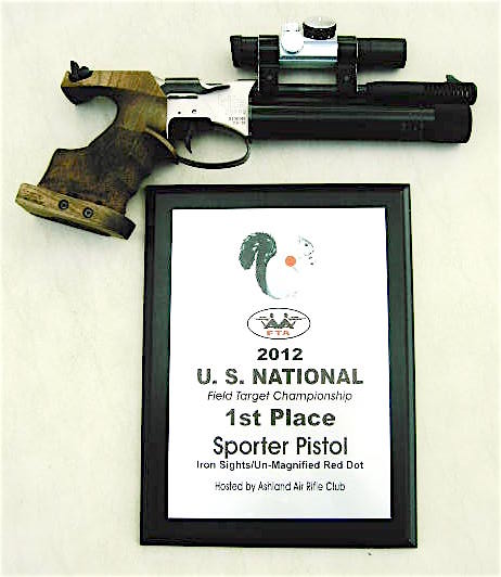

Tau MK 08, Brno Chameleon, and Walther CP3 Match. Very few ten-meter pistols are easily scoped.

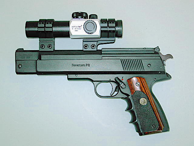

Beeman P2 SSP-

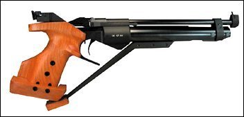

IZH46M is a great pistol for silhouette or 10M. For mine, had to carve on the grips a little as they irritated a bony point of my hand, but not difficult. Accuracy is about as good as any with good sights and trigger. Easy to pump. Be sure to oil the slider with a drop every 500 to 1000 rounds, and the pivots less frequently but don't let them dry. Crosman Pellgun oil is fine.

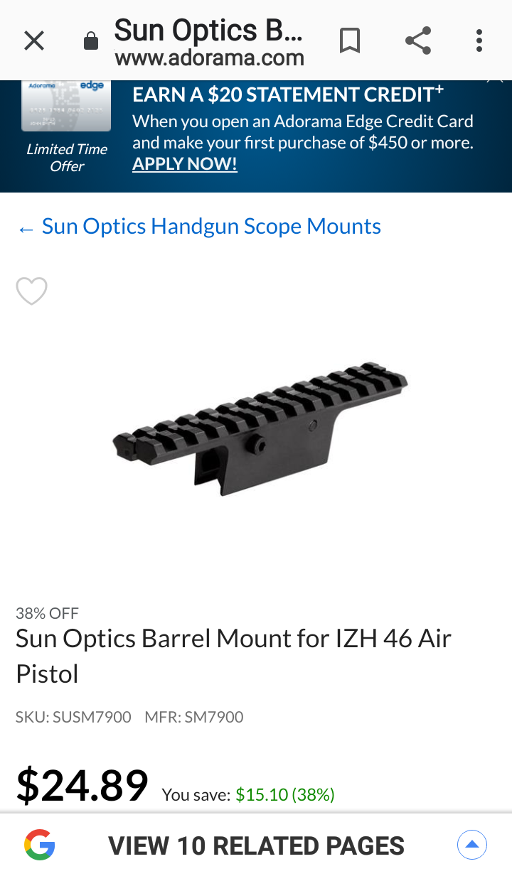

After some online research I see that B Square made a rail mount for the Izzy that has since been discontinued. Probably because the Izzys are on the no import list. That being identified, the listing I found for the Izzy in Texas may be a mirage since the only ones that can be sold new are units imported before the ban. I’ll have to make a call to find out if it’s really available.
Any ideas on a mount that might work for a reflex sight that is still in production?
Corky

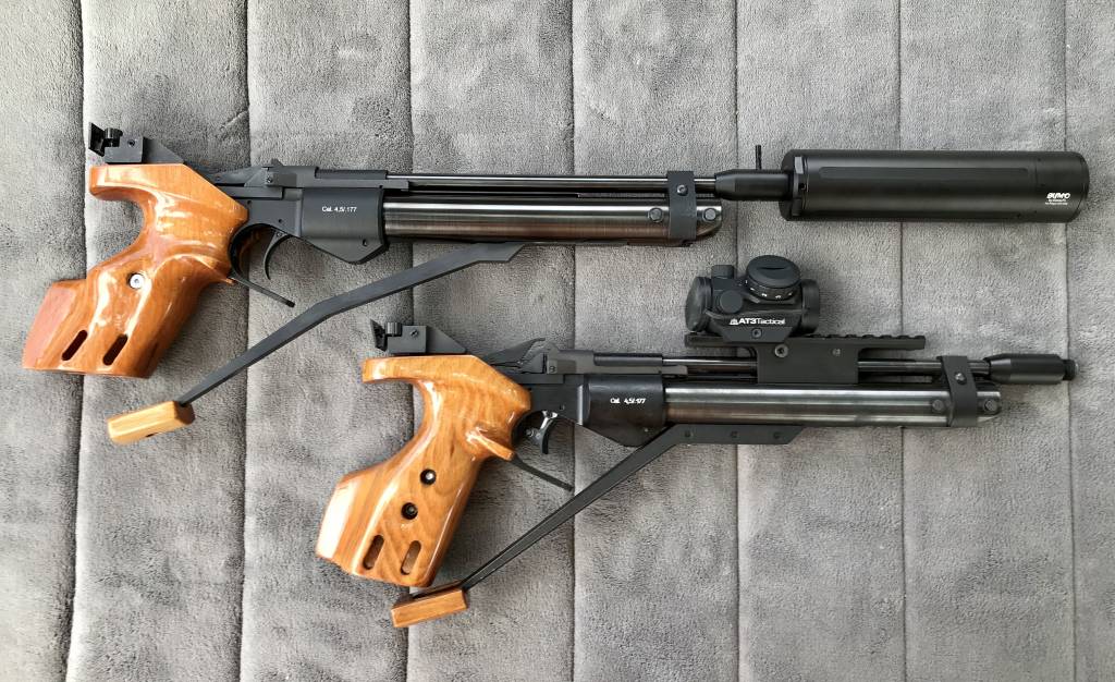

I purchased a Sun Optics IZH picatinny rail mount like YO shows above in May 2020 from D&L Airguns in Canada. Great service and would give them a thumb up!
I just went to their website and it is still listed for sale......link is below:
https://dlairgun.com/collections/sun-optics-mounts
I'm currently using the AT3 Tactical RD 50 red dot (with Sun Optics mount) on one of my IZH pistols, iron sights on the other. 2 MOA dot works great; doesn't cover up small silhouettes.
