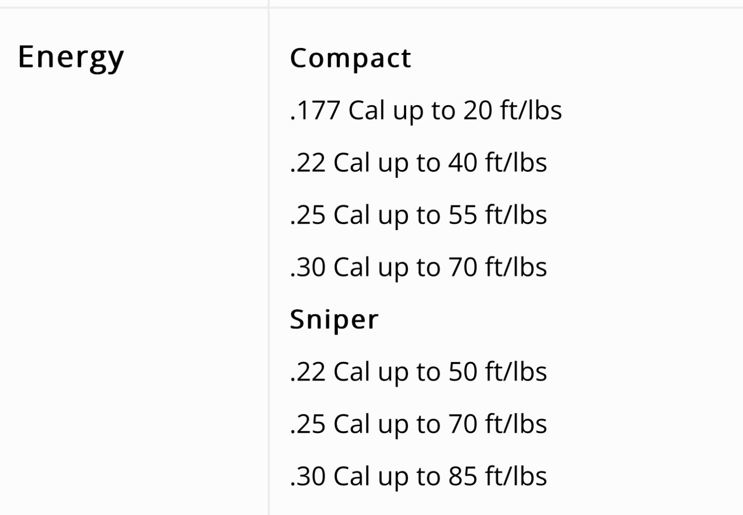

FX Wildcat MK III compact. 27 inches long. I just bought a very nice used one from a member for $1000.00 with extras. They come up here every so often. Here is a photo and the power specs from FX.

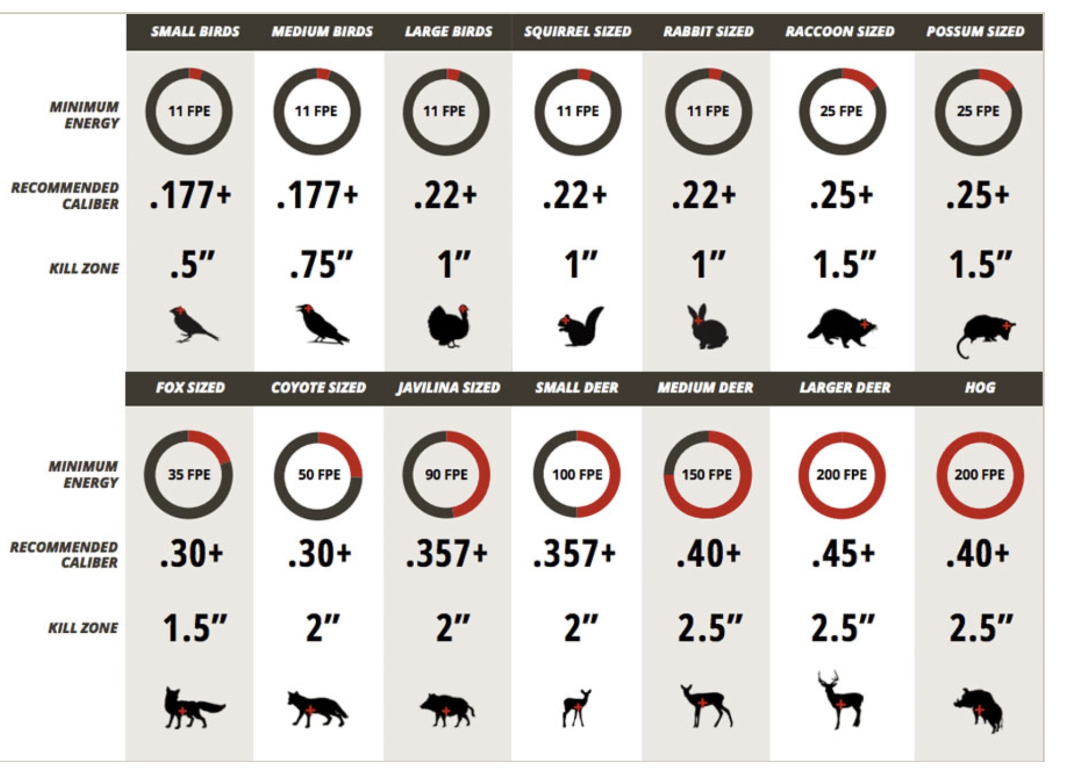

Use this chart as a guide of what you need to hunt the game you desire. There are videos of hunters taking small hogs with 55fpe guns with head shots. If you are wanting to do body shots you should probably go with a .35 caliber.
