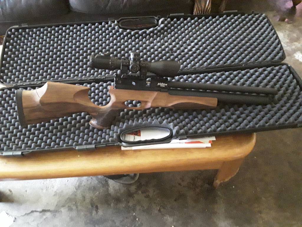

Well, I've had this rifle for a week and am just now being able to test it. I did a quick video documenting my review. Disclaimer: I'm no professional when it comes to this stuff, so this is a pretty much what you see is what you get! You are seeing it first hand, at the same time I'm seeing it for the first time, so I hope this provides an unbiased first look of the Pishtov regulated long gun!
https://youtu.be/9kJP9bh4BbM
As you can see, it started off a little rough, but with only 40 pellets down the barrel, it is showing some promise! Here are the Chrony numbers for the 14.3 Crosman Hollow Points:

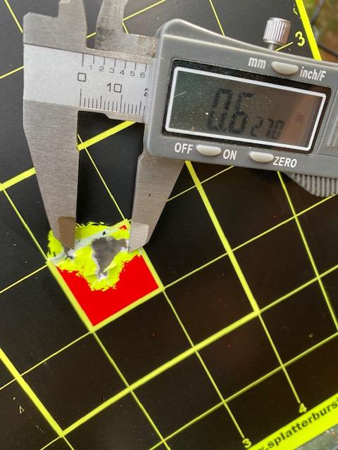

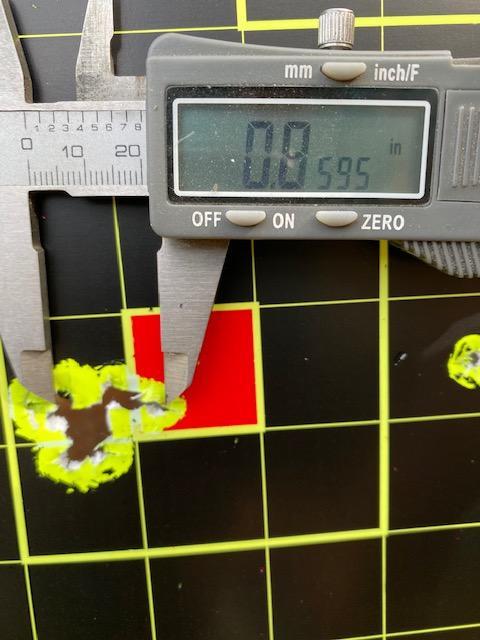

The JSB Jumbos resulted in much tighter groups. The first group was .895" center to center at 40 yards. The second group was even better at .623" center to center at 40 yards.

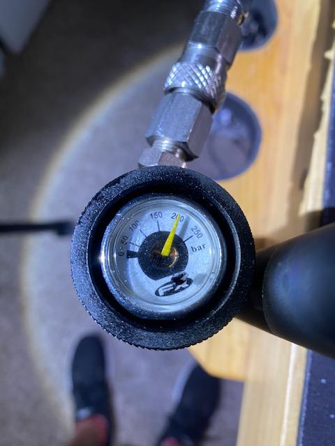

I have topped it off at 200 bar and will let it sit over night to see if it loses any air.
I apologize for the rather crude, unrefined video, but it is what it is! LOL! I will report back how well it's holding air tomorrow!
I did a shot count this afternoon. The neighbors weren't out, so I squeezed in an 80 shot string using JSB 15.89 grain Jumbos. The was still sitting at 200 BAR after filling it yesterday afternoon, so this is a very good sign! 80 shots took it from 200 BAR down to and Exact 100 BAR! How often does that happen? I have no idea what the regulator is set at, but it was giving me pretty consistent readings right up to the last shot! I could probably get another 10 - 20 shots with the same accuracy, but for me 80 is acceptable! Here's the shot string:

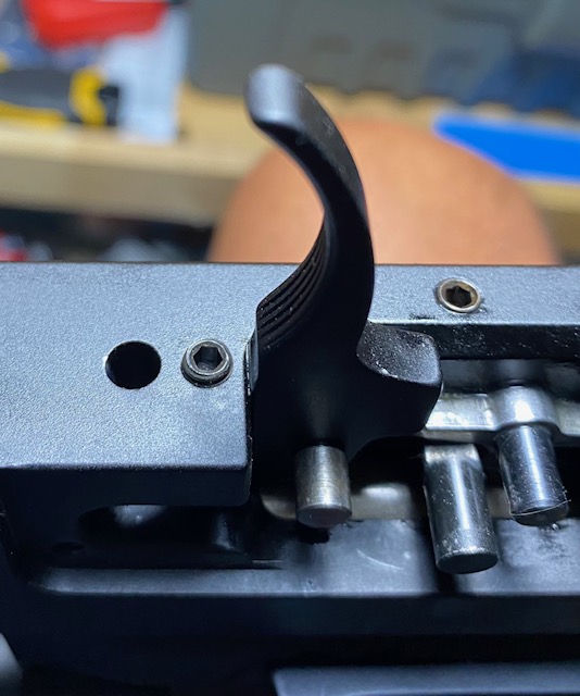

I did some trigger work today. Not much can be done, but what little I did do have a tremendous return! There is only one adjustment and you have to remove the stock to access it.
It's the grub screw right in front of the trigger and it just adjust the tension on the trigger weight spring. I backed it off about 4 turns and that alone made it much lighter.
The trigger assembly is accessed by removing the cover that's held in place by two screws. That whole assemble was bone dry and had a gritty feel. I blew it out with compressed air and added a shot of silicone gel. The lube really smoothed things out! The combination of these two small changes really made a difference in the feel and performance of the trigger.
