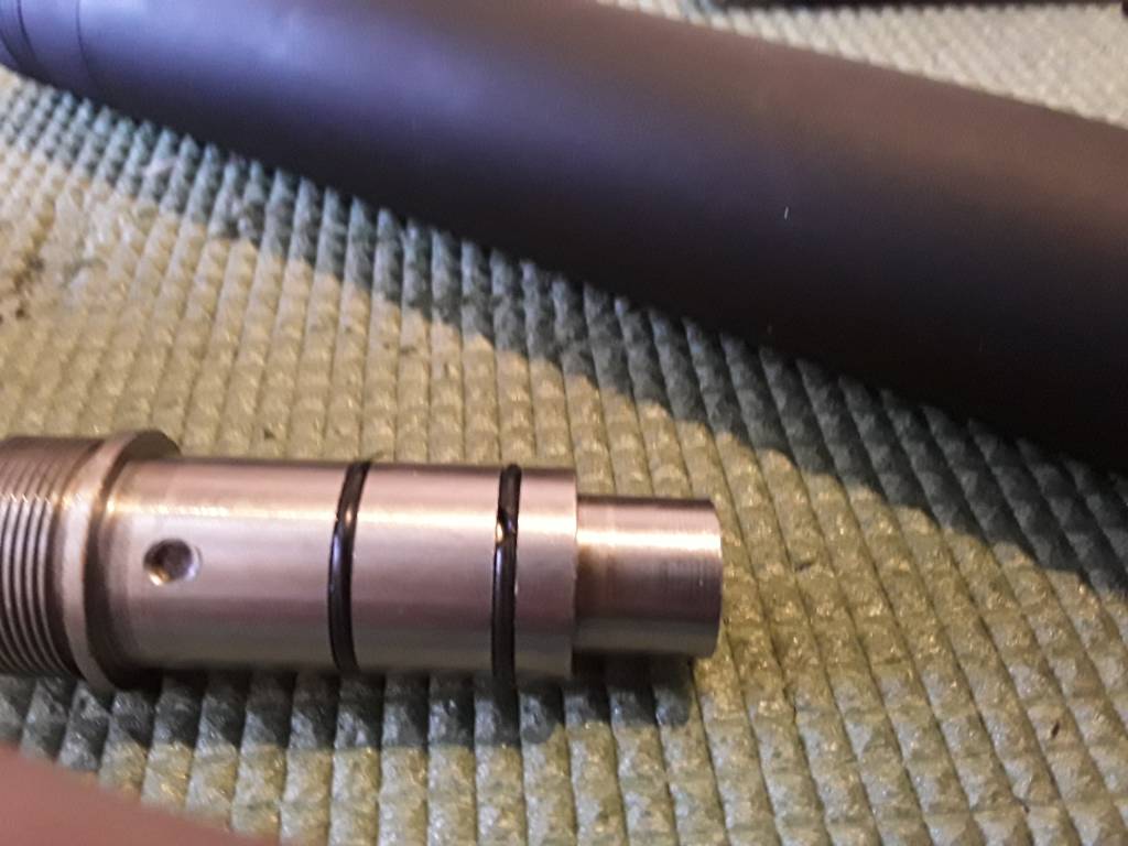

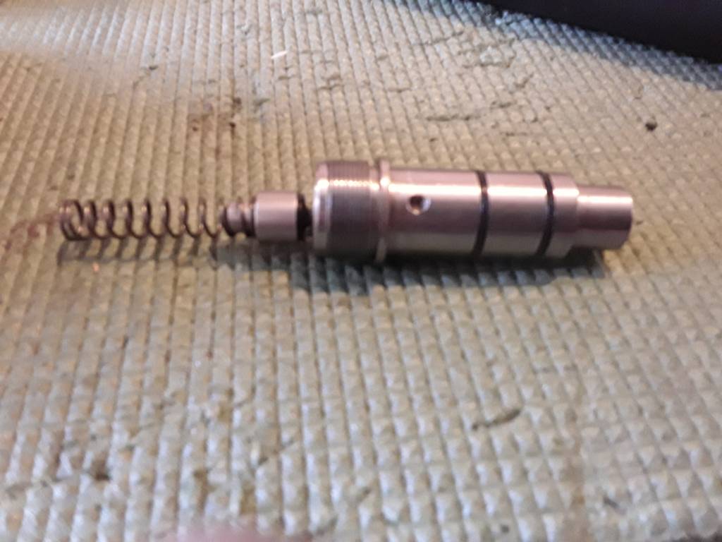

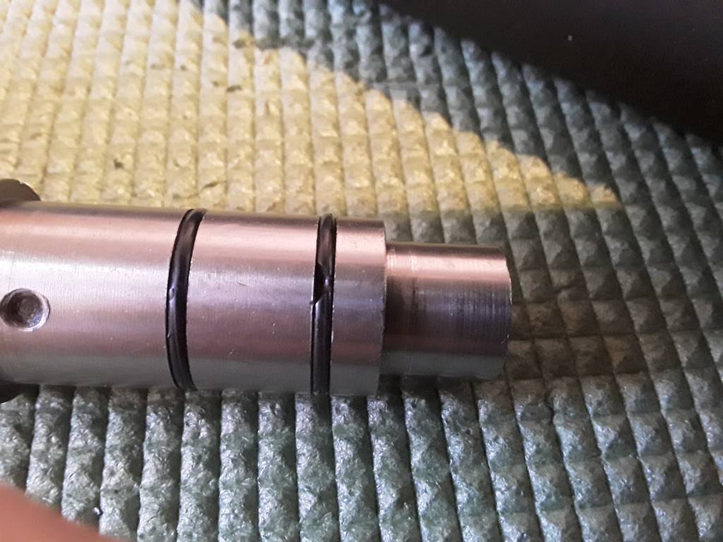

I found out why my ras3 was leaking, a chunk out of the oring on the regulator.
That doesn't look like a regulator. Looks like the actual valve body. Does the valve stem comes out of the end of that? If so and it goes in to the breech then that o'ring can't cause a leak. It just helps prevent air during the firing cycle from entering the breech and forces it into the transfer port.
