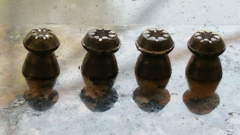

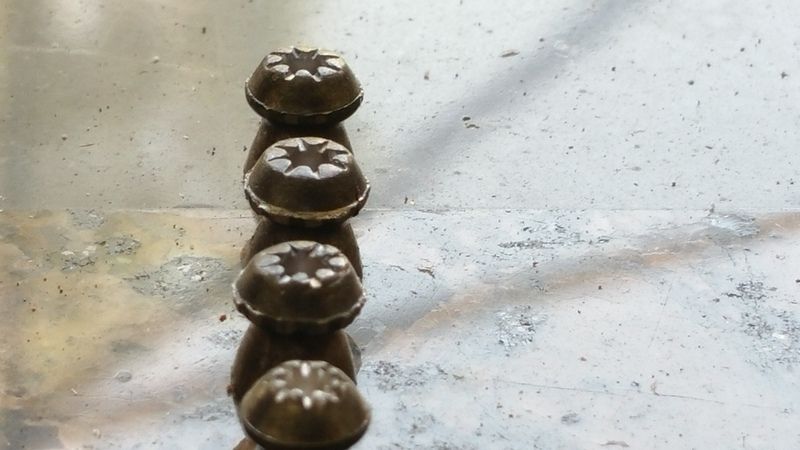

Well I have the results from the five gallon bucket expansion test. This was done with a full five gallon bucket filled with water, shot from my Air Wolf from a height of 8 feet from the muzzle to the water.
You should be able to tell which pellet is the original and which one's were shot. I made three shots. The original (from the tin) pellet had a head size of 5.34. The three shot pellets had head measurements of 5.55, 5.61 and 5.68. Not much expansion. Here are the pics.
