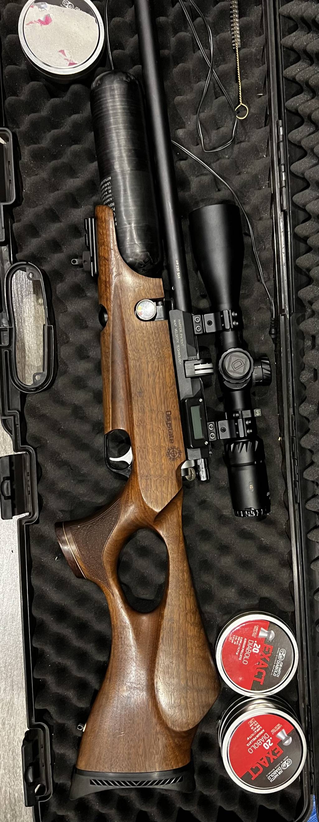

Hi Hogsnatcher.
I have an Airwolf in .20 (FAC power - 18 / 24ft.lbs) and it had a very heavy metal tank
on it. I have recently replaced it with a carbon tank and it reduced the weight a lot,
especially where uit matters most for the balance of the gun.
It is lighter now, but because the balance point shifted backwards, it actually feels
even lighter than just the weight loss (hope my simple explanation makes sense).
Have you got a metal tank, or a carbon one?
I'm still running the factory shroud and Carbon Silencer by the way.

Yes, I still have the heavy 500cc metal tank on the gun and it is a beast. I had no idea that the tanks could be changed out to a CF. I may want to swap it out if its not too cost prohibitive. What CF bottle is most suitable for Airwolf?
Ive been out of the air gun world for over 10 years and have just recently exhumed my interest..wow have things changed. Amazing some of the new guns and what they can do.
The standard 480cc CF bottle that you find on the red wolf, fx guns and evanix among others is a direct swap and we'll worth it, saving over 400g in weight.
Buy a bottle without any sort of additional valve.
Looks better and feels like a red wolf, weight wise. Then you can pick any pickle you like :)

Well you all have been very helpful in my effort to ‘update’ my now old AW. I was able to track down a 480cc CF bottle from Talon Tunes that will mate with my AW (M18..1.5 threads)…and it was on sale!! Now I just need to figure out my LDC situation for the end of the shroud, as I’ve never liked the look of a ‘nude’ shroud - ‘in the nude’ it needs a pickle.
