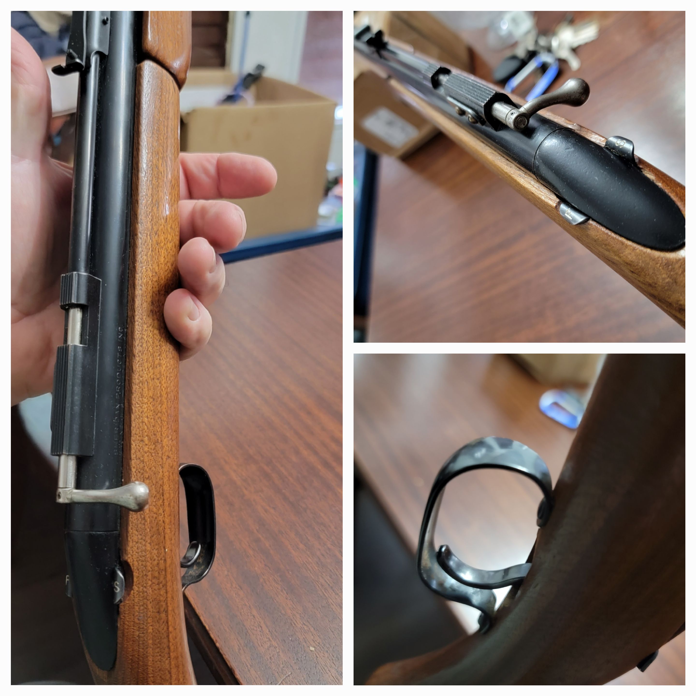

Picked up another Bluestreak!
This Sheridan is out if North Carolina!

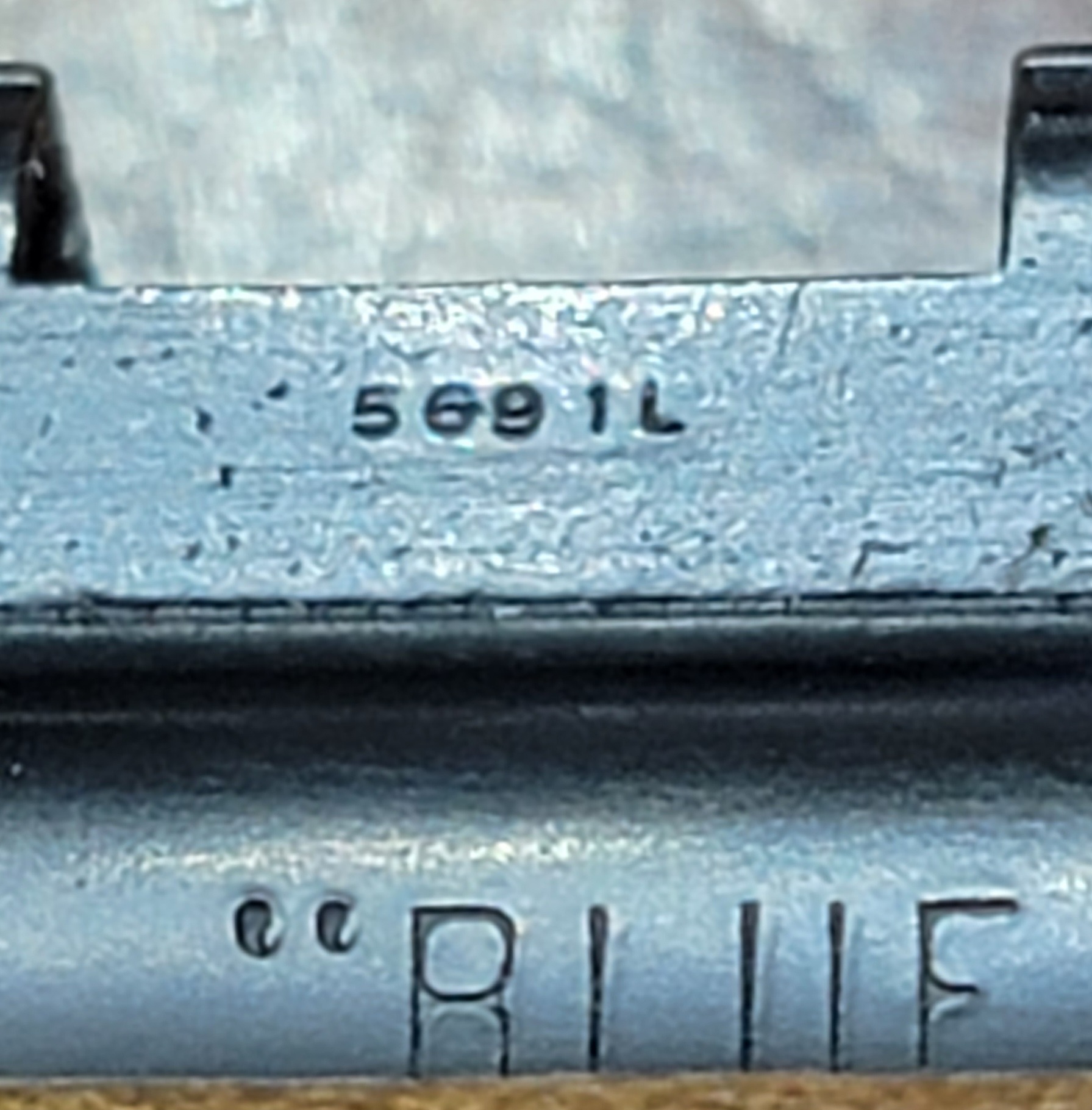

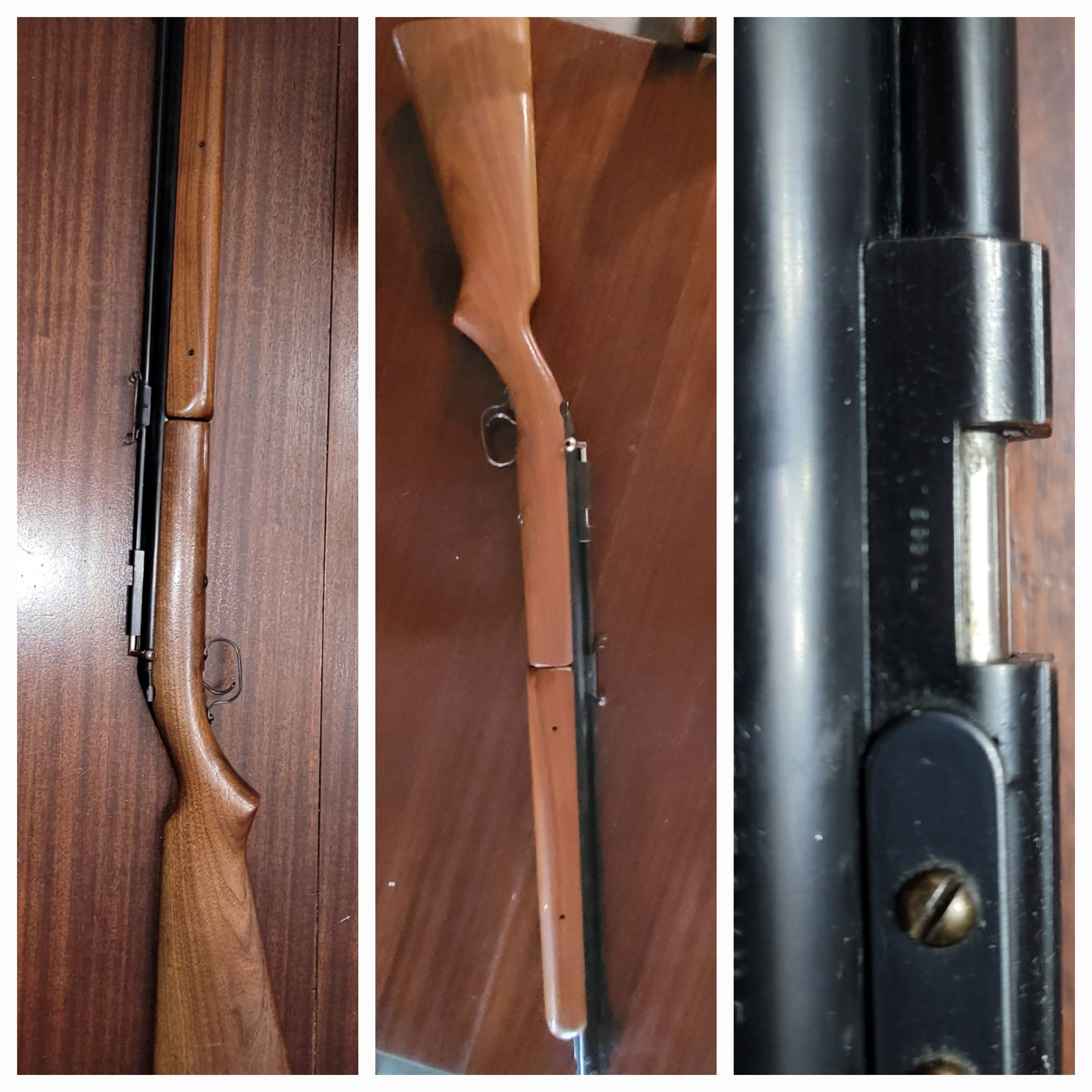

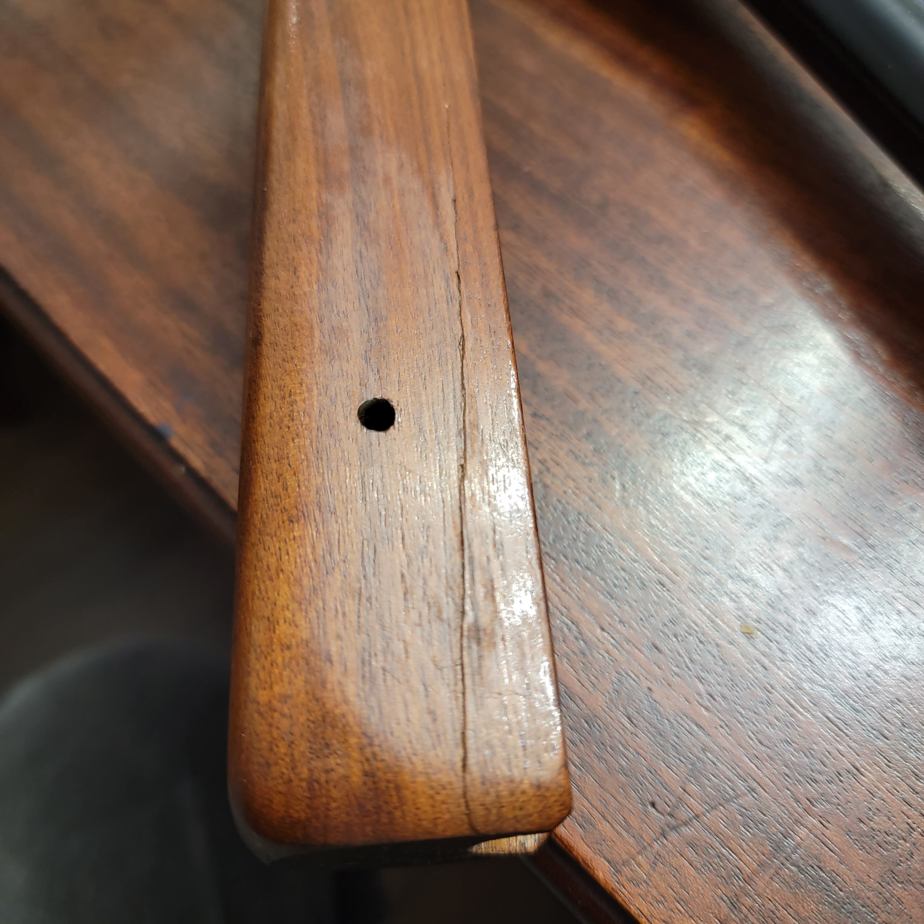

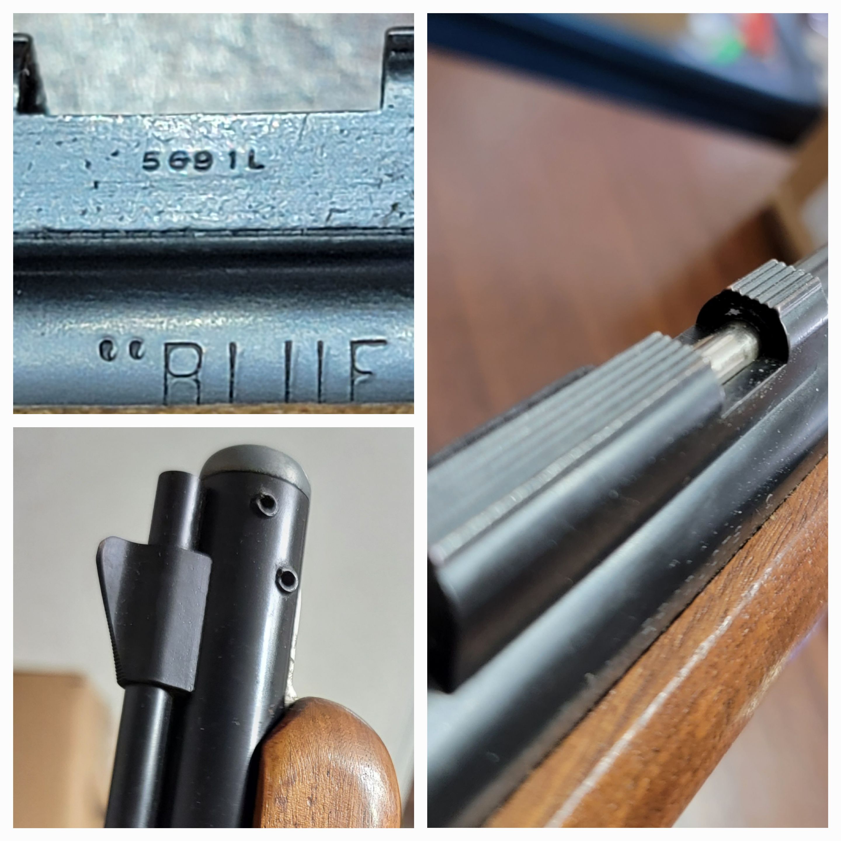

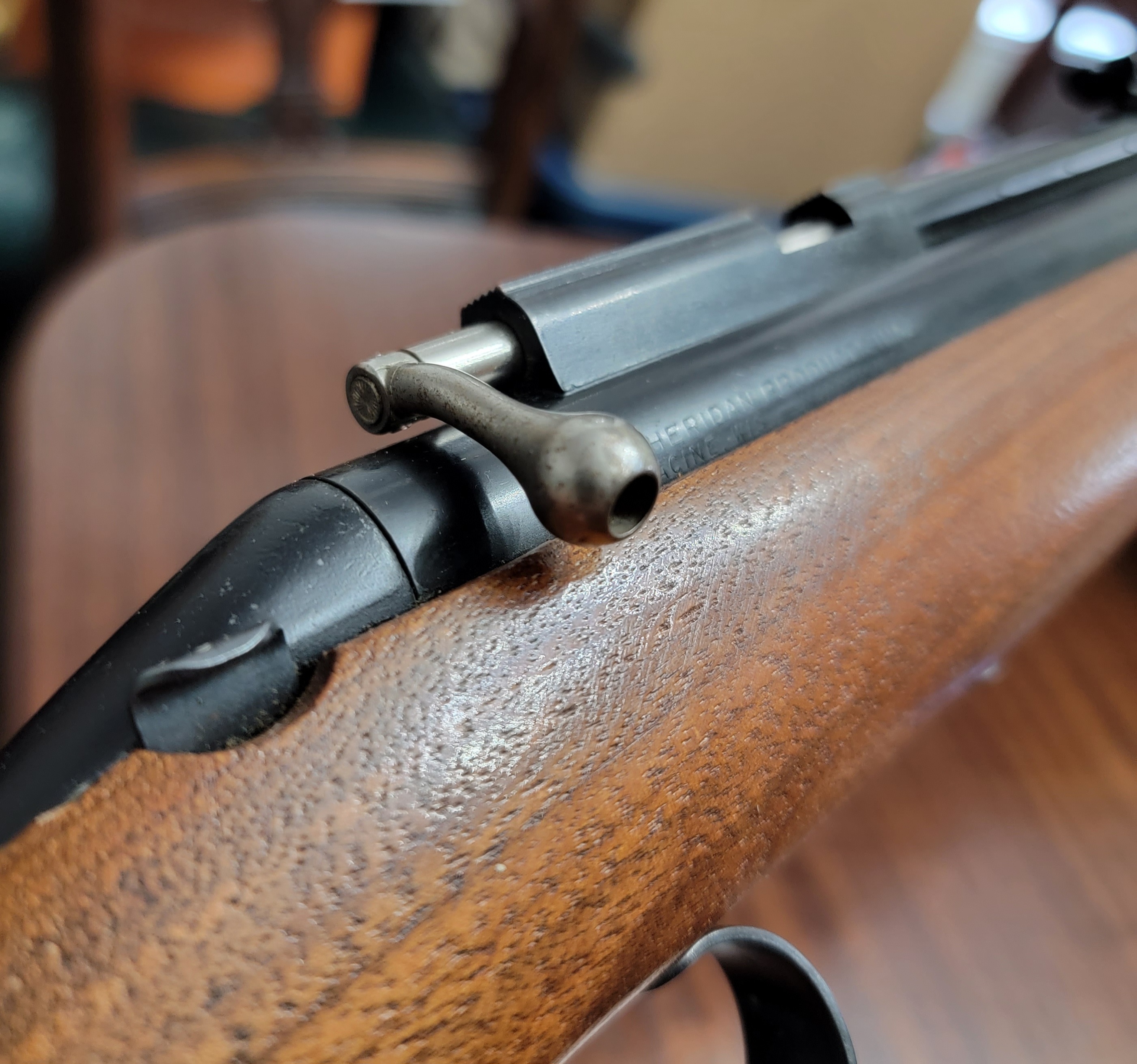

I spotted it at a pawn shop, with a pretty low quality photo. Although I don't think it was malicious, it was a bit of a bait, and switch. The photo I was looking at was a pre 65, Bluestreak in nice shape. When I called to ask about the guns particulars, they said that it was in good shape, but it did have a crack in the foerarm, so I asked for pic's. The crack is nearly invisible, with no chips. At this point I still hadn't noticed the bait and switch. So I ask over the phone, does it function? He says sure, and he starts pumping. Then he says I pumped it, but it doesn't shoot. So I tell him if the plunger is bad it won't pump up, He says, it pumped up, I could feel that. I told him raise the bolt and pull it all the way back until it clicks. He says ok I've got it. So i say don't shoot it it may be loaded. So he fired it into a safe trap, with a nice loud snap. So, I buy it! Then a while later, I notice the photo they sent was of a differnt Bluestrak. So, This one is going to be between 65, and 71. I'll have hands on it this evening. 👍
How much did you pay for it if you do not mind me asking?
This is my second one from pawn shops. Both were priced at 199.99. This one only had 8.75 for shipping. I called to ask if he would put a couple pumps in it before shipping, and he said, sorry its already packed. Wow, they arent playing.
I bought it Wednesday, and its at my house today!

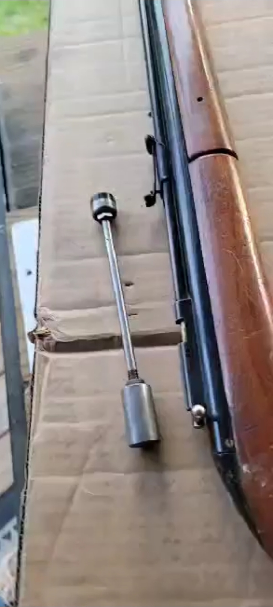

The first one was 1955 in non working condition, with 15.00 shipping. I changed it from nonfunctioning to functioning in less than 45 minutes. I had a rebuilt plunger laying on the table, and that was the 55's fix. Screenshot_20230713_125713_Gallery.jpg

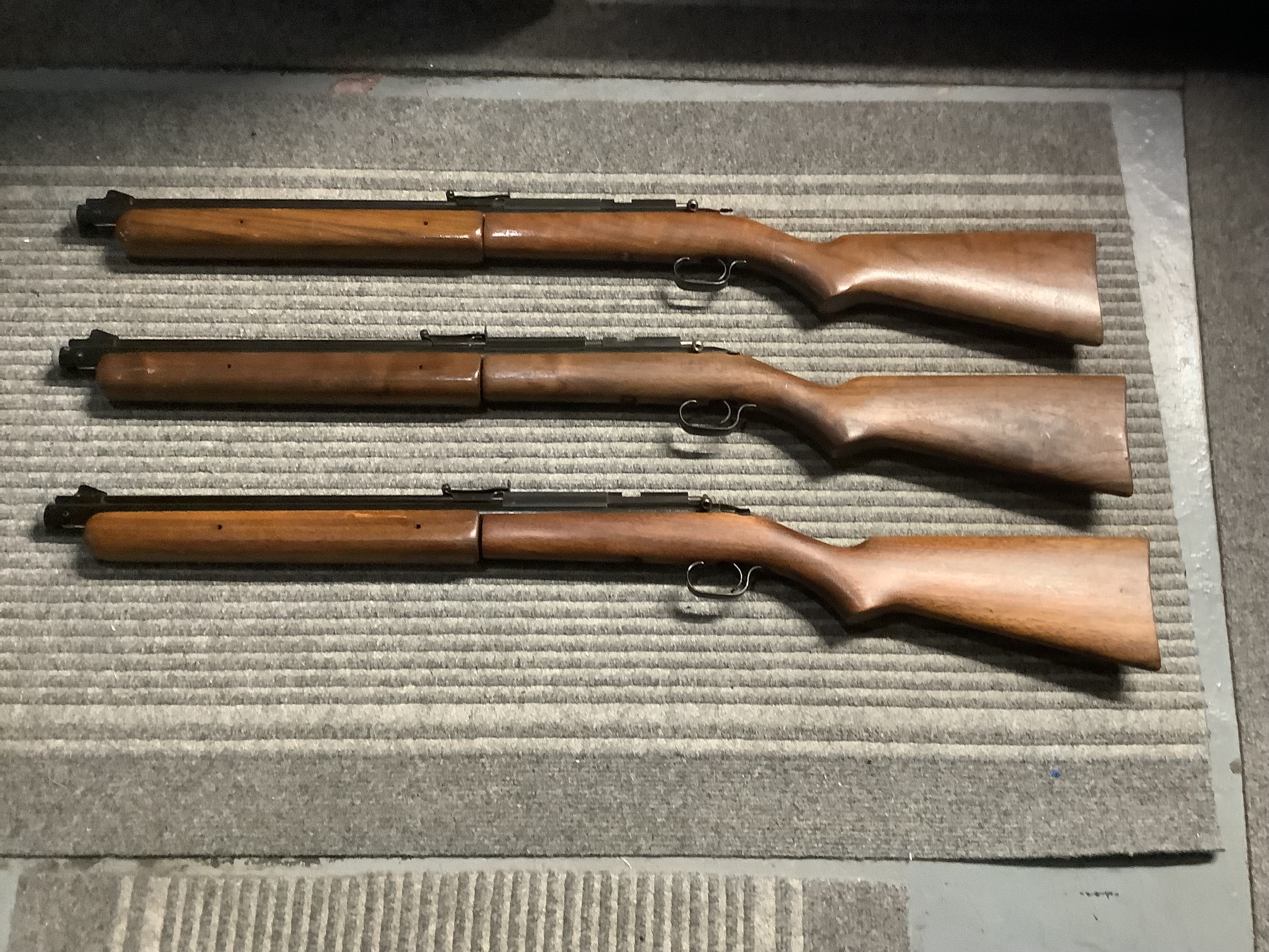

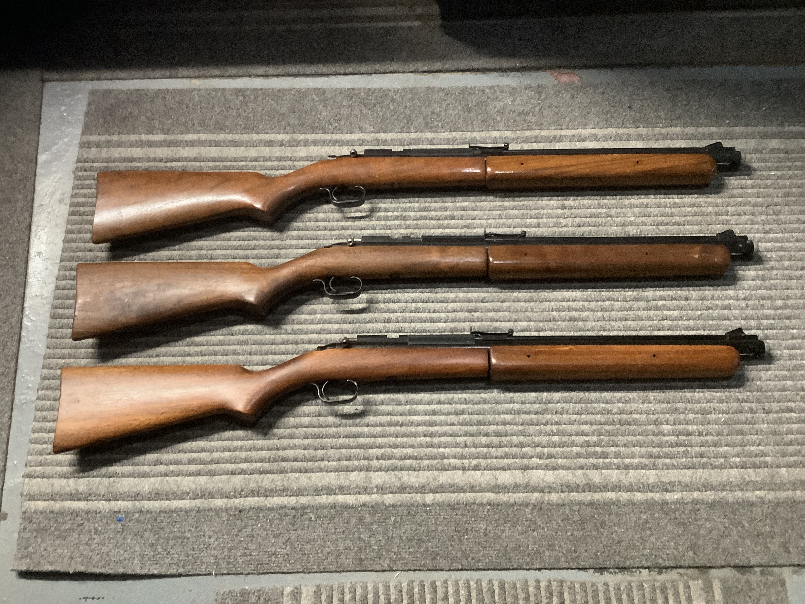

1955 all original Bluestreak from Oklahoma City Pawn.
1965 all original Bluestreak from American Pawn and Gun. North Carolina.

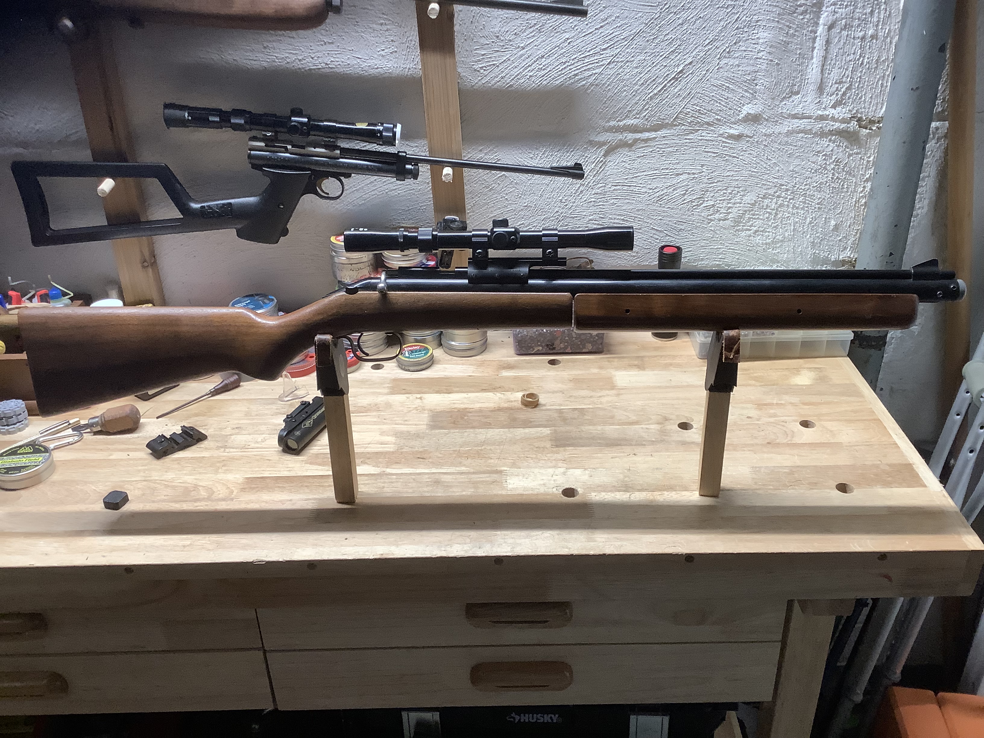

My original 1971 "worn off" Bluestreak, with a pre 65 sight, replacment, and "Steroid Tune" from Mac1.
A Beeman trigger shoe, and Williams peeps purchased from the eighties Beeman corp.
Refinished in the seventies with TruOil.

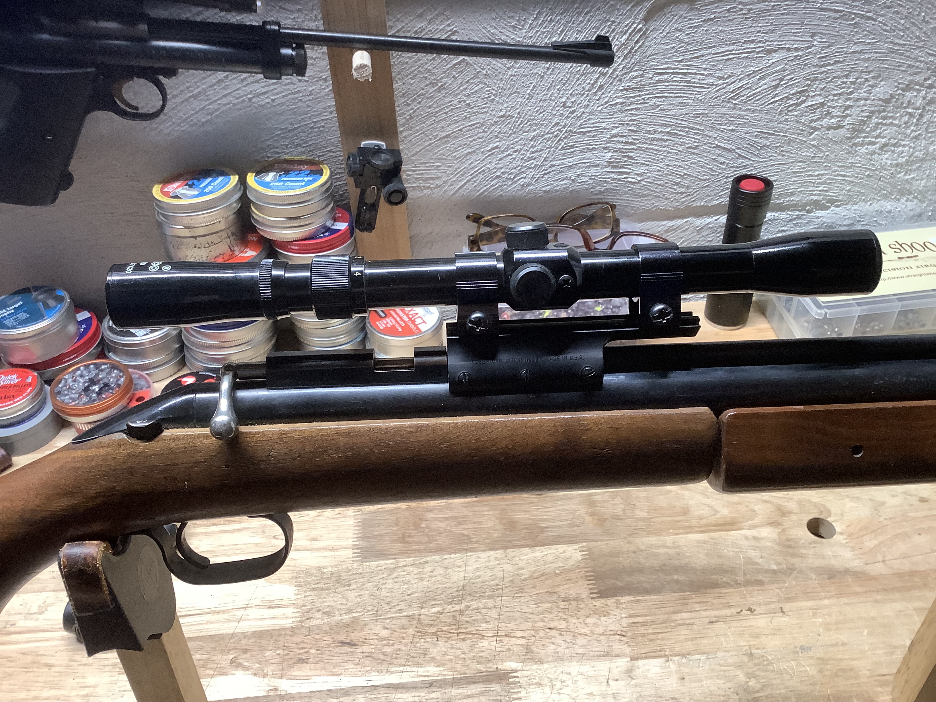

My 1971 Silverstreak "Dumpster Queen" project, purchased localy from Facebook Market Place. Rebuilt and refinished. Baker Airguns parts, Tru Oil finish. Waiting on solder up.
