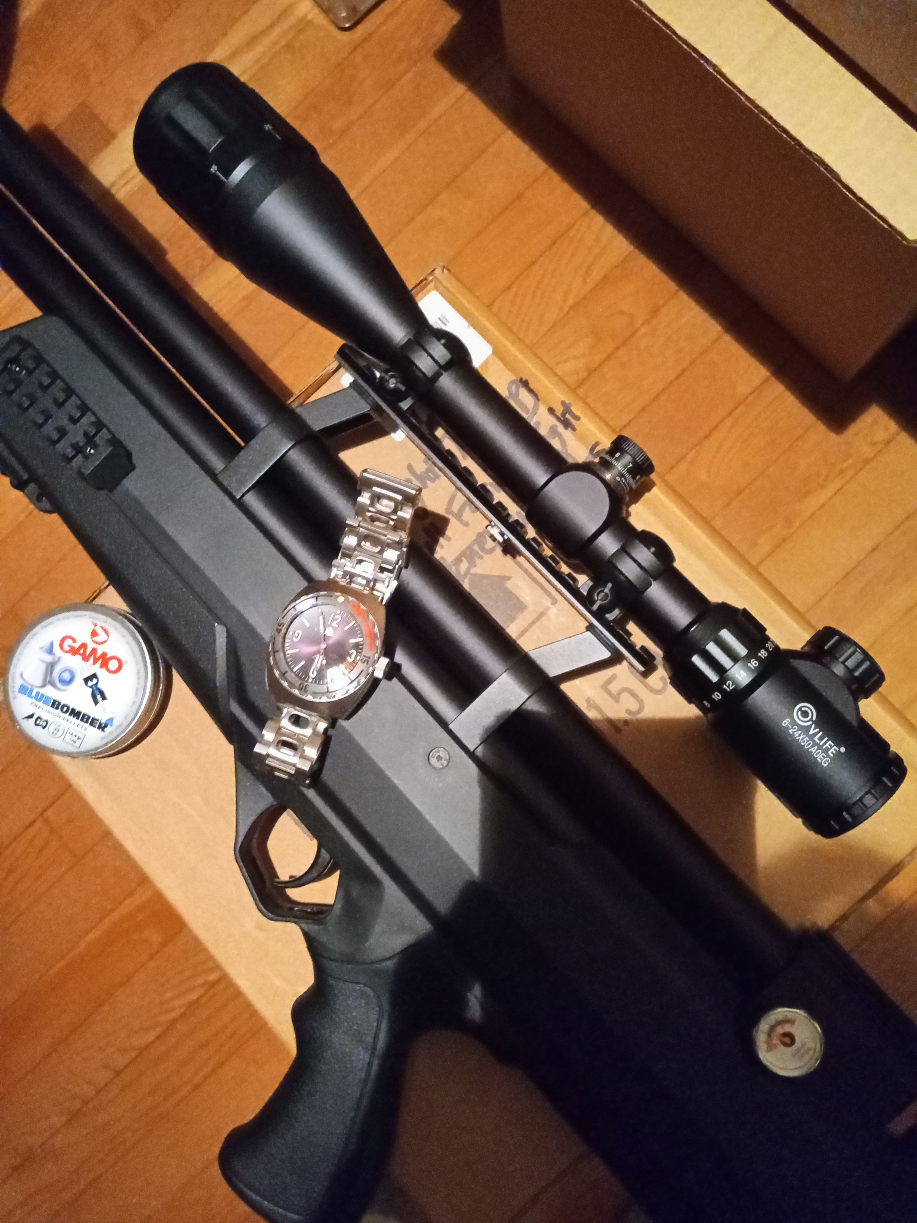

Did this mod last year on an Avenger Bullpup I design. The original rail was too long to mount the CV Life scope that I got on Amazon Vine so it cost me nothing. The key was to find a rail with the proper number of notches between the screw holes to match the Avenger mounts, which in this case is fifteen notches, also gotten on Amazon but for $8 although the price has gone up the past year.
LINK: https://www.amazon.com/dp/B0D1SK76NX?
The new Bullpup II design has lower mounts but still the same rail length, so this mod may still apply if you want to use low scope rings as I did, not sure how low the new mounts go.
The watch is the Buyalov Design 1967 gotten from Meranom for about $350 a few years ago.
