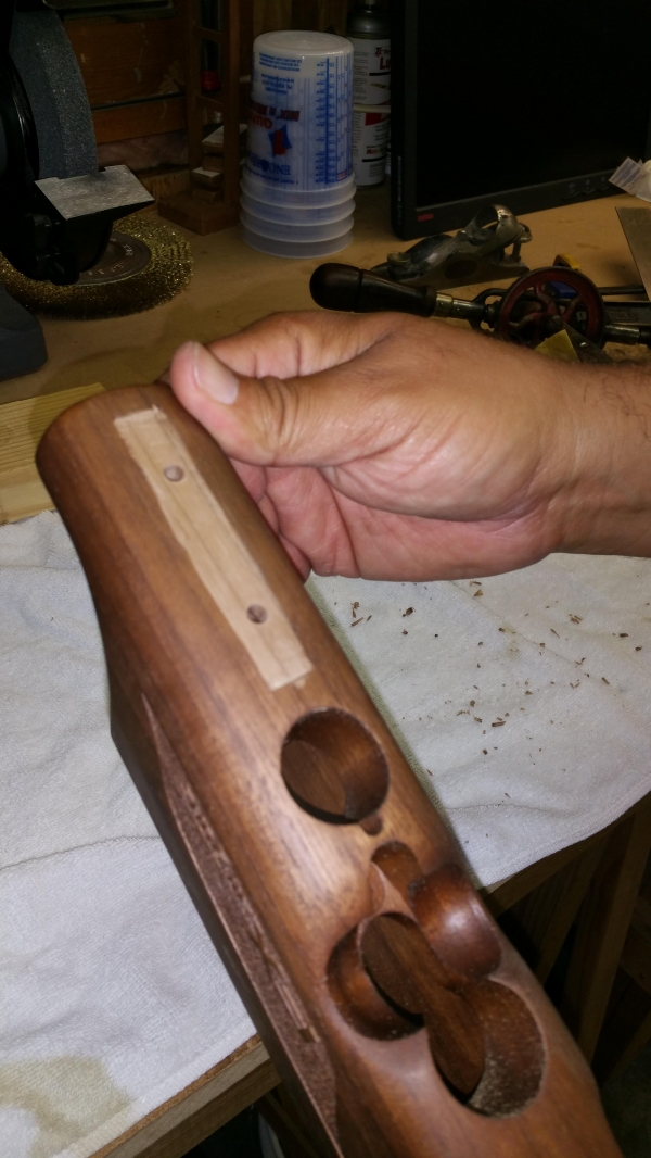

Monkyshine Member Oct 3, 2015 871 159 NORTH CAROLINA, United States Aug 10, 2017 Add bookmark #23 Aug 10, 2017 Add bookmark #23 Little wood chisel work triggerfinger. Upvote 0

A AlexFG Member Apr 24, 2021 1 0 Laguna, Philippines Apr 24, 2021 Add bookmark #26 Apr 24, 2021 Add bookmark #26 Has anybody installed picatinny rail on fx crown synthetic stock? Upvote 0
Monkyshine Member Oct 3, 2015 871 159 NORTH CAROLINA, United States Apr 24, 2021 Add bookmark #27 Apr 24, 2021 Add bookmark #27 Easy stuff, drill it counter sink back side and use T-nuts and quality machine screws. Upvote 0
