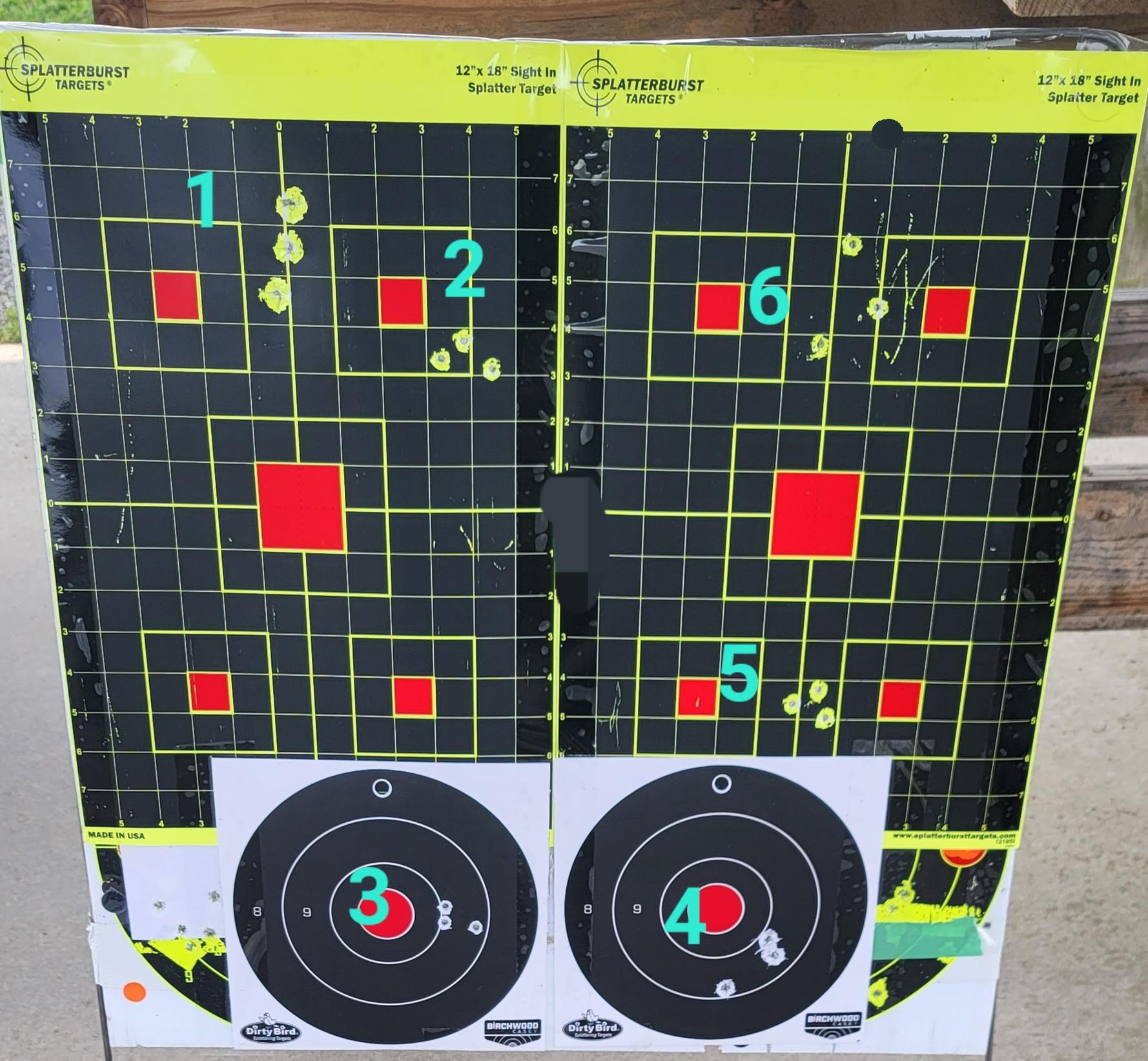

I have been shooting over 90% slugs for the last few years out of my FX Maverick VP .30cal, so here is my take:
  • No slug that I shoot matches the accuracy of a JSB Exact 50gr. The FX Hybrid Slugs are second and the H&N Slugs II are a close 3rd.
  • Every slug that I shoot beats the JSB Exacts in the wind past 30 yards.
  • Every slug that I shoot delivers around 30-35% more foot pounds of energy at 100 yards.
If you need to hunt or pest with game at distance, slugs have an advantage of putting energy on target at distance and fighting the wind. Groups don't beat Diablo pellets in accuracy, but if you can stand 1.5 MOA with a slug, you may find it as an adequate solution.
In the above 100 yard photo, here is the ammo used for each group:
Okay here is goes!
1: JSB Hades
2: JSB Knockouts
3: FX Hybrid Slugs
4: JSB Exact
5: FX Hybrid Slugs
6: JSB Knockouts
