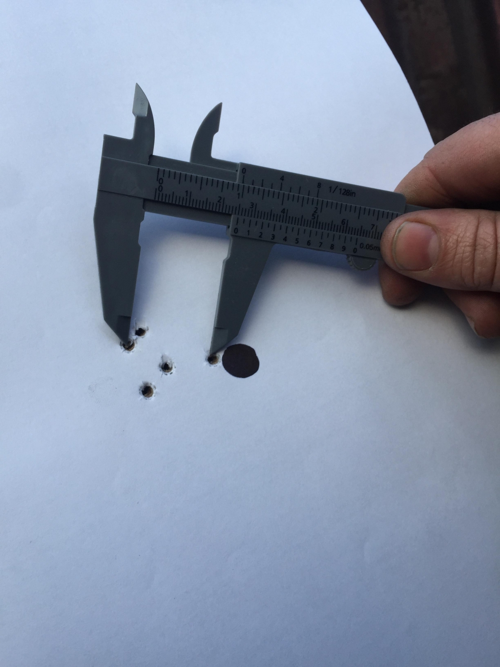

In recently discovered nsa offers a 17.5 gr slug in 22 with a .216 diameter. I shoot them from a stock barrel kral puncher bullpup that is modified to shoot them at roughly 900 fps. They super accurate, more so then the 18.1 gr jsb. Half inch at 50 yards or less, and just over an inch at 100 yards. So far they hit much harder than the jsb with less pass through.

Here's one I recovered out of a squirrel, nsa 17.5 @ 900fps out of my Kral
