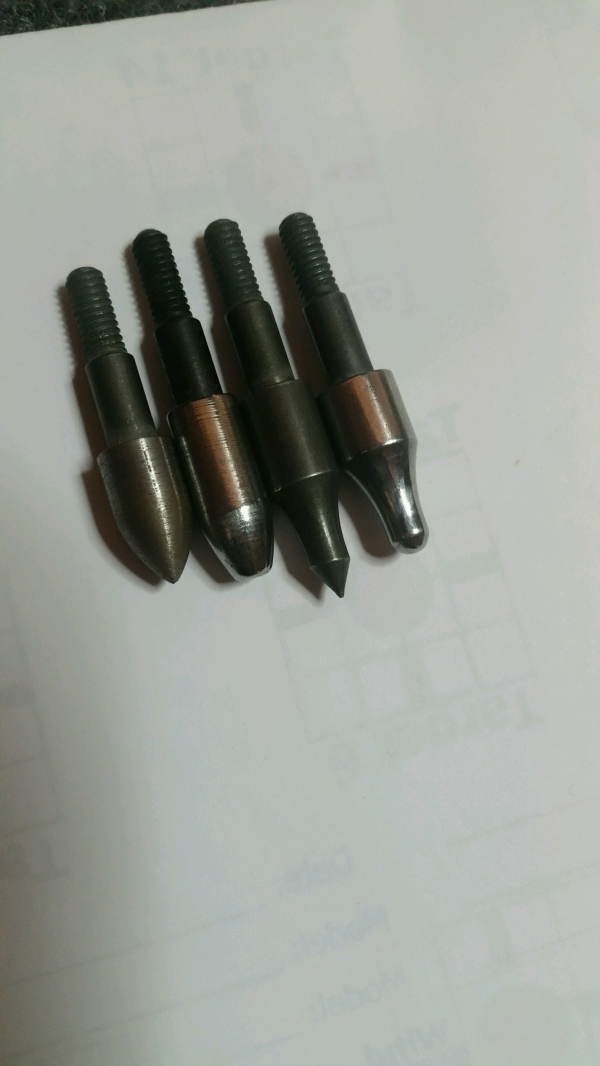

Yes that seems to be the norm nowadays. Lots of times the blast of air from the shot straightens the skirt enough. If I have a tin with a lot I usually go thru it and use a field point from my archery box that I have ground down the tip on. I just place it into the skirt end and rotate with a little pressure.
I made one for .177 and .22. All I did was chuck the point in my drill press and use a file to get the point round. I then used sand paper and a polishing wheel to get it super smooth.
Here is a pic of the ones I made along side of the style tip I made each from.
You ever think of packaging/selling? Or do they already exist?
Never thought to try and sell. I just do stuff for myself to save $$ and make things work better. I'm certain if you go into Home Depot, Lowes or your local hardware store you could probably fine something to work pretty cheaply. Take the pellet with you. There are lots of parts with rounded ends in those drawers in the hardware isle. Thing made for shelves, for furniture and such.
You could probably use the end of a #8 or #10 brass round head bolt.
Good ideas. I started to think of old, busted drill bits that I seem to hold onto.
