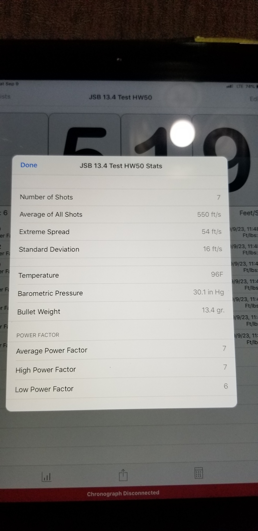

Thought this was interesting. Kim’s HW50S started shotgunning a little last weekend so I ran over chrono today to see what we could see. Turns out she had switched back to the JSB 13.43 from the H&N FTT I told her were better in her gun. The JSB were easier for her to load. So:

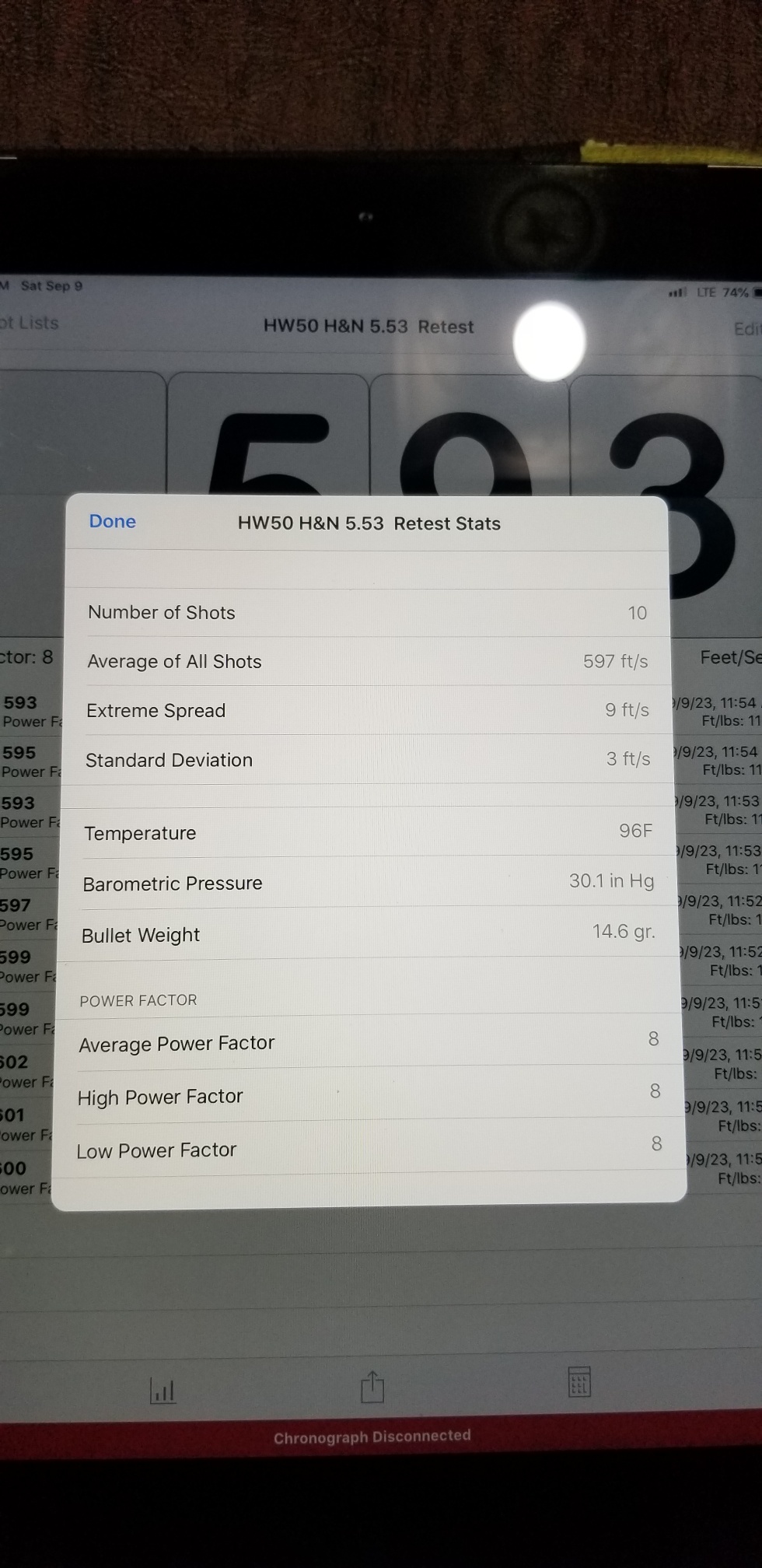

Thought we had a toasted seal when I looked at those numbers and I was going to have to tear down. Shot the H&N just to be sure:
That’s why I switched to H&N awhile back. The JSB numbers were never as bad as above but I think the high temps exacerbated the issues with those pellets in her gun. For whatever reason her 50 hates the JSBs. Also tightened up her front sight that was wiggling. Stood out at 20 yards, shot and reset Cooper the Squirrel, cut a chalk target in half and then that piece in half again. Took all the JSBs out of the bag for that gun. Problem solved ha ha ha. This is a little extreme but sure points out how some pellets just don’t work in some guns. And what a useful tool a chronograph is.
