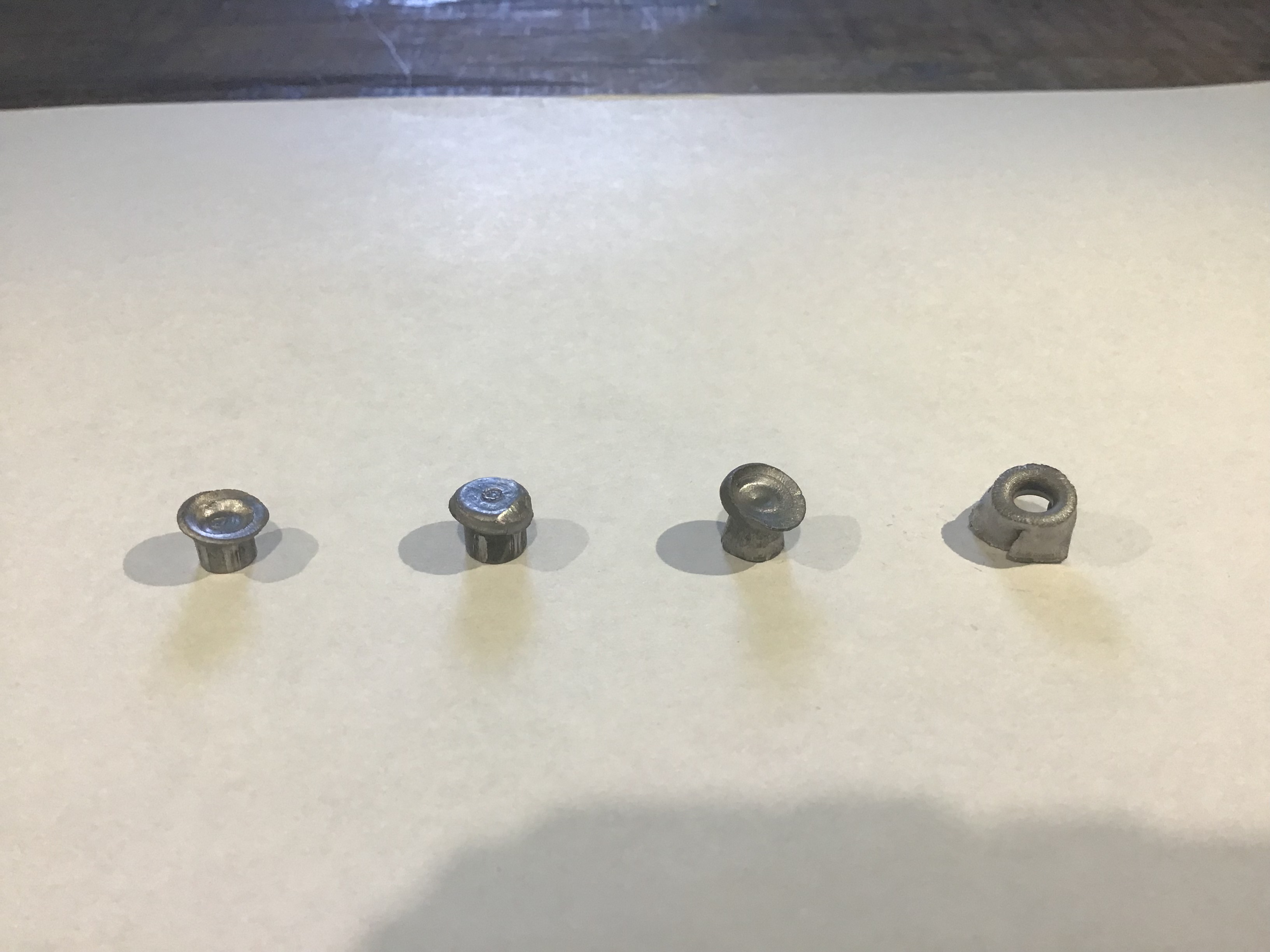

The H&n barracuda hunter pellets perform very well for me and group nearly as well as domed pellets. Attached you will find a photo of how they expand when fired into water. The projectiles on the left are nsa slugs. The two on the right are barracuda hunters. The last one was fired supersonic.
If you are hunting you will find the hollow points have much better knock down Power.
slugs are great if you intend to shoot much over 80 yards or thereabouts. That is if you can get them to shoot accurately.
