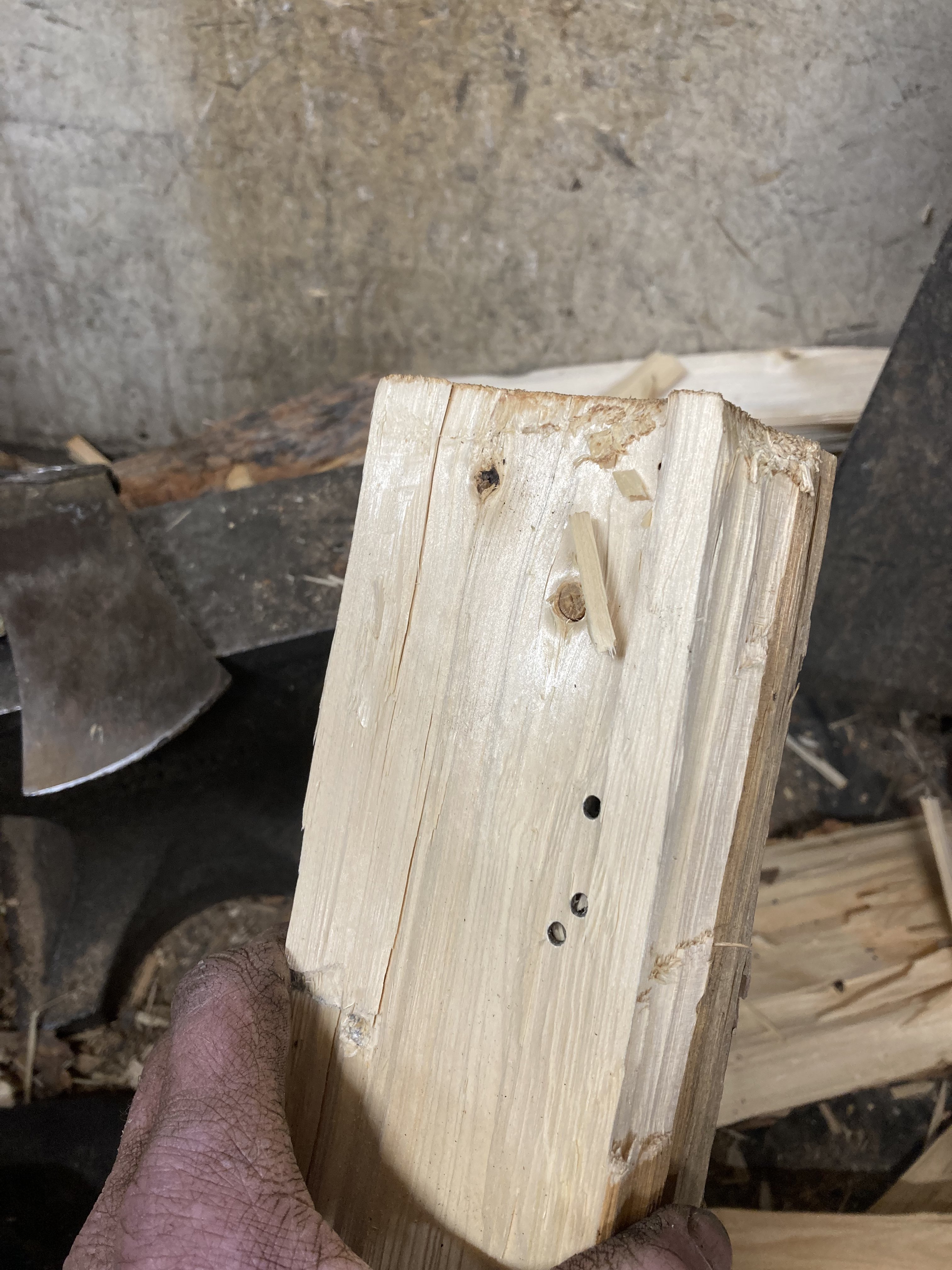

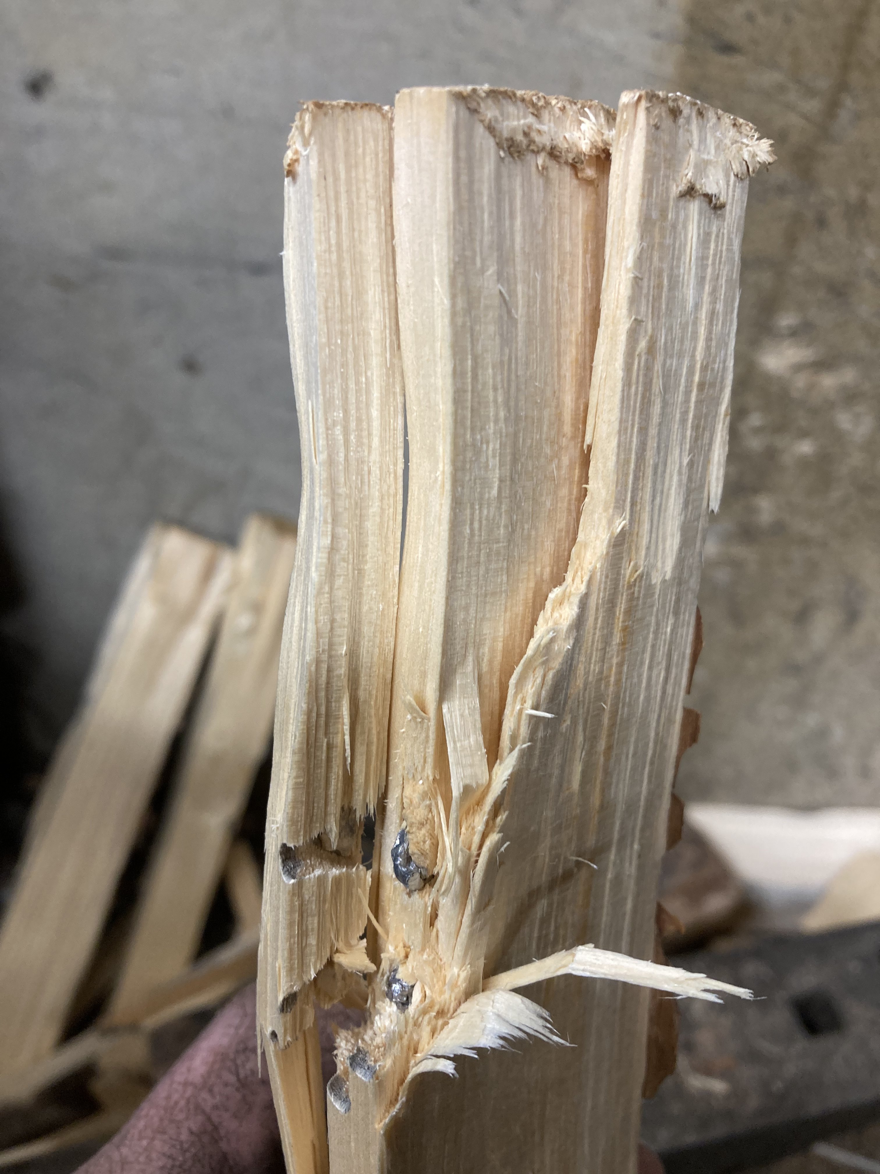

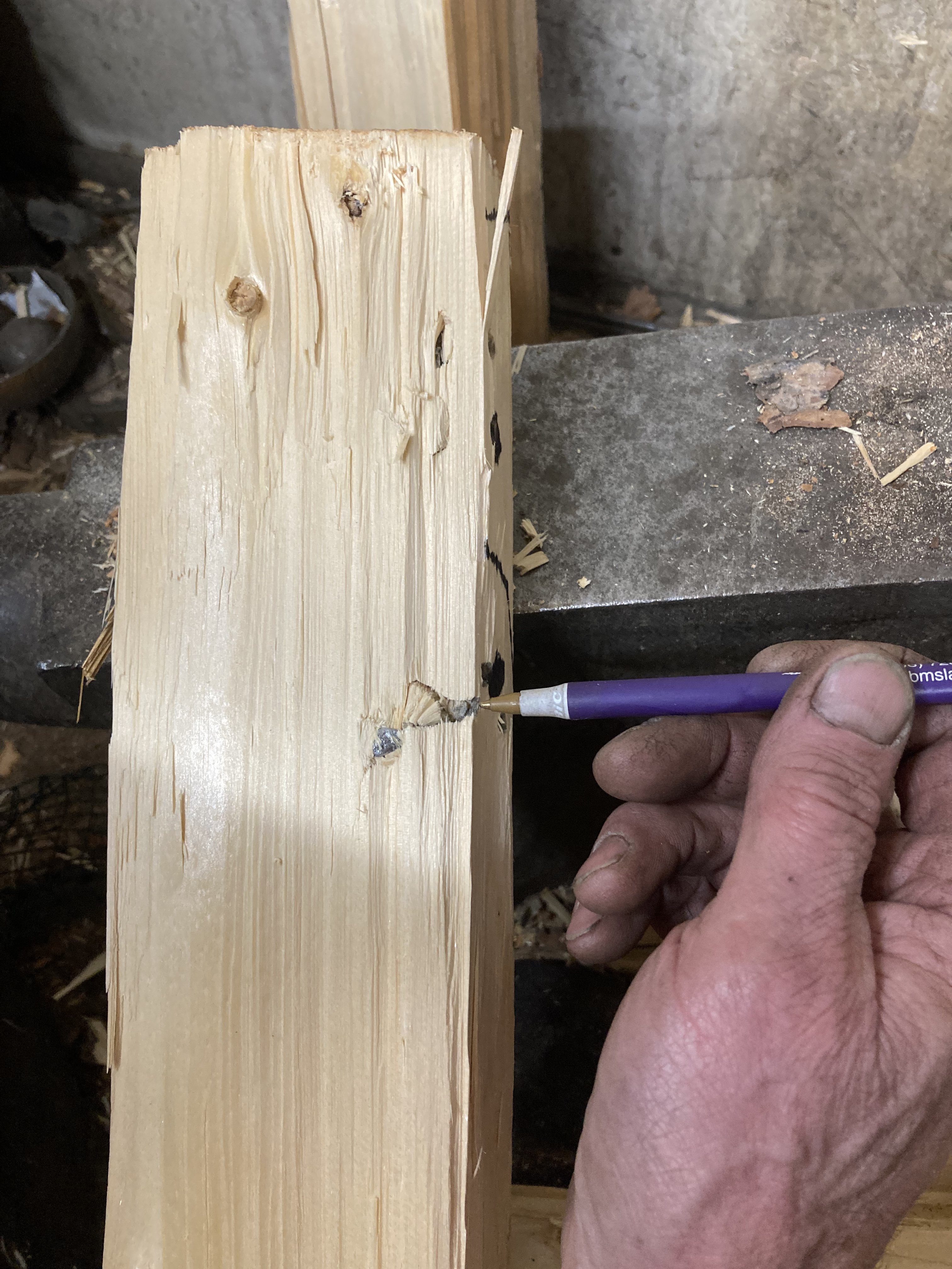

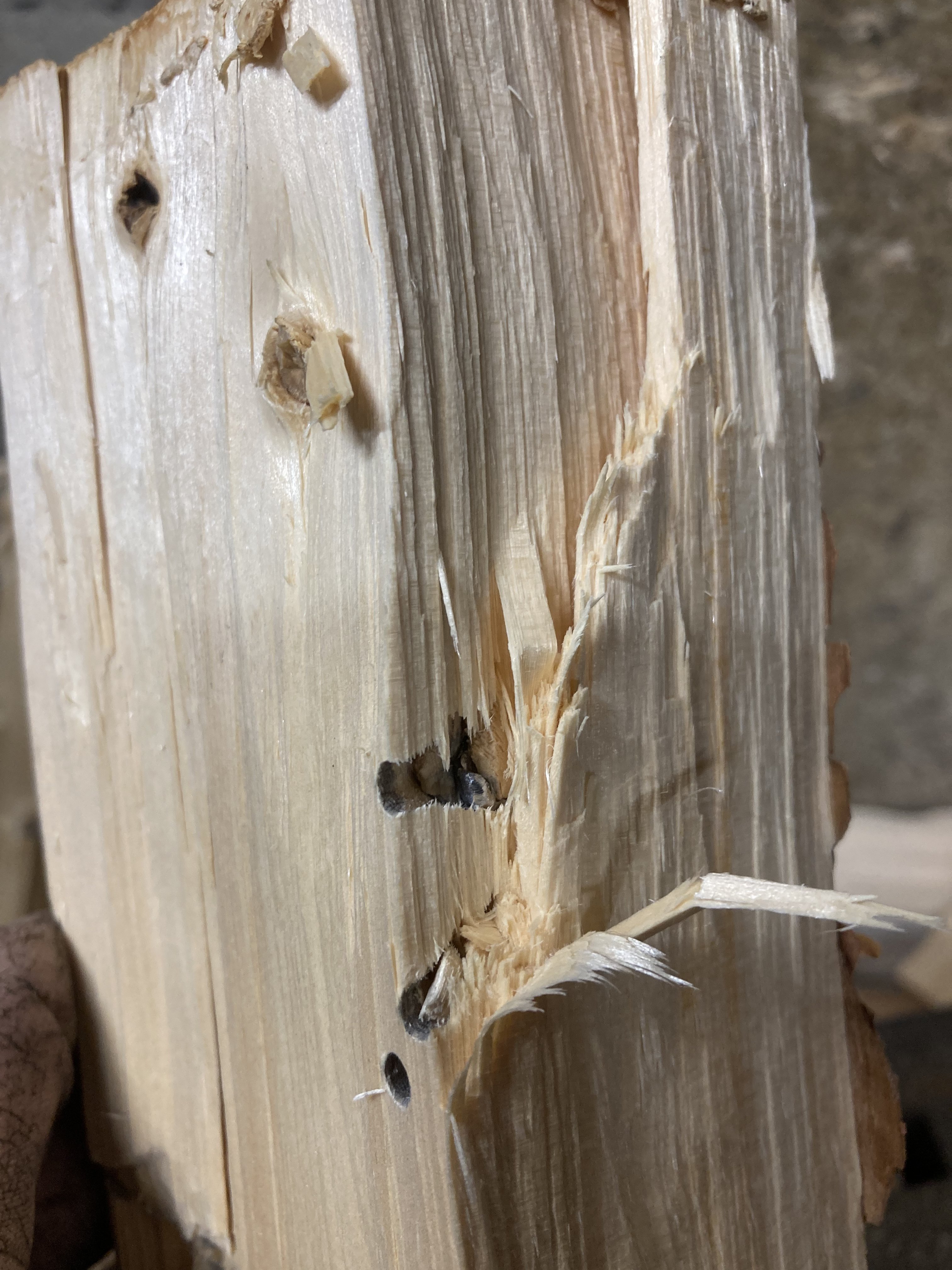

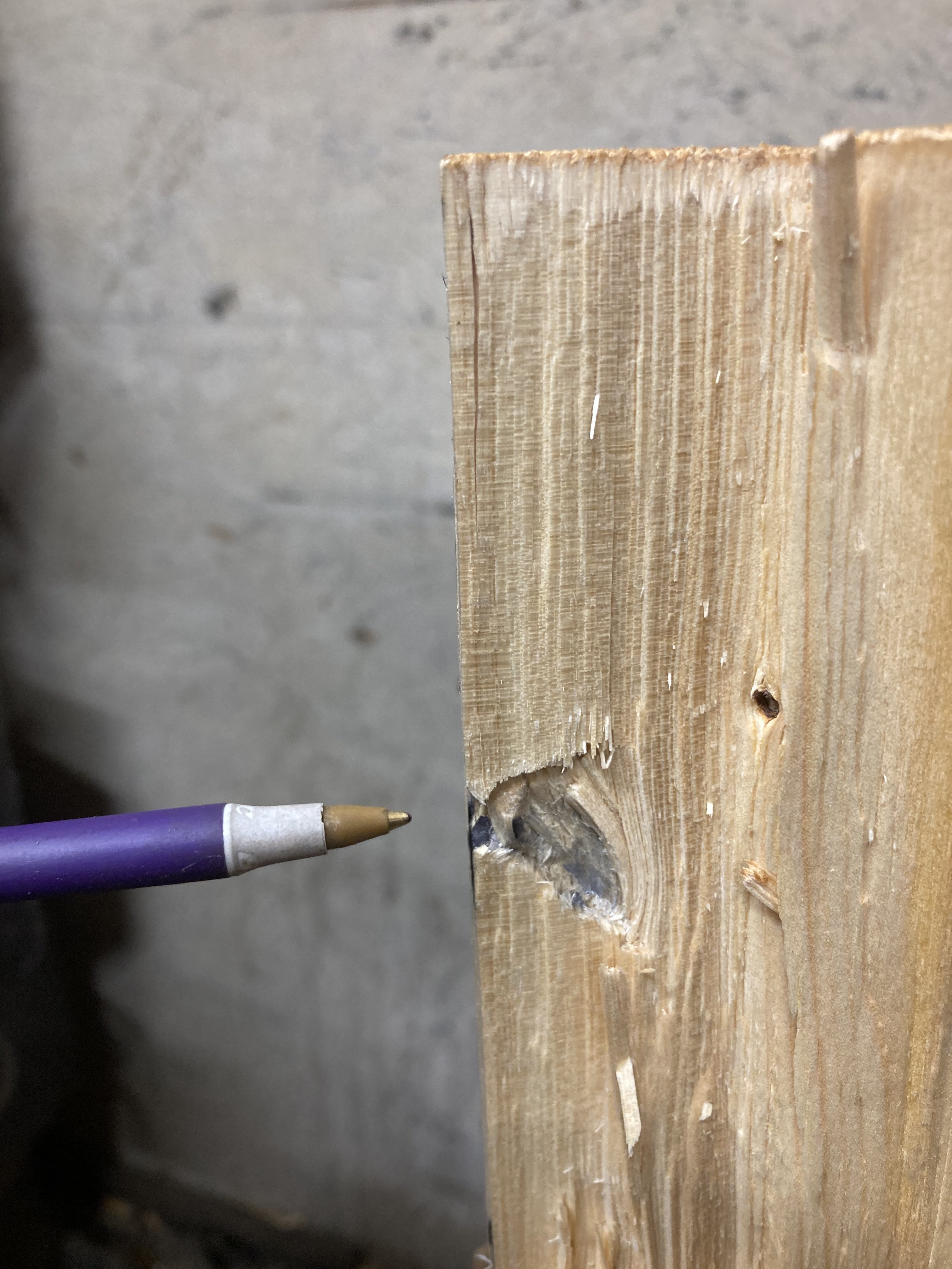

Well I did the penetration test on dense lodgepole pine. It’s only good for seeing how far the projectile gets into a hard dense material.
The RedWolf .22 HP and 25.39 grain knockout slug is the picture with my hand.
The other one is the .30 JSB 44.75 pellet.
I’m a hand model as a side job by the way.
I just finished a different test using BulletFreaks suggestion.
Wet paper, the results surprised me very much.

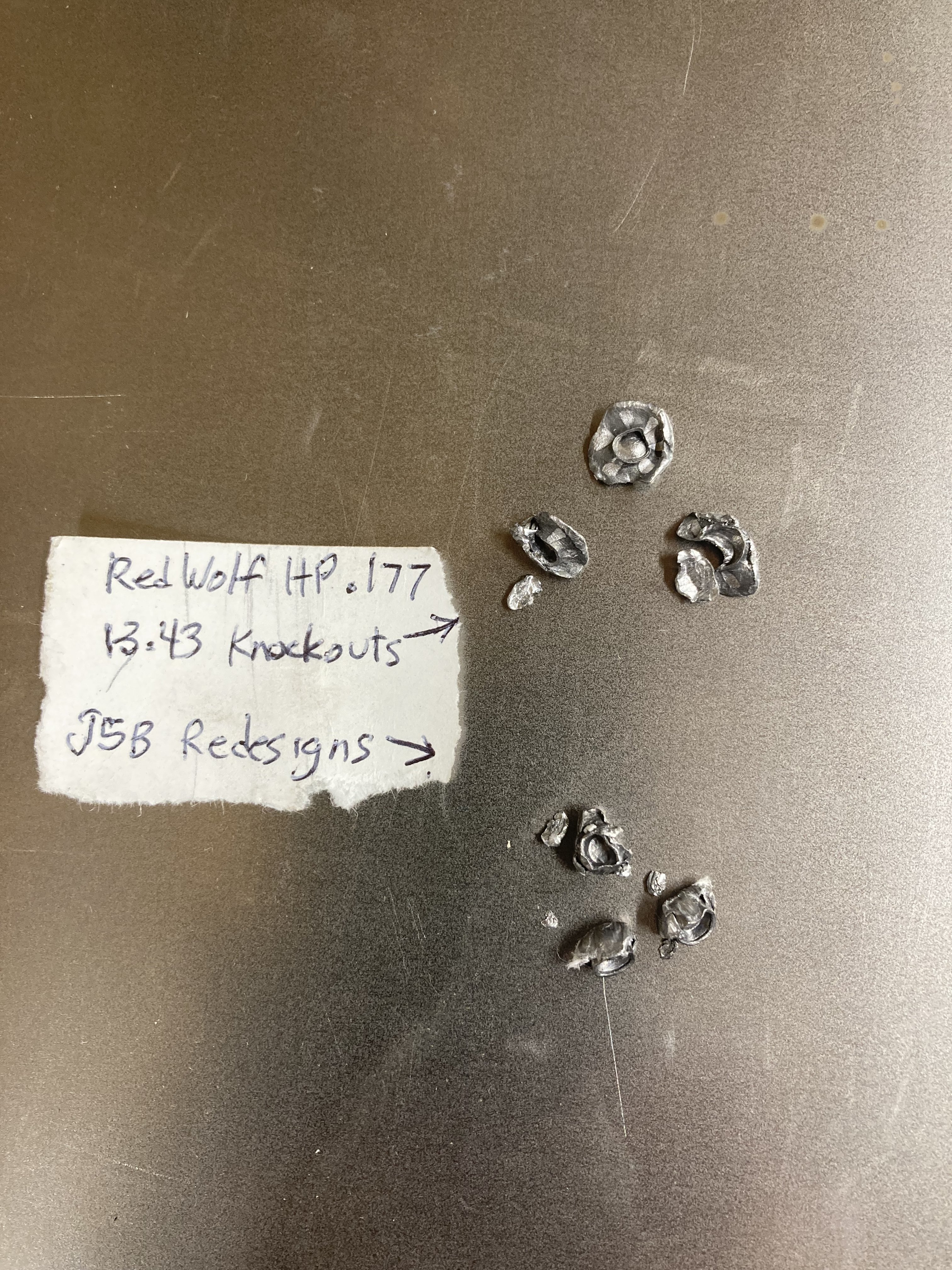

I’ll post it next but first I want to shoot the .177 RedWolf HP with knockout slugs into the hard pine so we have that comparison too.
All the testing done at 18 yards.
Edit: I just added the pictures of the .177 RedWolf and knockout slugs

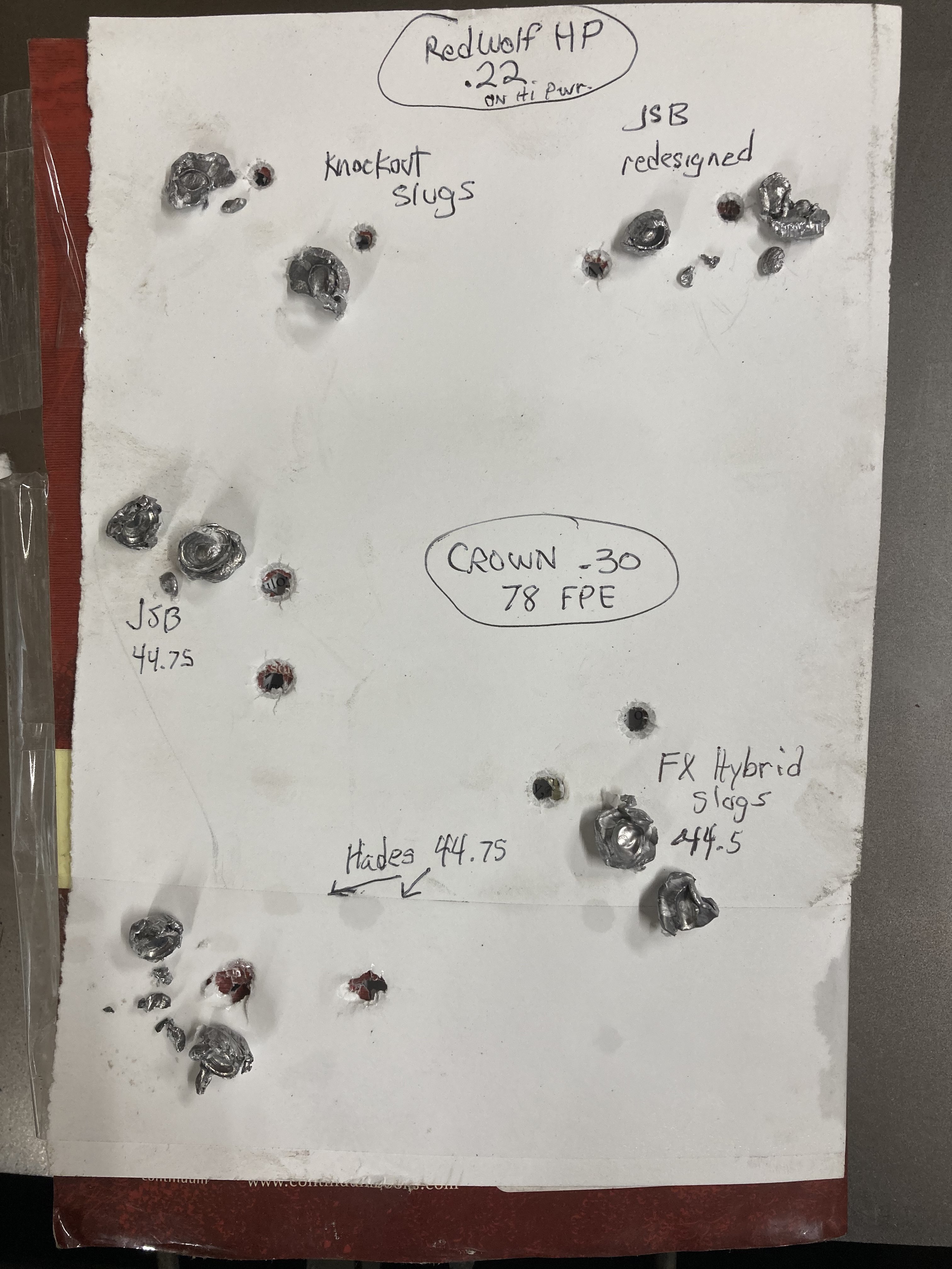

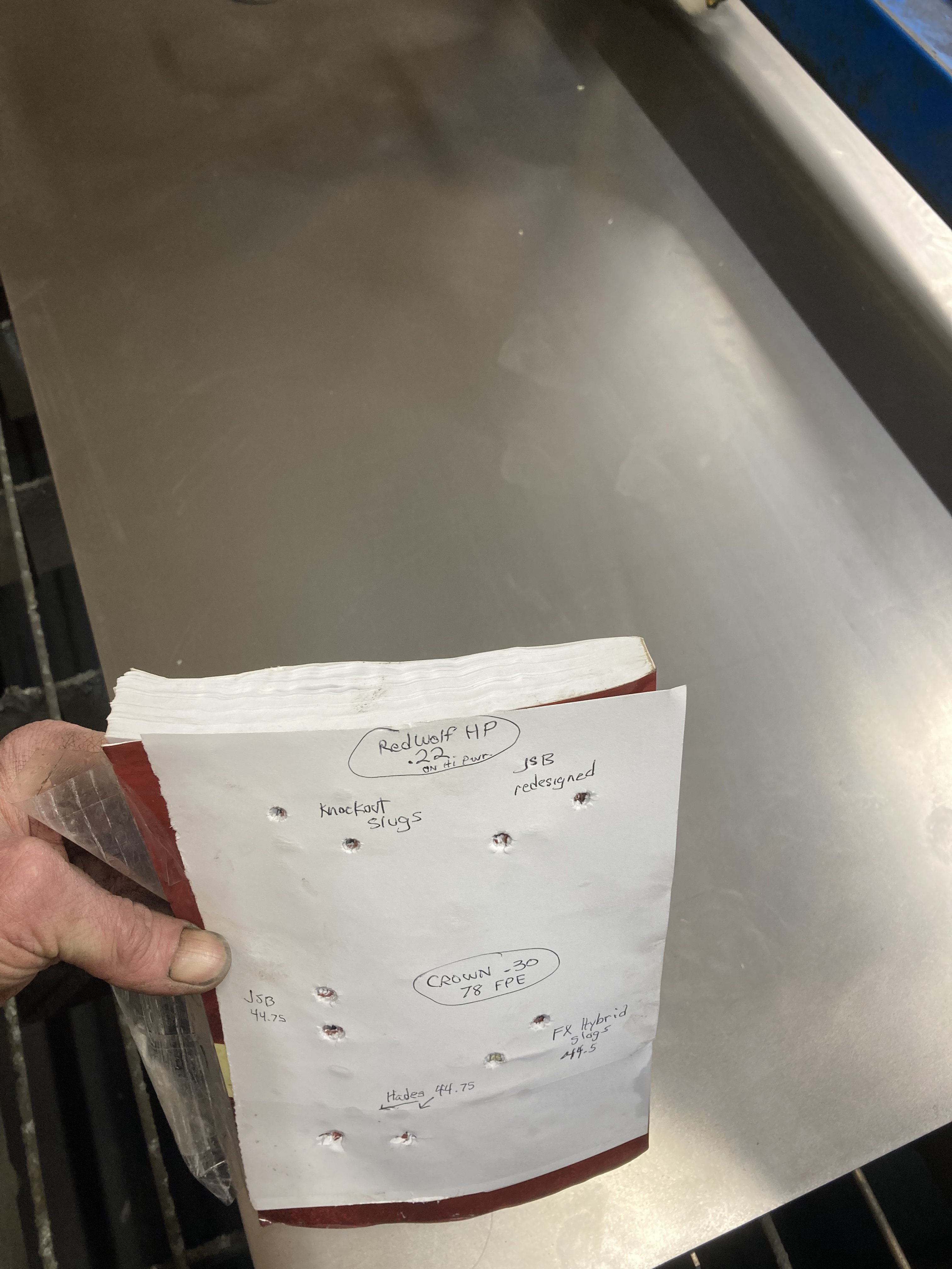

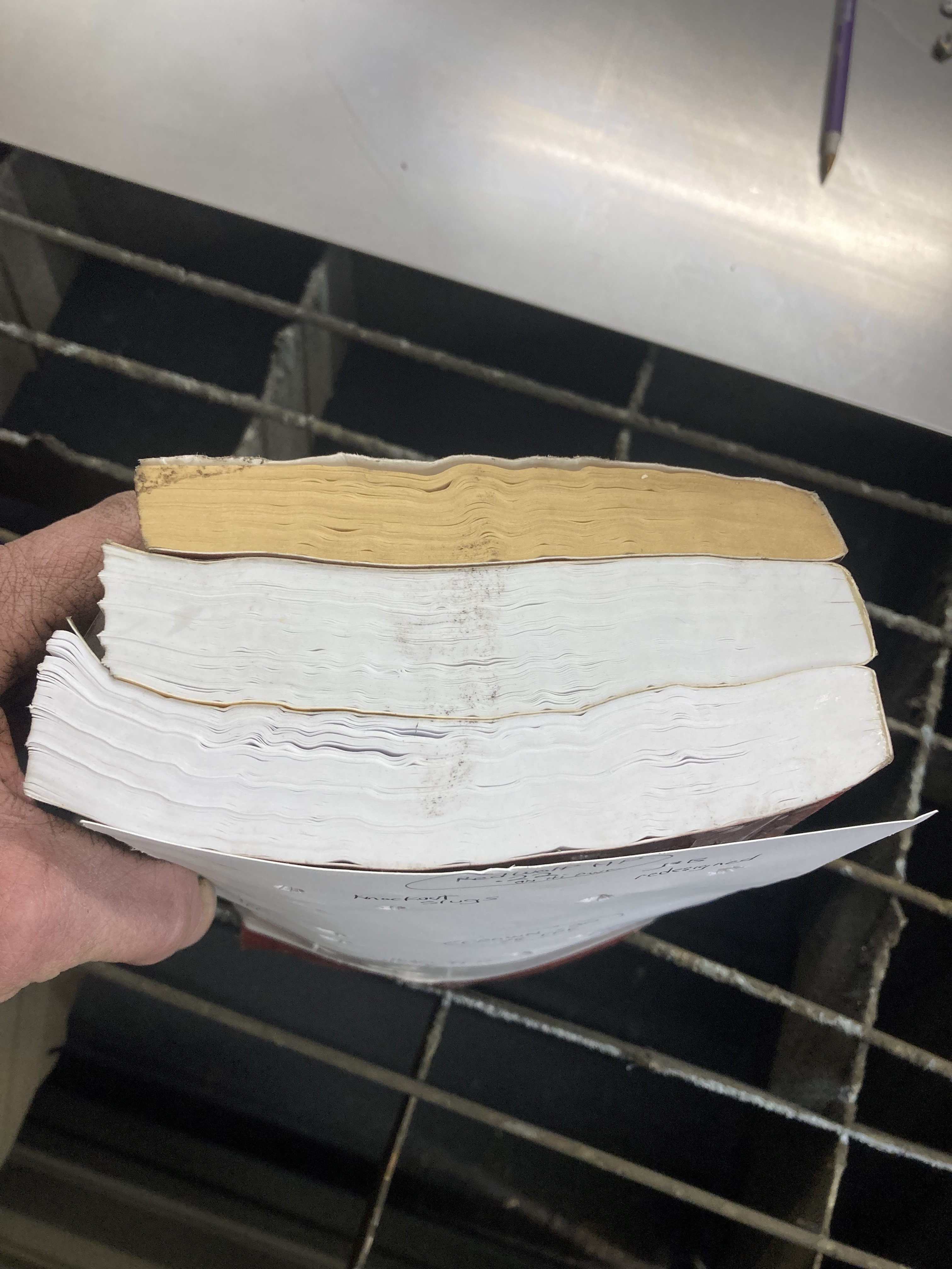

Here’s the test done with wet paper. I had a few old paper backs that I taped together and then soaked them.
What was very surprising to me was that nothing got through the first book!
So everything dumped all its energy into one inch of paper.
The .30 was the deepest penetration in the book, but not by much at all.
The .177 RedWolf with the knockout slugs was very impressive.
It went as deep as everything except the .30 and look at the mushrooming of the slugs.
Test done at 18 yards.

From these pics for p3sting; I'd choose the Hades or redesigns 🤷‍♂️ I like how they fragmented
Thanks for posting hour results davelarson. I've shot wood several times but I don't get much penetration and even within a board there are differences in the density. So I prefer mdf and my test block with 1/4 inch pieces makes it easy to get some feel for the depth of penetration.
When I test in wet paper I tie the bundle loosely so the water fully penetrates. You did not seem to get a lot of penetration but you got a lot of expansion so maybe that explains it. If the paper is not saturated the penetration will be less, however. But as long as all the projectiles hit the same block it still gives you relative performance.
