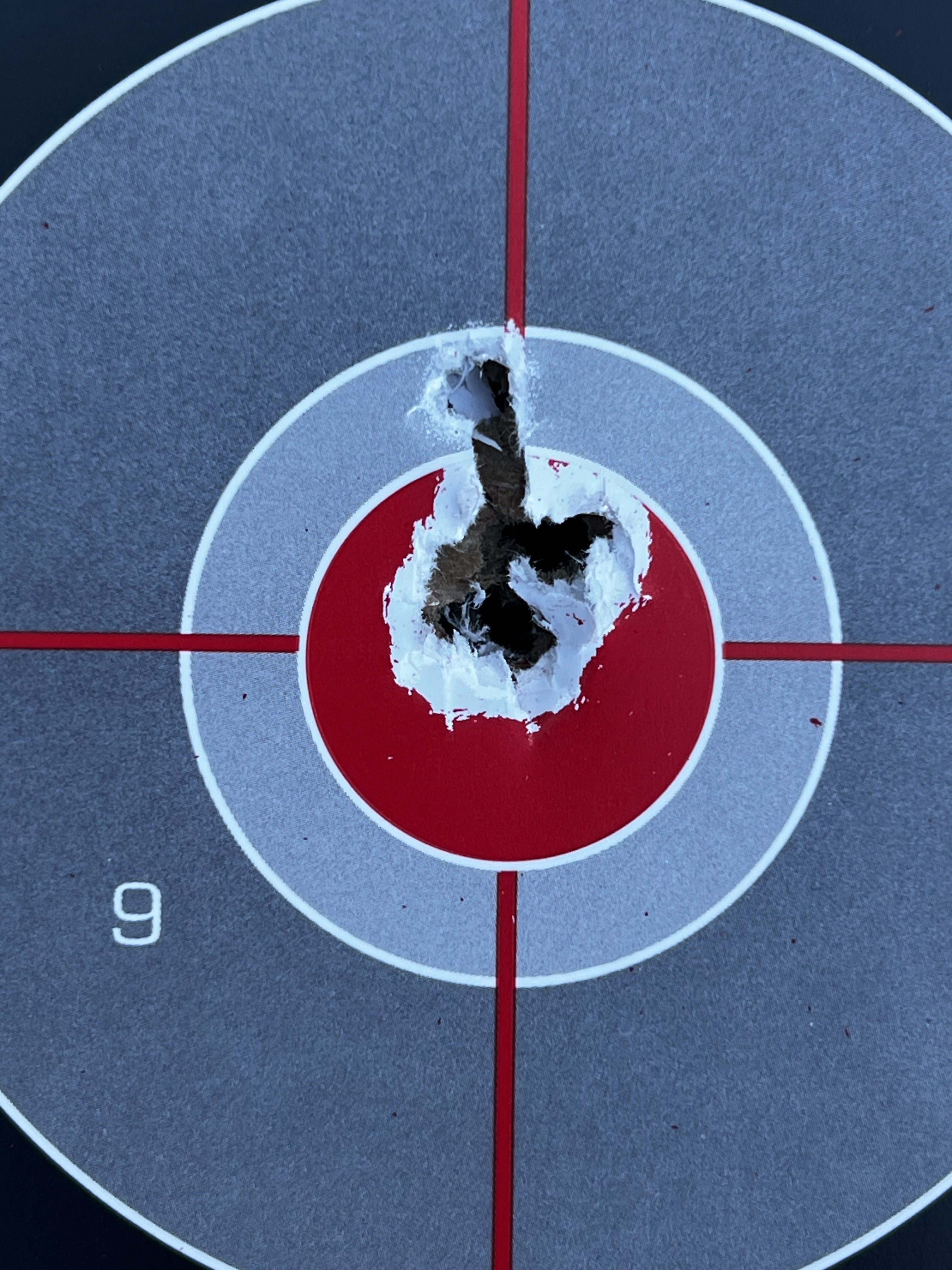

Lead fouling starts above 950 fps. Consider lubing your pellets.If that's the case, I guess I'm running a little hot. I don't think I will change anything though. For me, that's a damn good group for a gun with a 5lb trigger!
