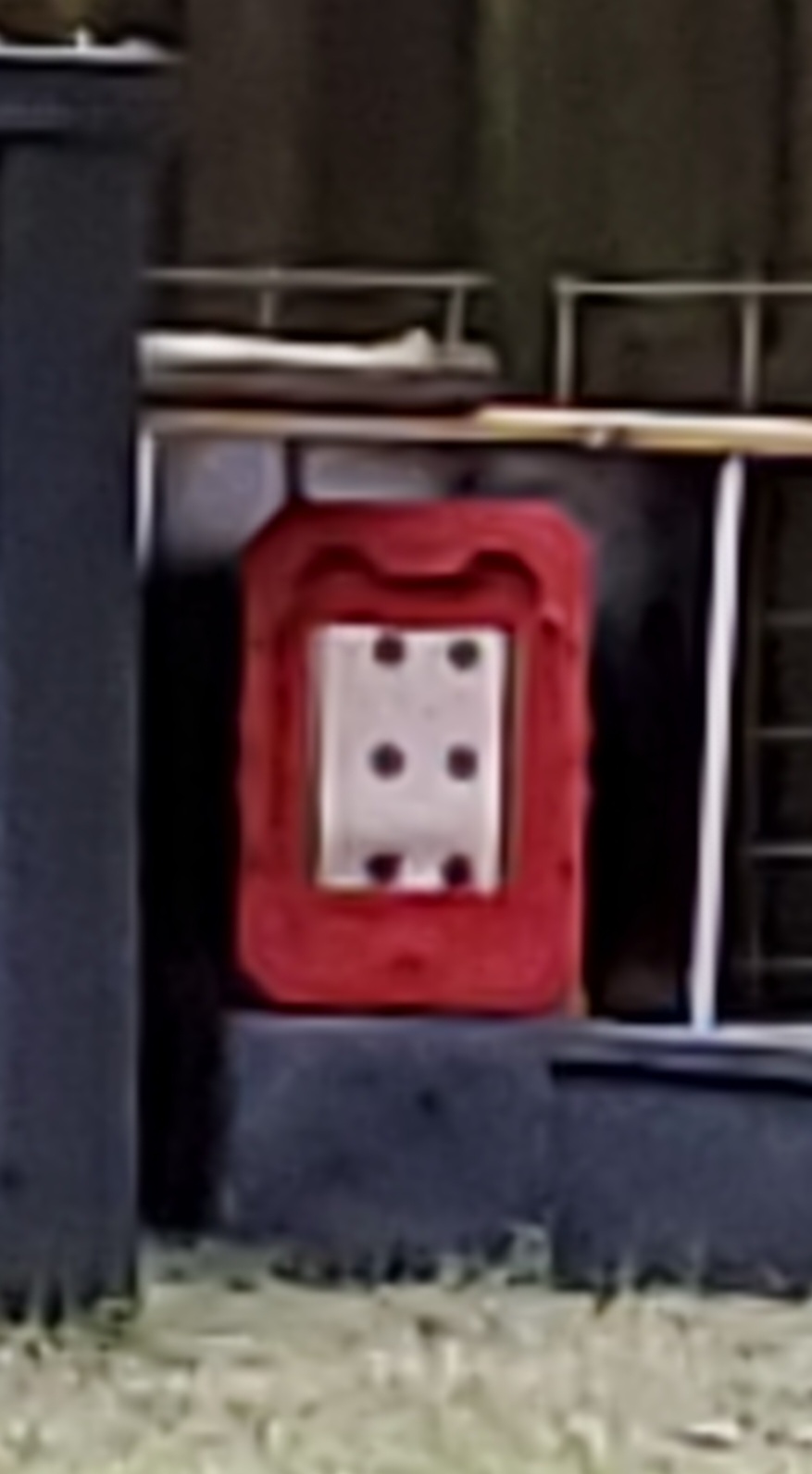

Next method to try is this gem I found on I93 off ramp. It is very hard plastic tractor trailer mud guard20240114_154938.jpg20240114_155529.jpg20240129_201026.jpg20240217_170743.jpg20240114_154523.jpg20240114_154533.jpg, need to test it first before the box design.20240114_154634.jpg

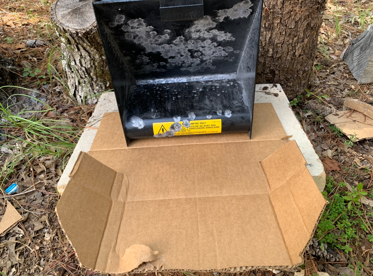

This is what I built. For about $19-20, it is hands-down the best trap I have ever had. Will stop a .22LR as well as a .30 PCP. Heck, might even stop a 9mm, but have never tried it.
