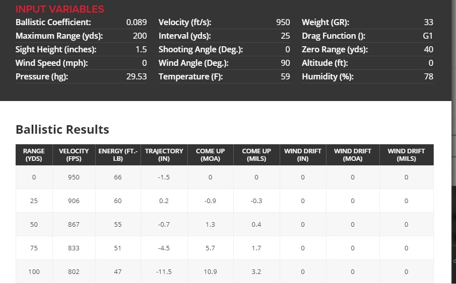

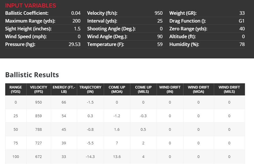

Kinda of like computers when they first came out. Adding ram video cards etc. Trying to make them faster. Next purchase will more than likely be 30 cal to press the limits a little more. Question, can you push 33 gr pellets/slugs out to 100 yd at 820-830 Fps?
What cal? You mean hitting @ 100 yards at 820 - 830 fps? Pellet no, slug almost
Just changing the BC
Slug
Pellet
playing with numbers here: https://www.hornady.com/team-hornady/ballistic-calculators/#!/standard
If you mean if you can push at starting speed of 820 fps up to 100 yards...of course you can.
