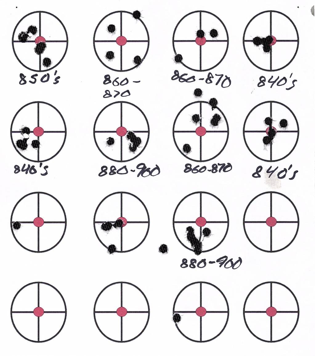

Today, I tried some NOE cast .30 cal pellets at various speeds with the FX STX liner all sized to .299". I am happy many are touching. I was shooting in some gusty winds around 6-8 MPH, but the distance was close at 30 yards
From what the results look like to me, considering the harmonics compared to speeds, the 840’s and the high 800’s are the two best speeds for harmonics. It seems the groups want to open more in between those speeds.
