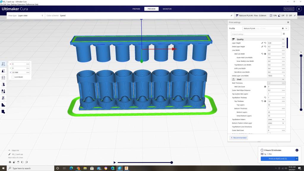

I had mentioned that i was working on a skirt repair/expander. I wanted to give an update, and ask if this idea looks feasible, or am i going to damage something.
Pellets go in the side window, and get pressed against the flair on the bottom. The ID of the mold is .05mm larger than the mag that i have, (to ensure a tight fit). I'm working on a clamp like structure to provide mechanical advantage, to treat 7 pellets at a time, and a distortion free removal aid. I'm modeling this after the JSB 18 heavy, and would need to change a few dimensions for different calibers and models. Ultimately, i want the trays hot swappable to different styles.
I'll release this as a free print on thingiverse if it works :)
So is this a good idea, or no? LOL

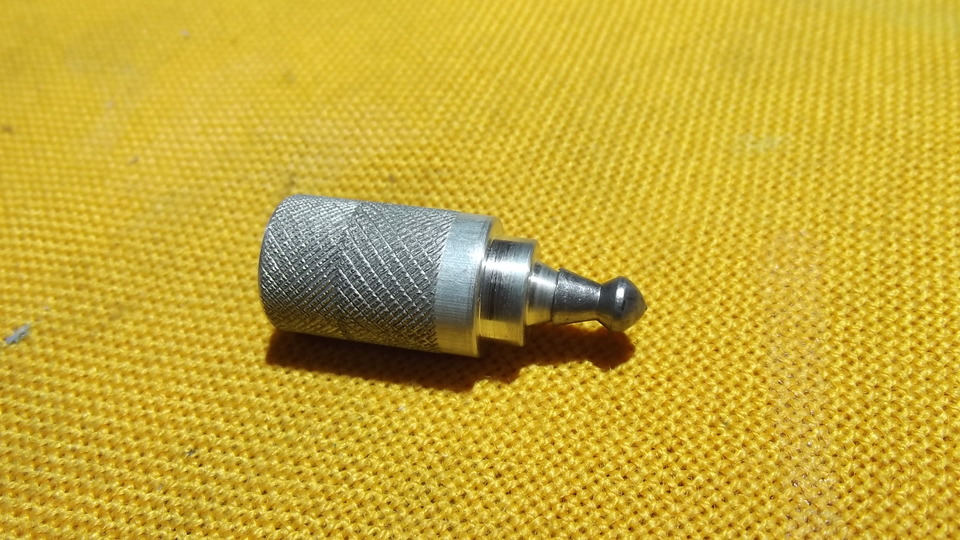

I have made them for my own use for quite a few years now. Matching the skirts I.D. taper manufacturer & pellet weight / type specific.
Primary is a straightener and truing for uniform loading. Light pressure and a few back-n-forth twists is all it takes. want more FLAIR ? push harder !
Accuracy of these tools is so precise that as last pick shows, pellet is stuck to the forming taper perfectly.
